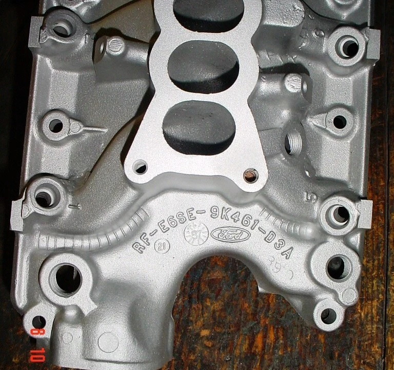

Tmoss lower intake arrived today but I won't be able to install until next weekend. I think I'm going to try and have a dyno pull a few weeks to a month after, hope I'm not disappointed. If the dyno shows 0-5 hp gain I'd feel jilted a little due to the money, effort, and car in pieces for weeks.
Charges:
  • Labor for porting HO lower intake you send us for E7/Gt40 heads - $160
  • Option: Solvent tank, R&R oil baffle(s) bead blast, coat with 500°F clear ceramic engine enamel - $25 (see attached picture)
  • Return insured shipping - $30 (add $5 for NY,NJ,MD, RI,FL,NV,ID,MT,WY,CO,AZ,NM add $10 for WA,OR,CA) or purchase a return shipping label from the carrier when you ship and place it in the box with the money order. USPS stamps are NOT acceptable as it has always cost me more to return ship than the amount of postage stamps sent. I did the prepaid shipping route and total paid was like $245 labor/shipping
here is a link to his site describing the work http://www.tmossporting.0catch.com/
