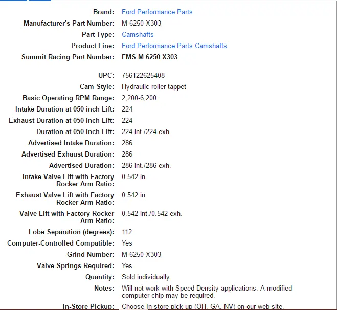

While I'm pulling this motor out and cleaning everything up I was wondering if I should be on the lookout for some gt heads. I believe my motor to be an 86 block with stock looking heads except they have dual springs witch makes sense with the install of the solid x cam. This is all second hand info from po who says he got his info from the guy who put the engine together. I'm thinking that if this guy went to this much trouble and work on this engine that he probably reworked these heads and I'm not sure of the benefit verses trouble and money to change the heads.

If you liked it before you'll like it when it goes back together. If you were going roller camshaft and aluminum heads I'd say go for it.
Firstly, an X cam is still a hydraulic roller cam.
While I guess you could put solid roller lifters on a hydraulic roller cam, I'd have to wonder why you'd do that.
What are you lashing the valves at if you have a solid lifter in this engine?
Seems that you'd want to have a better head too w/ that much lift and duration...
I'm only passing on what I was told, the block # indicates it's a 1985 block so it's probably not a roller but I understand they changed mid 85? Never pulled the lower intake off to check. The valve train has a little noise that sounds like the solid lifter cams I remember.
