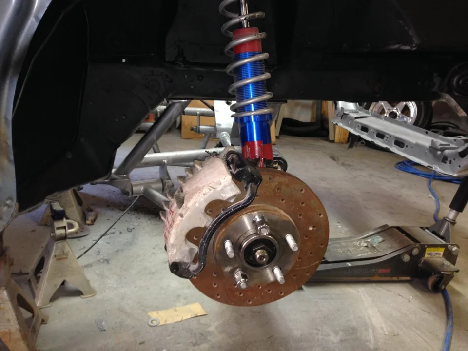

14-150. This was on the '85, but the same K member and coilovers are on the '90 right now.
