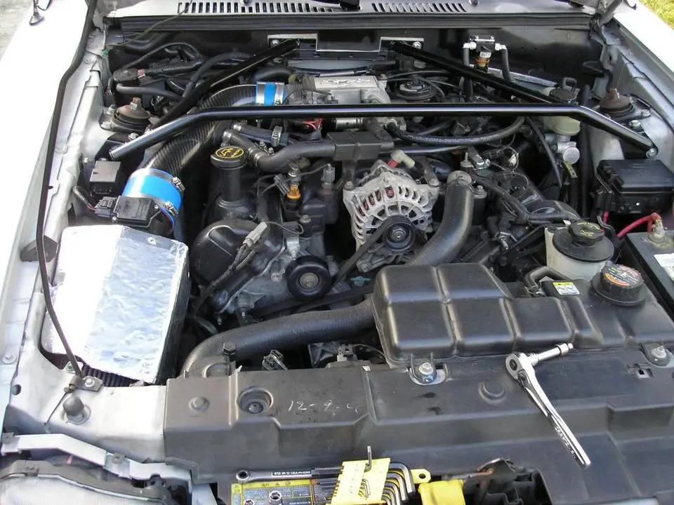

pic of my air box
steeda has some heat sheld wrap. www.steeda.com . i wraped up my steel airbox with it and made it look clean by taping the edges with aluminum exhaust tape. the temperature does drop on the intake side, i was able to verify it with the predator data logging. good mod to do to a daily driver with metal intakes.
