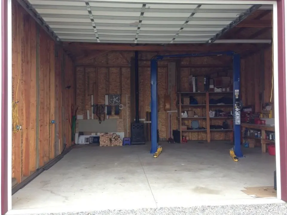

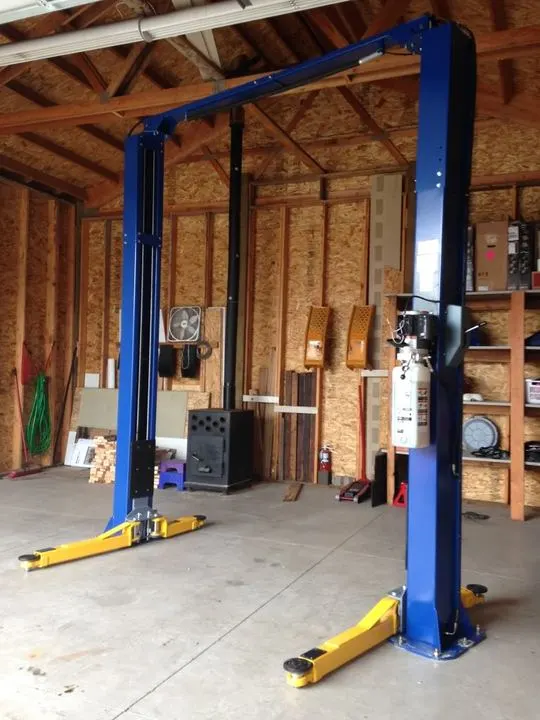

Once you have one not sure you go back, I bough myself a high rise 4 post bendpak last Christmas.
This way I could work on my vehicles and I wouldn't have to use up my entire 2 car garage just parking in there, I leave the mustang on it and park the explorer under it. Leaves plenty of room for other crap.

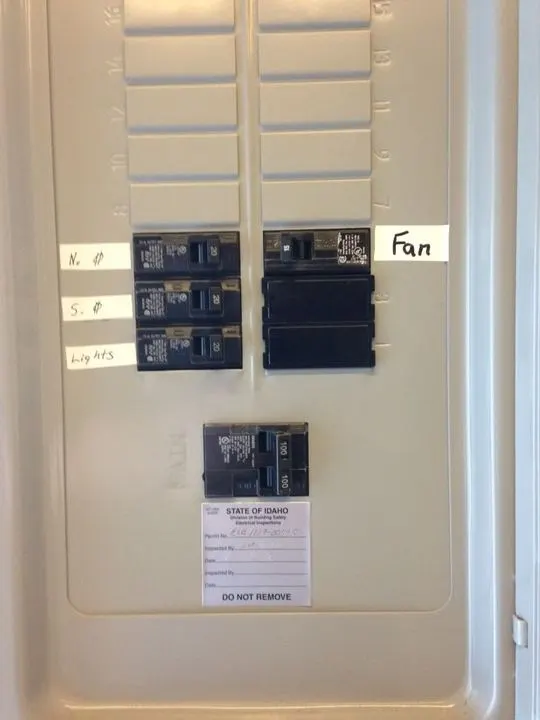

The electrical should be pretty easy. (I'm an electrical contractor), shouldn't take much more an hour or two provided you have a sub panel out there.

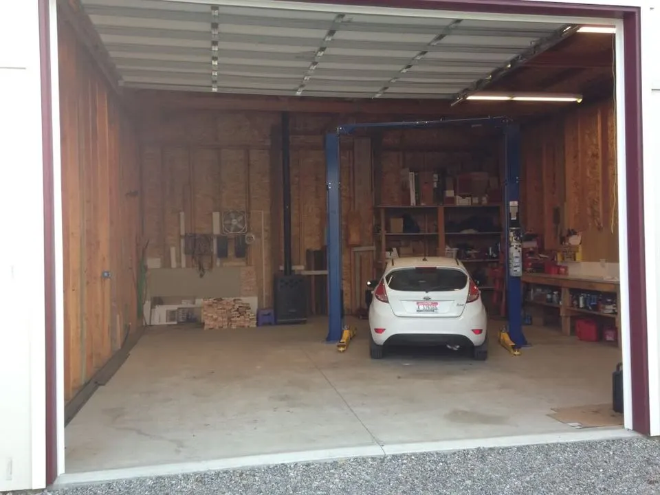

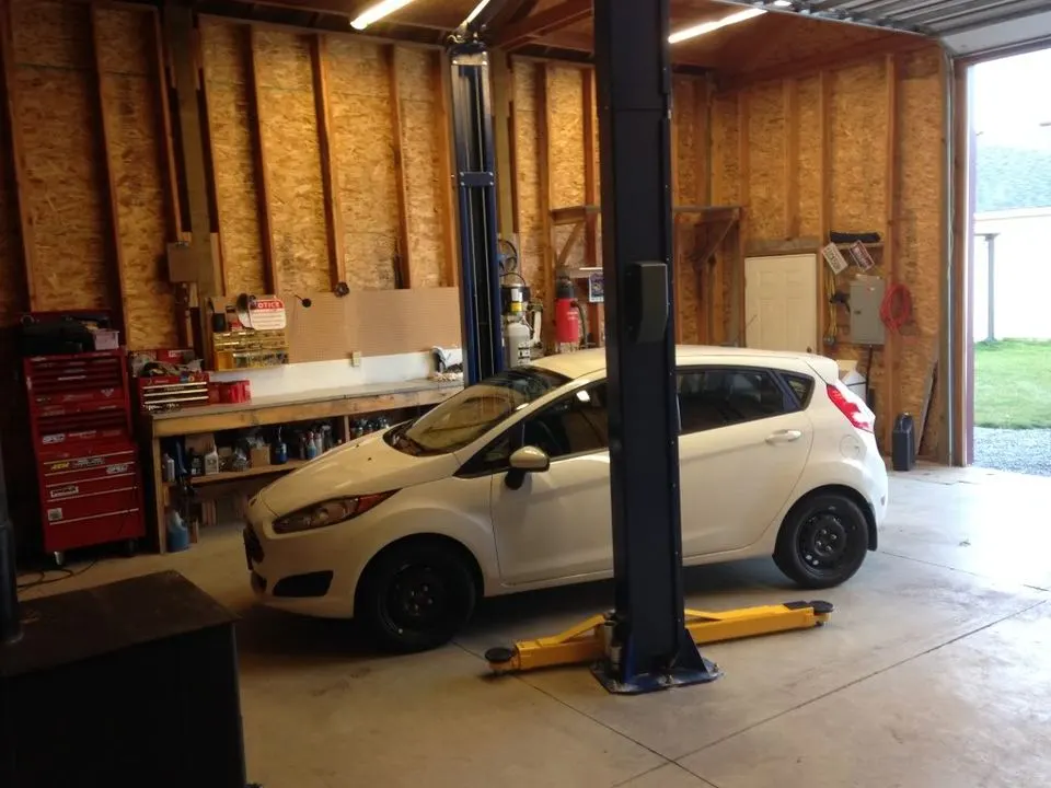

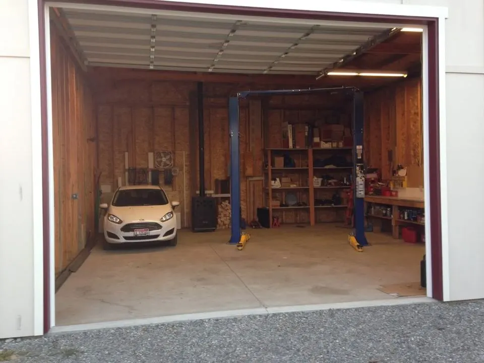

When you get a chance, can you park all your cars in there so I can get a general idea of how big everything is? I have a 2 car garage and would love to see if this would fit in there
My door is 16 wide, 7 tall (I think, but it's normal), had to convert to a high lift setup. So the door goes all the way up, then back.
Garage is roughly 20ft wide. Currently I have the lift offset to left, not enough room to right for a car, but I could slide it over and fit another car.

How good is your floor? A 4 post works on any floor pretty much, a 2 needs a quality thick floor.
Most 4 post lifts don't go high enough to park an SUV under. You pay extra for one that does.
