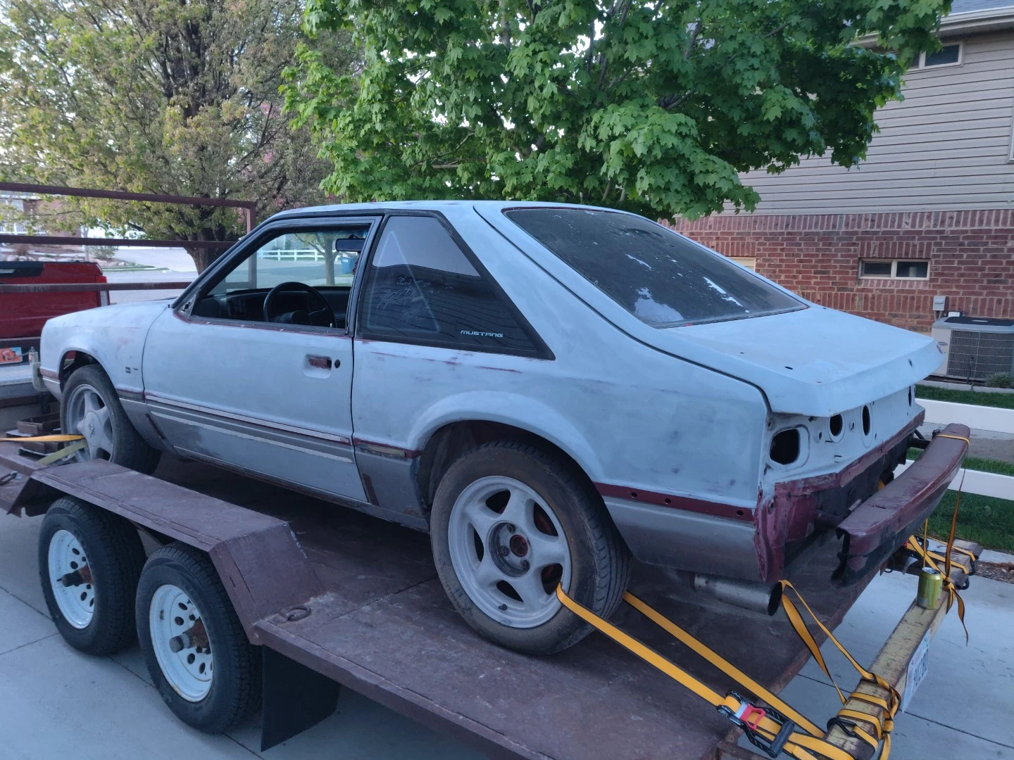

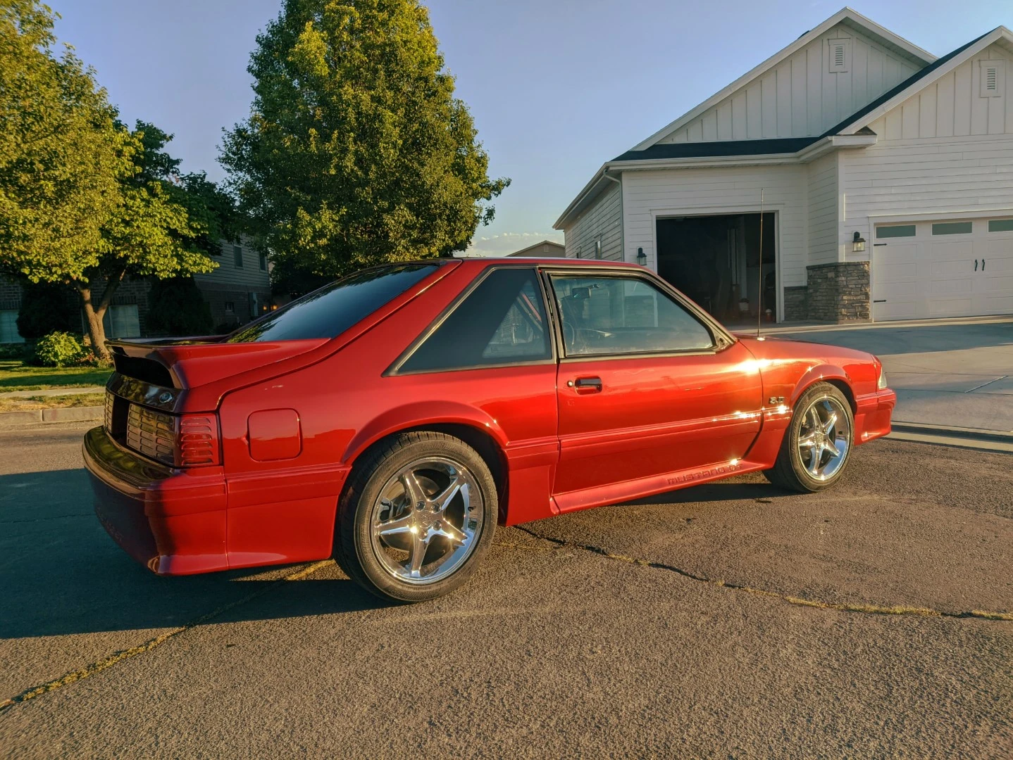

Whelp, as far as a progress update, got the car back from paint. Guy did a :poo: a55 job, wouldn't fix it, then literally closed up shop and disappeared. Going to have to live with it, can't swing any more money for paint.
Got the 5 lug and rear discs done, new springs/shocks and whatnot.
Here's a pic from the best possible angle, looks sick driving through the 'hood', just don't get too close lol
The day I got it., May of this year.
As she sits now.

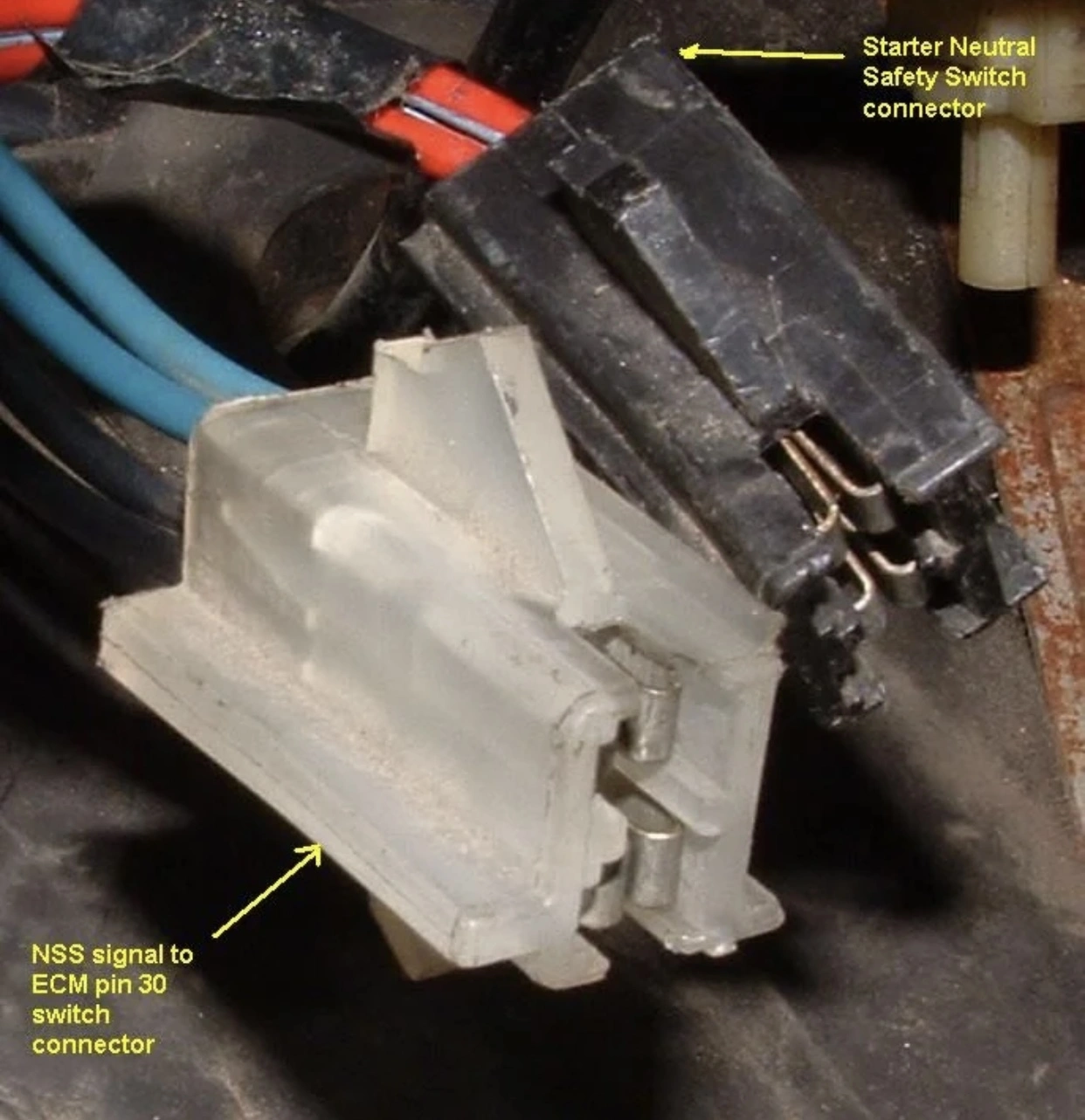

Go under the dash to the clutch pedal. There are two plugs on the clutch switch. Remove the clear one and put a 5amp blade fuse in it. This jumps it out, like having the clutch pedal pressed in all the time.
This is a temp fix, but hopefully solves the 2k hanging idle.
From here, I would troubleshoot the wiring from the NGS to the ECU. It’s pin 30 and pin 46.
Rather than pull the ECU. With the car off, stick a digital multimeter into the above clear plug on each pin and check for continuity as you move the shifter from gear to nuetral.
