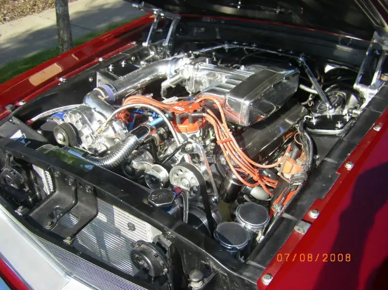

I wasn't too concerned because while it was running it ran well. When I pulled it into the garage I noticed oil on my headers and decided to wait a couple hours and then pull the intake off. I found out that I did not use enough silicon on the front and rear of the intake manifold. Oil was leaking like crazy and caused a huge vacuum leak. In the process of pullin the intake off I cracked my dizzy so I will have to go get a new case today.
I guess this is a good thing becasue the engine compartment looks like crap from the body shop dust. This will give me some time to clean it all up before putting it back together tonight. I am excited to see what she runs like when it is sealed up properly and there isn't a vacuum leak. I still need to get some pictures on here but every time I think I will some problem comes up. I hope to have some soon.

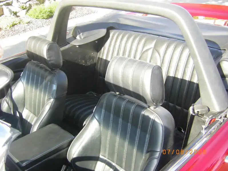

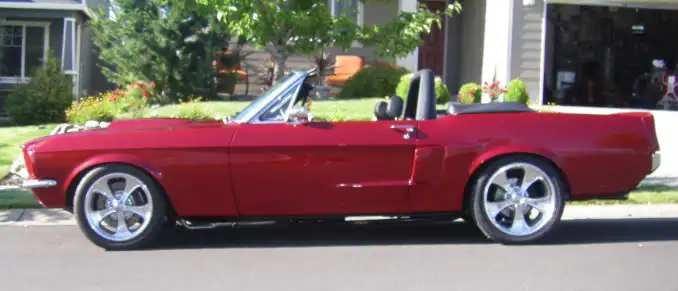

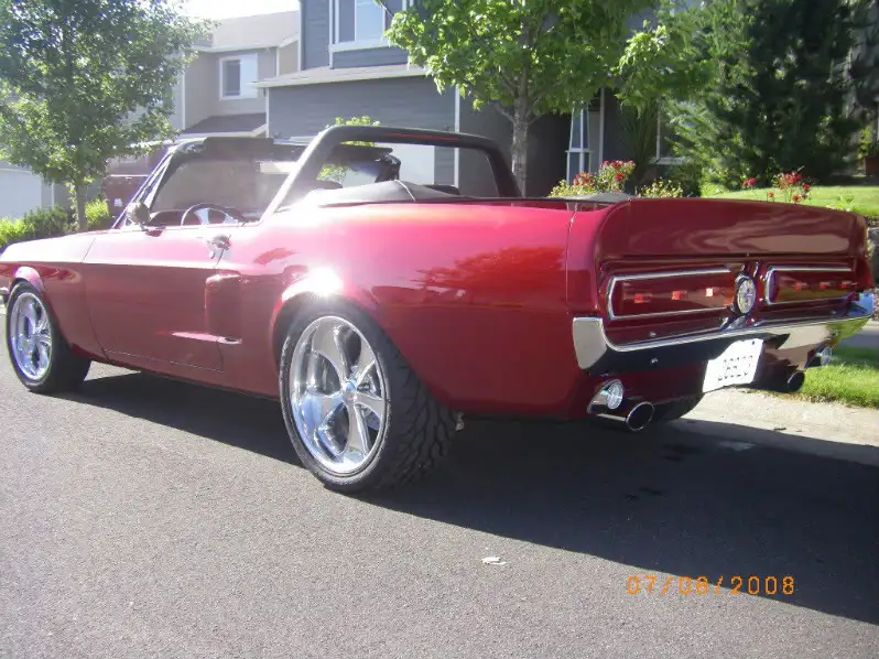

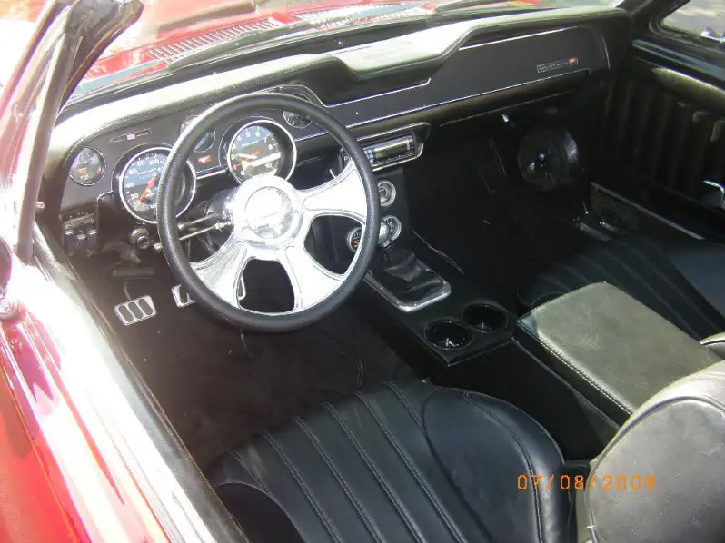

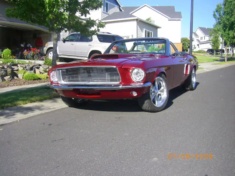

Here are a couple pictures of the car. I plan on redoing the interior quarter panels and also have more detail work to do in the engine compartment. It still have one more trip to the body shop to fix a wheel well problem and final buffing.
