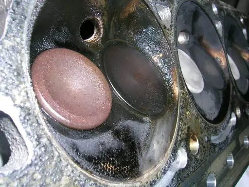

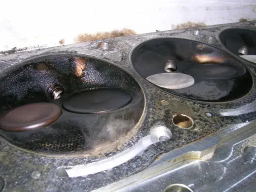

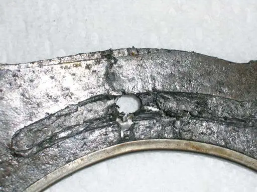

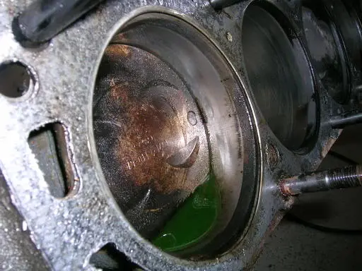

A few weeks before my trans went south on me, I noticed that my engine was running rather hot (230*). I checked the coolant and my radiator was amost half empty. I filled it back up and everything was ok. Then the next time I drove the car, I had the same problem once again...hot temps and missing coolant. My car wasn't making any smoke that I could notice and there were no odd smells. But it did seem a little low on power. I pulled the heads off today, and to my surprise I found this:
The gasket is barely cracked so I guess it allowed a very small amount of coolant to enter the cylinder and burn away slowly. I guess I'll have to retard my timing just a tad bit after I get things back together.
I was running a set of Fel-pro 9333PT-1 head gaskets. I'm wondering if I should just buy another set of those or get a different kind? Does anybody have any suggestions on a different set of head gaskets that will handle a nice amount of boost?

I would consider a different set.do your pistons come up out of the hole at all? in the pics it looks like the cylinder bore is smaller than the bore int he gasket. that is good. I have seen head gasket/head locating dowels (those things that hold the gasket in place) be bent or damaged allowing the gasket to hang down into the cylinder and cause the gasket to leak coolant into the cylinder in that exact same place. just my 2 cents chris
