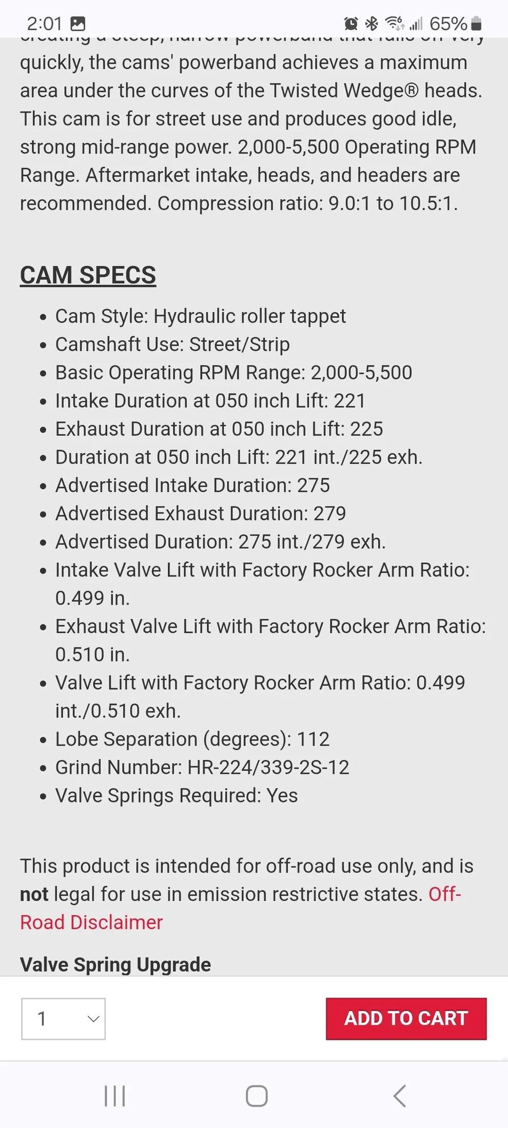

I'll admit, though, the trackmax cam looks milder than I expected:
Got a link to the build? Especially interested in the cam specs and power peak. I'dwant peak power in the 5,300 range for a 5,800-6k shift point. This build with a 100-150 shot would be the perfect stock-ish combo. Easy to swap/rebuild short blocks affordably.

My old AFR165 combo with an Ed Curtis special (224/228, 111LSA, .555/.560) and a lightly ported lower Cobra made ~320 and trapped 111-112 mph in a 3150 lbs car. I might just replicate that build.
That's all I found for links on Trick Flows site.
