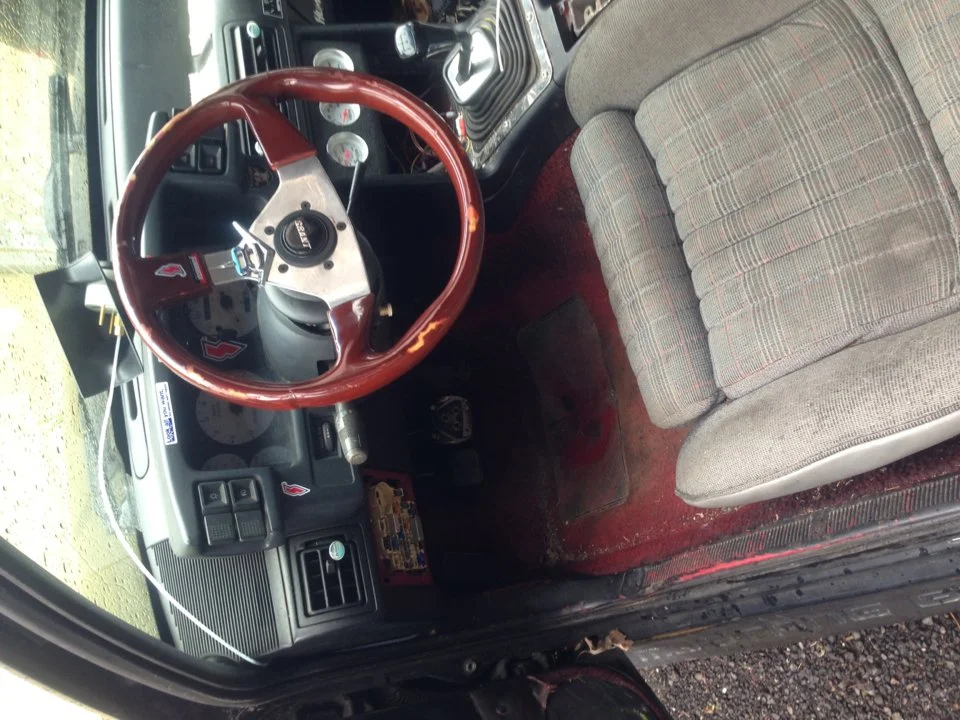

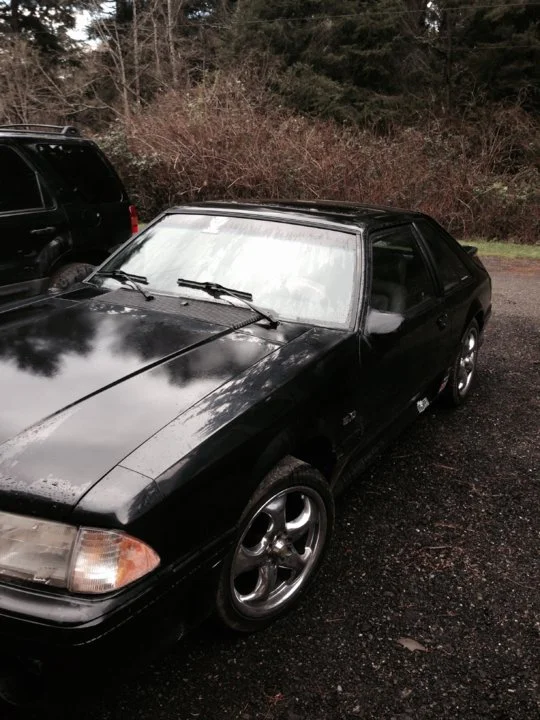

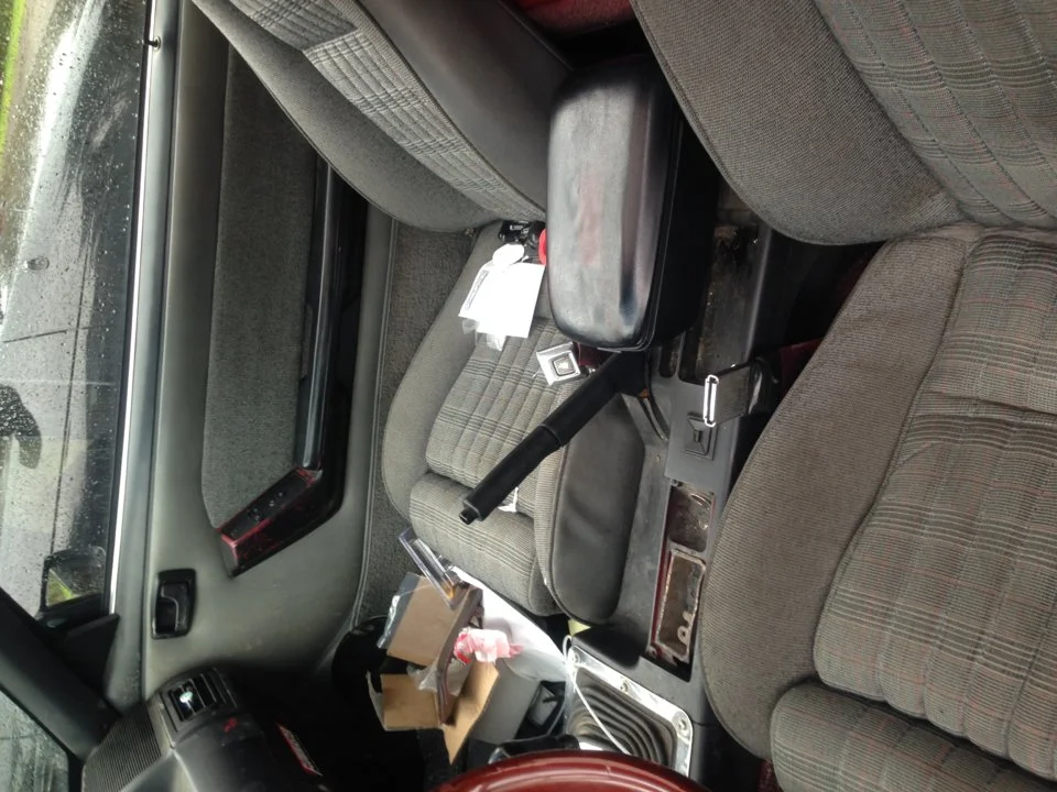

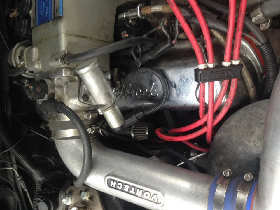

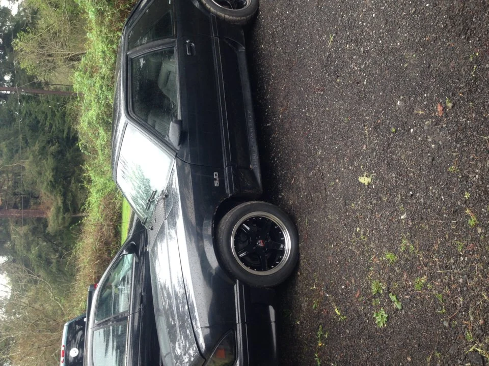

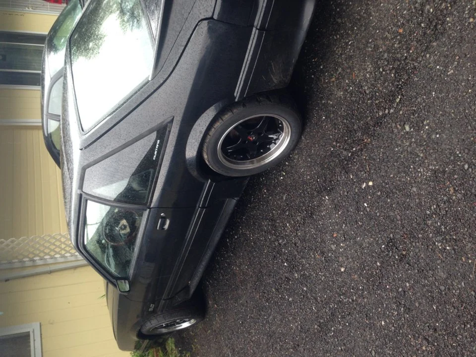

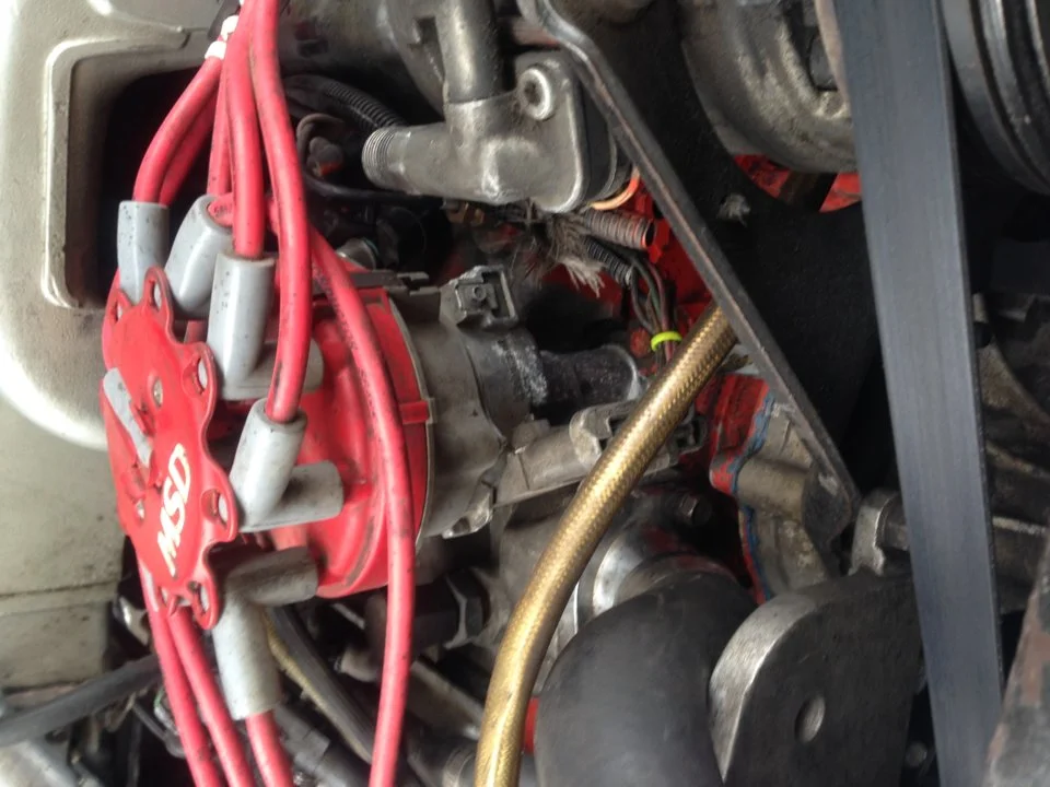

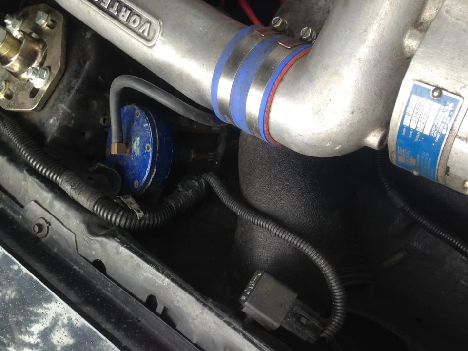

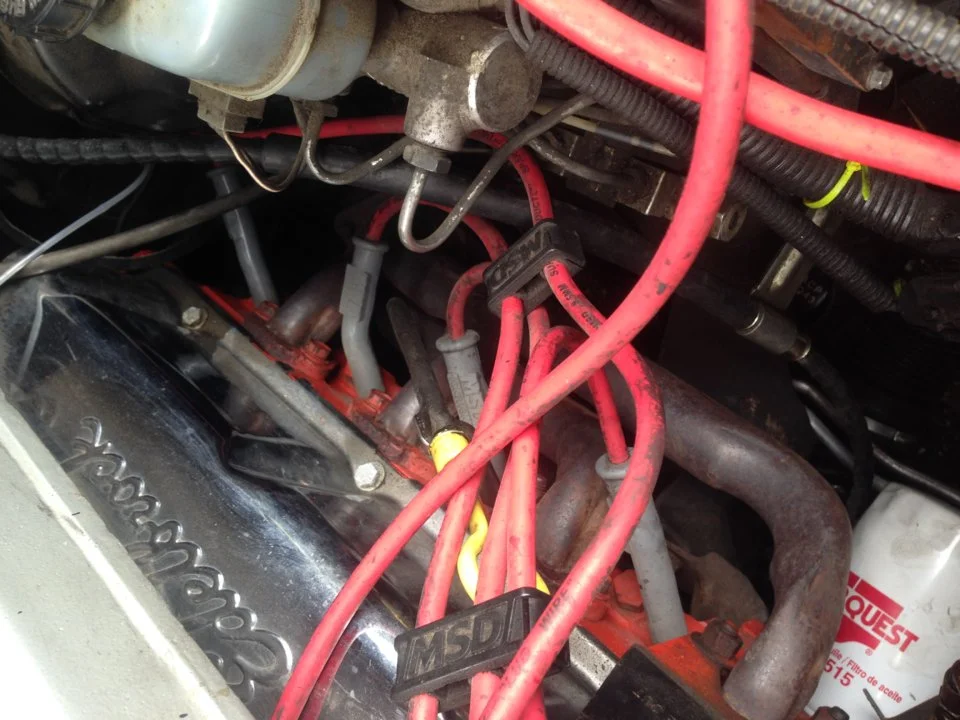

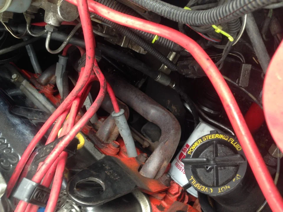

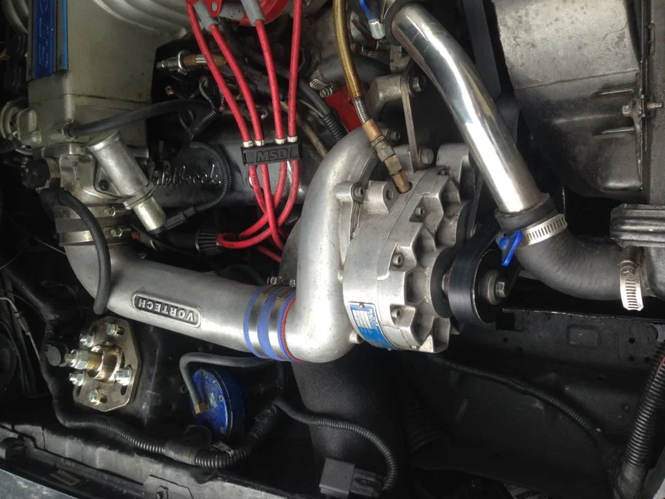

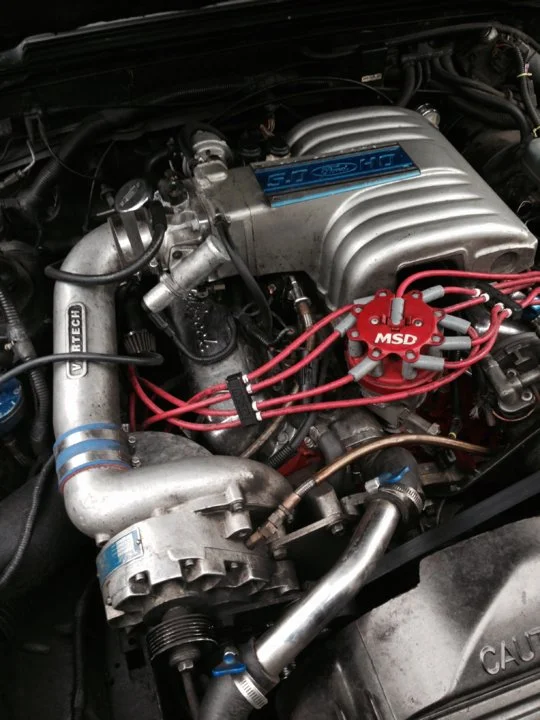

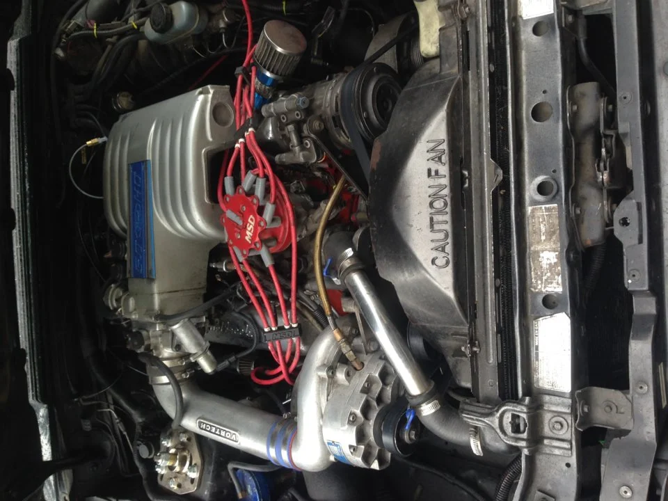

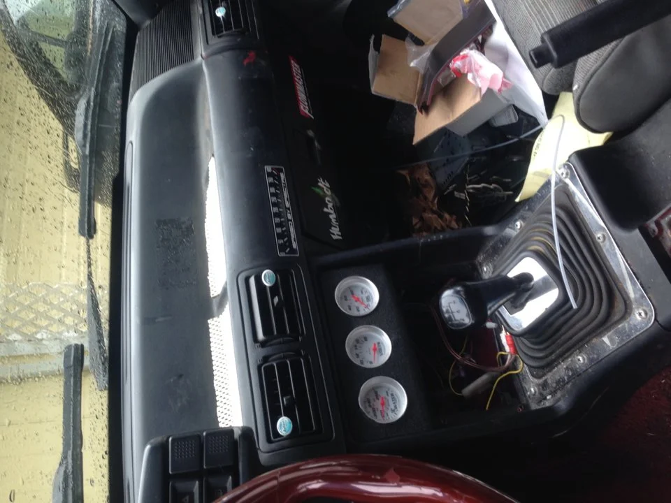

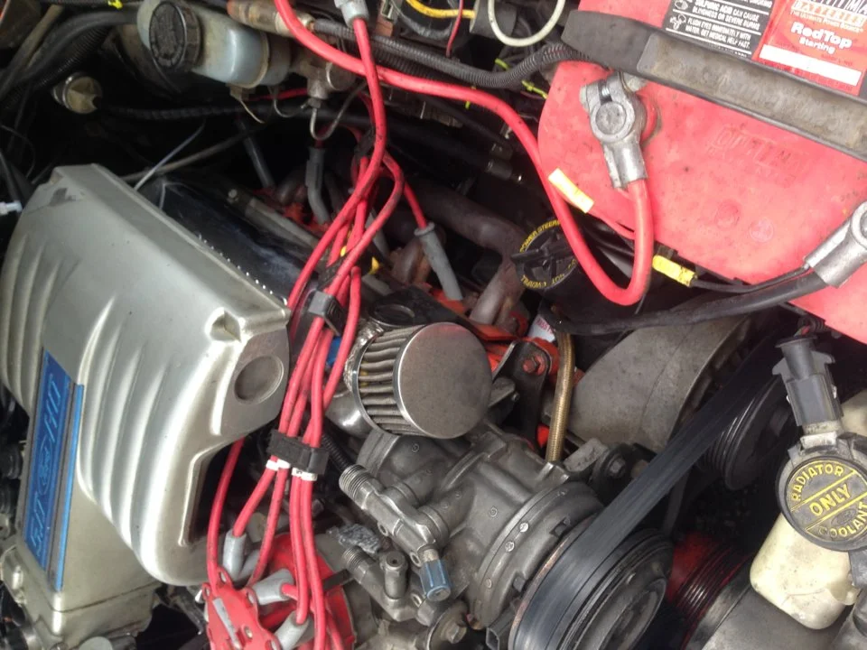

OK I took a group of pics since I havent put any up and I have been told pics are needed for best advice. So here is a bunch of them.

another thing i noticed was some higher levels of exhaust coming out of the rear when it was at higher rpms while ripping around. is that air/fuel ratio problem? I still am a newb remember guys.
Don't know what the interior pics are for but th epictures don't help much.. You need to read my post again and see if any of the items are there
Is your vortech not hooked up? It looks like the belt is off
Is that rust or coolant all over the driver side headers
