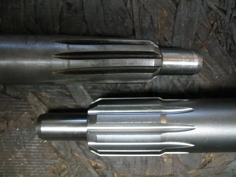

I drag race my toploader every week using drag slicks and holding the go pedal to the medal. The only issues I had with the small block toploader is that the input shafts will twist and cause the clutch to not engage properly. At first I thought this was a fluke, until I replace it and twisted the replacement the very next week!
Note that the bottom one is the only one that is straight. I was putting about 450hp to it at the time and was launching around 3K.
I then upgraded the input shaft to the 1 3/8" big block style replacement and have had no issues with it with 5K launches and even more HP.
You can see the difference of the SB and the BB input shafts.
Other than occasional gear replacement due to worn engagement teeth, the toploader has been reasonably bullet proof since. I did save up enough $$ and later went back in to upgrade the output shaft to 31 splines, although the old 28 spline stuff held up just find.
