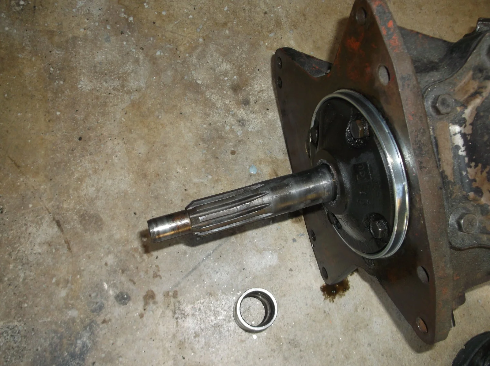

You also can send your input shaft to Liberty Gears in Michigan and they will cut your input shaft and raplce the nose with new shaft made from 300M material and you won't twist it or break it. See the twist in the shaft. That's after 3 passes with slicks at the dragstrip.
I am taking mine apart and getting ready to have it done. Call them and ask for Paul. Phone # 586-469-1140
