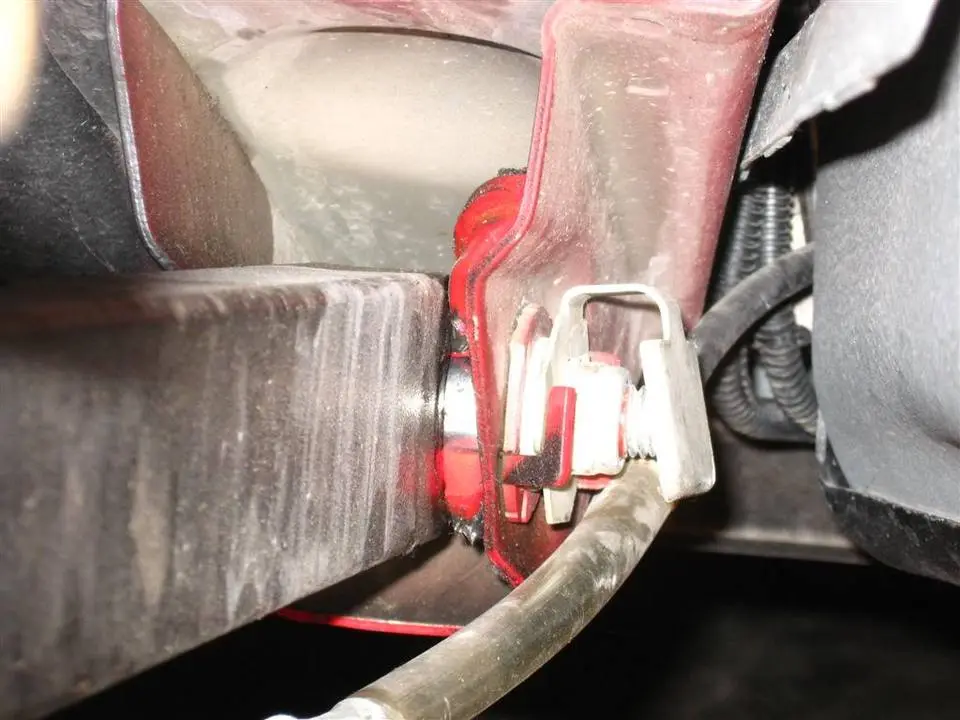

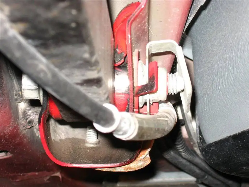

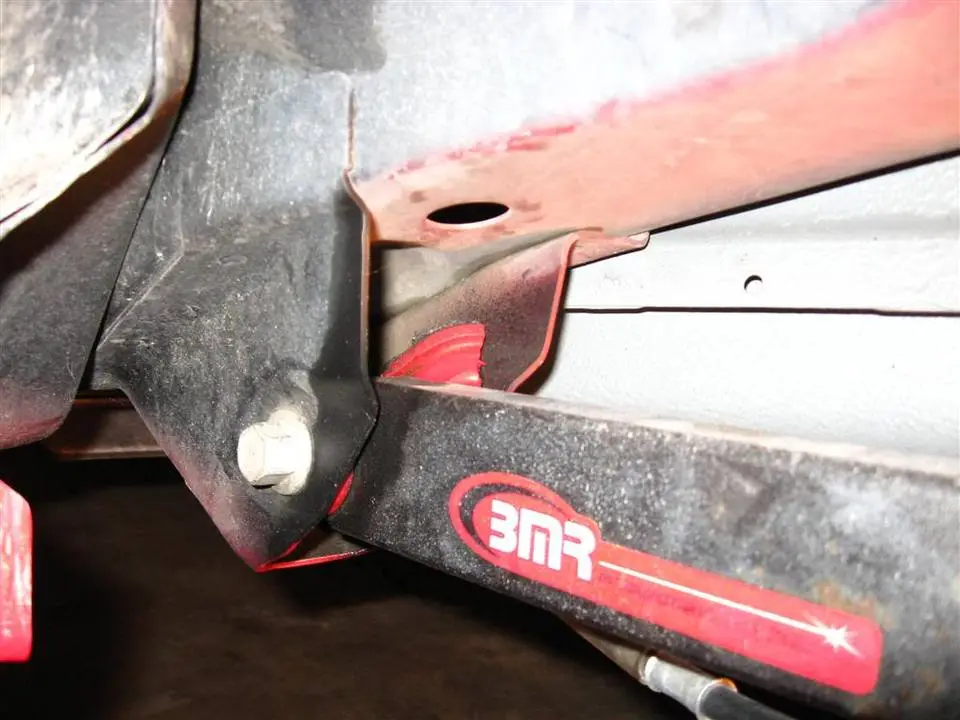

So my BMR tubular LCA's are exhibiting what I've heard from other people. Unfortunately, I'd heard it after I ordered mine. I've had a terrible squeak from the back for weeks, and I'm hoping that this is the problem. But, at the same time, last time I was at the track I launched at 5500 and heard a loud pop. So who knows which it is. In any event, I don't feel like dealing with the BMR LCA's anymore, especially because putting the BMR arms in their relocation brackets sucks (the bushings are a hair too wide). Right now it's between CHE and J&M. What do you think?

wow, I can't say I've ever seen that happen, and I come from the off-road world haha. I will bet you that that is your pop at the track (think about it, all the load that bushing say at 5500 RPM launch, that has to be what cracked it), and your squeek. I wouldn't doubt if you hear a clunk or two every now and then either...

Yeah, I'm almost positive that was my pop. I think the squeak is the D-Specs. Everything seems tight, so I don't know what the problem is with those. Guess I'll have to have a suspension shop check them out.

poly/poly. Apparently BMR had a bad run of bushings. Most of the people with issues bought them around them same time. I'm sure they'd give me a free replacement, but I'm just wanting to put something else in.
