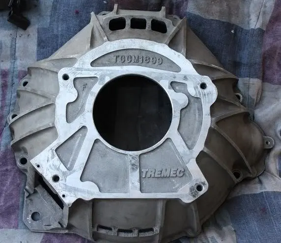

-TKO 600 bell housing

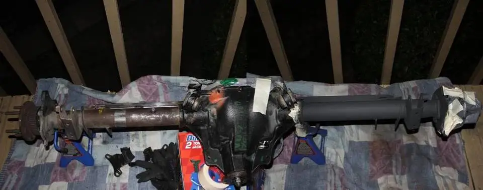

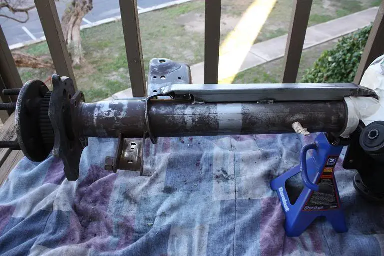

(sorry for the crap photo) Mach 1 8.8, This rear end is stuffed with a Auburn 31 spline pro series diff and Moser 31 spline axles. Going to throw in my 3.73's to replace the 4.10's currently in also.

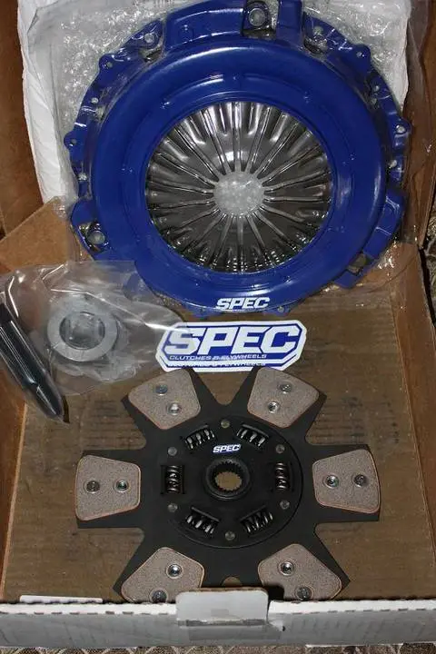

Spec Stage 3 arrived! 26 Spline to fit the Liberty built TKO 600 on order :rolleyes:.

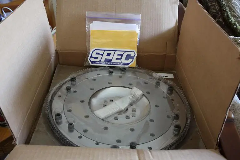

Still waiting on Gaskets, Rear poly bushings, Spec flywheel, ARP Flywheel bolts and a few Mach 1 rear brake assembly goods.:D

I should have the rear finished being cleaned up and painted by tomorrow.
This just in!

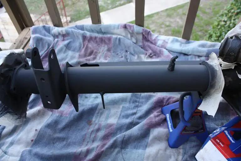

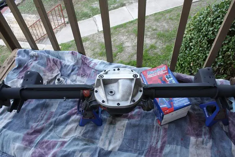

Been cleaning up the new rearend. This photos are cropped to show side by side. Used Brake cleaner to knock the grease off, than 400 grit sand to remove rust and last some hot soap water to clean. Sprayed two coats of High temp rust-oleum flat black. Just a little side project before it goes into the car.:D
