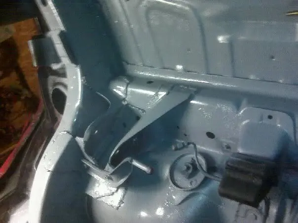

srtthis the guy doing it does every local racers rear end 15 Year Member Jul 3, 2009 5,129 1,666 204 Maryland Dec 16, 2010 #1 Dec 16, 2010 #1 going to be bolting in the rest of the UPR battle boxes tonight and start getting the rest of the fuel system finished

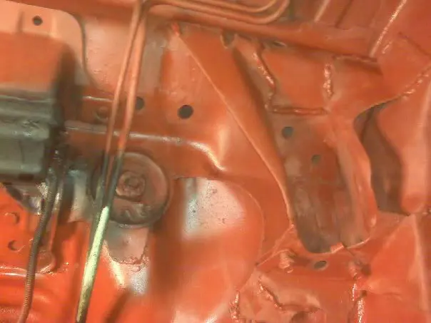

srtthis the guy doing it does every local racers rear end 15 Year Member Jul 3, 2009 5,129 1,666 204 Maryland Dec 18, 2010 #3 Dec 18, 2010 #3 drilling everything out for the uppers SUCKS... the spot welds are hard as ****! but i just need to get longer bolts for the 3/8th bolts and then i can tighten everything down and put the hiem joints in
SMOKEDYA 20+ Year Stangneter Jul 13, 2003 3,637 8 79 Tucson AZ Dec 19, 2010 #4 Dec 19, 2010 #4 Why arent you welding them in instead of bolting?peace john
srtthis the guy doing it does every local racers rear end 15 Year Member Jul 3, 2009 5,129 1,666 204 Maryland Dec 19, 2010 #5 Dec 19, 2010 #5 they are welded and then bolted. i want ZERO chance of them ripping. im running UPR radius arm uppers and pro lowers so i have ZERO bushings
lancec2c30 Member May 14, 2008 570 0 16 Washington Dec 21, 2010 #6 Dec 21, 2010 #6 Yeah, most of the kits I have seen are welded and bolted to pull the brace into place.
srtthis the guy doing it does every local racers rear end 15 Year Member Jul 3, 2009 5,129 1,666 204 Maryland Dec 21, 2010 #7 Dec 21, 2010 #7 yea im taking ZERO chance of ripping them out. im running radius arm uppers and pro adjustable lowers
