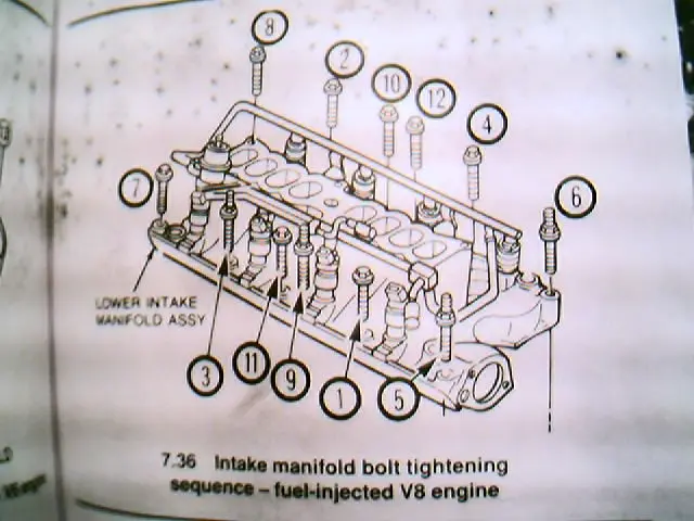

Guys I need the torque sequence and torque specs of the Explorer GT40 upper intake? I don't have either a explorer or mustang 5.0 manual, nadda.. Help a brother out lol!
i use a haynes manual whenever i need torque specs. the list of torque specs in my manual has no listing for upper to lower bolts. i have had my intake off quite a few times and never have a problem. the lower to head bolts require a pattern and specs but not the upper to lower.

I wouldnt worry too much about the upper, theirs no sequence and I wouldnt torque them over 20lbs. Ive broken two upper intake bolts on the gt40 intake, make sure you have the right size bolts. Just make sure you got the lower correct. All torqued to spec and correct sequence.

upper is just over hand tight or you might possibly strip them...no need to go anything over 10 lbs IMO. Lower intake...I go 18 on aluminum heads retorque a couple times after driven...follow the sequence on the lower and use RTV on the block/heads/Intake ends.
