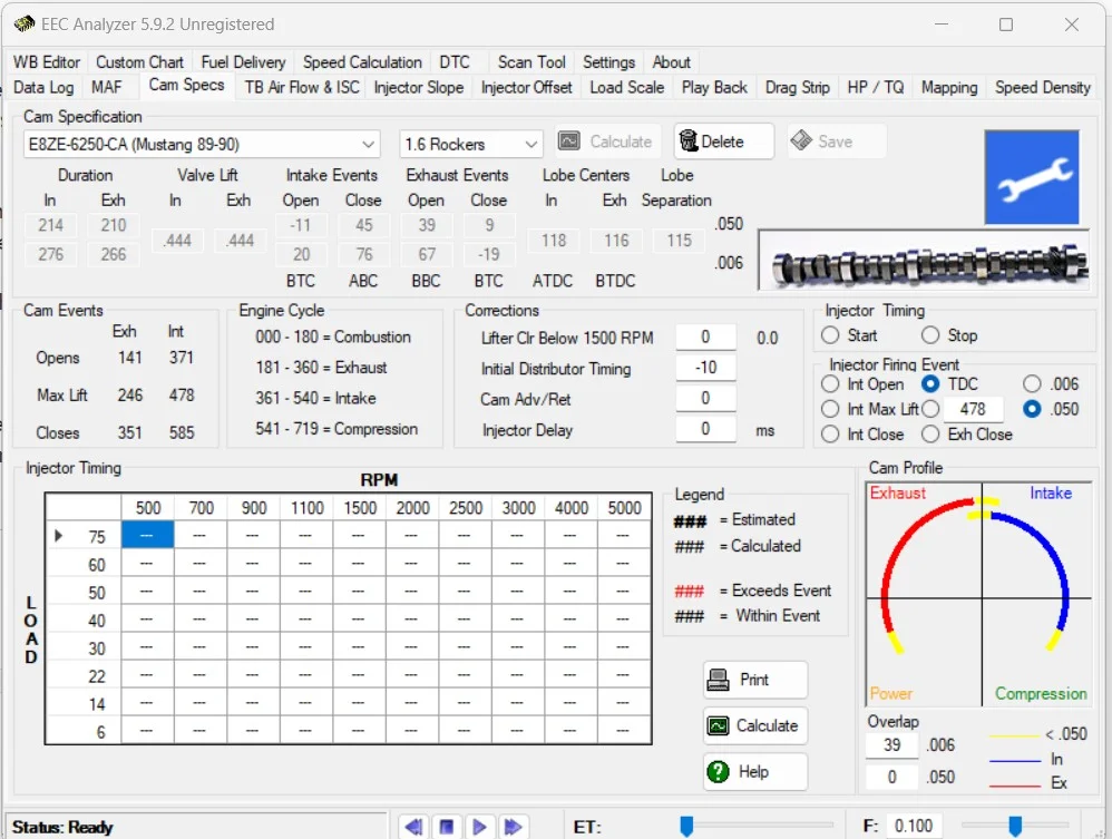

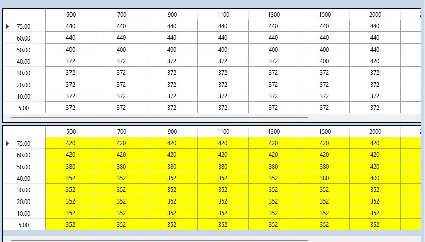

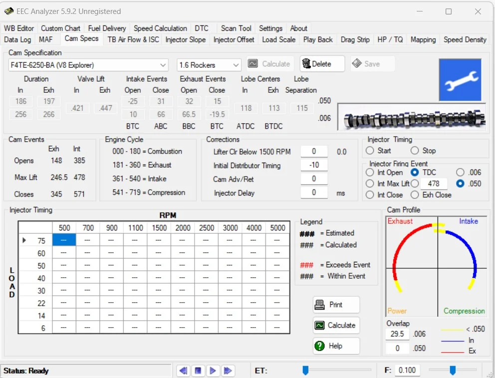

YEP and the most critical is the fuel injection timing table especially if you arent running the stock camshaft.....................
For my 351w with Explorer camshaft I had to rescale the fuel injector table by 20 to be in spec with the intake valve opening events.......
The top is the setting for my 351w and the stock 302 is on the bottom..
