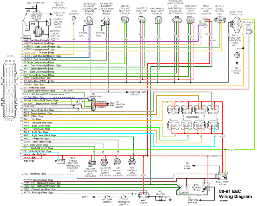

Step 7.) With power off, connect one meter lead to the black/white wire on the TPS. Connect the other meter lead to the battery negative post. Set the meter on the lowest ohms scale and take a reading. You should see less than 1 ohm.
JRICHKER....UM I'M SPEACHLESS. ANOTHER WONDERFUL SCHEMATIC ****. WAY COOL.

Credit for the diagrams go to Tmoss (diagram designer) & Stang&2Birds (website host) . Their site, http://www.veryuseful.com/mustang/tech/engine/ is one that everyone should bookmark and visit regularly.
You are right, with no ground, the green wire will float up to Vref, at 5 volts or very close. Adding another ground wire is one way to fix this problem. Just be sure you run the wire either to the computer power ground (computer pins 40 & 60) or the body power ground by the battery.
Sometimes the computer will burn open the trace on it's circuit board that connects pin 46 to pins 40 & 60, which are the power grounds. Then you can't dump the codes either.
Most of the time there are other things that lose the ground at the same time. The EGR, TPS, ACT, ECT and MAP all share the same ground. Anytime you have a ground problem with one sensor, it is a good idea to check the ground on all of them.
