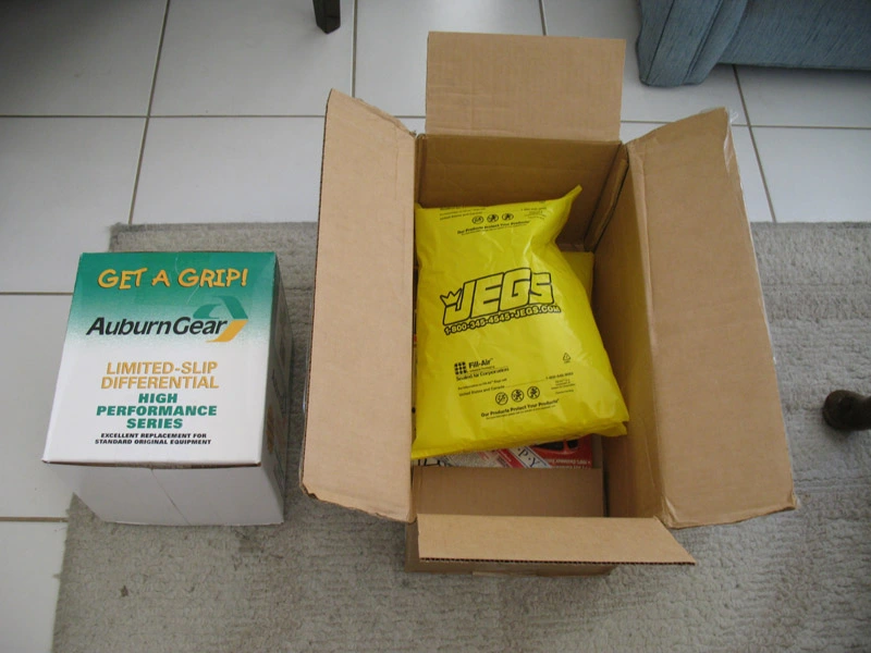

Auburn LSD>Trac-Lok

I can straight say that the Auburn LSD is one of the best upgrades i have done. Its ****ing Awsome. I can feel the torque splitting between wheels in a turn. Torque Bias Diff FTMFW!!!
