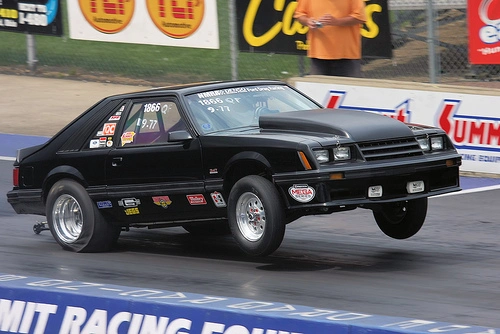

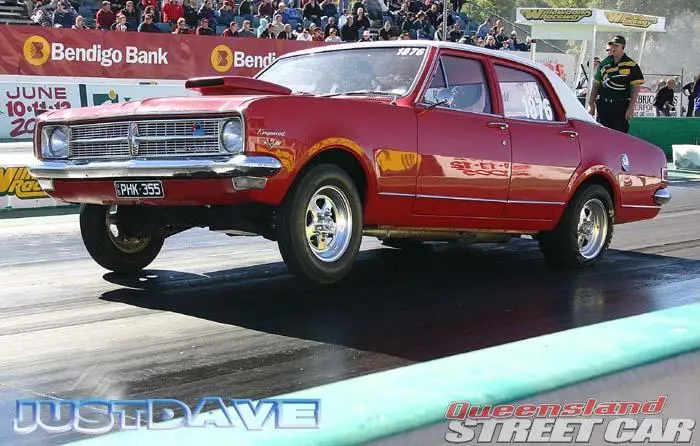

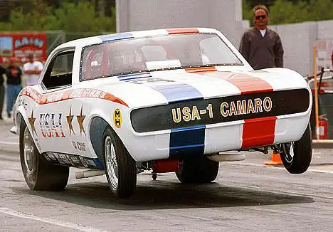

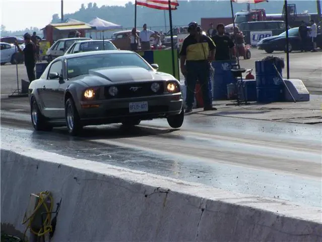

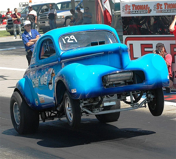

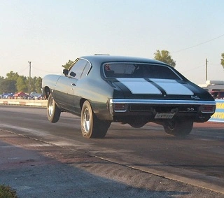

see how all these cars are leaving? the drivers side front tire is always a little bit higher then the passenger side? think of how your transfering the weight. think of if you lift the car up so the car looks like that, where is all the weight going to? the right rear tire.
its shocking the right rear tire the most. if you stand on 1 foot, are you going to have your weight equally distributed through both your feet? when you launch the car the front end is going to lift up. not that drastically in most of our cases, but thats the best example i could find to show you.
matt dasilvas s197. n/a. bolt ons. stock head cams i think he might have a ported stock intake, but he didn't see any power gain from it. hes currently running mild bolt ons, 12.04 @116.
if your into racing, you should recognize the last name. joe dasilva is an extremely popular racer.
My S197 Project build thread - WWW.S197FORUM.COM heres his build thread if your curious as to what exactly he has done. i would think his set up is pretty damn good since hes pulling better times then most s/c s197s i've seen run.
just figured i'd throw that in there so it doesn't seem like it has to be a 600 horsepower car to transfer weight like that.
and like i said in my original post, what 4,000 lb car weighs a thousand pounds at each corner. i sure as hell don't have a second motor in my trunk, so my rear end is lighter then my front end. and if you cut my car in half, all the components are not symmetrical. i don't have a steering shaft, master cylinder, etc. all on the passenger side also.
