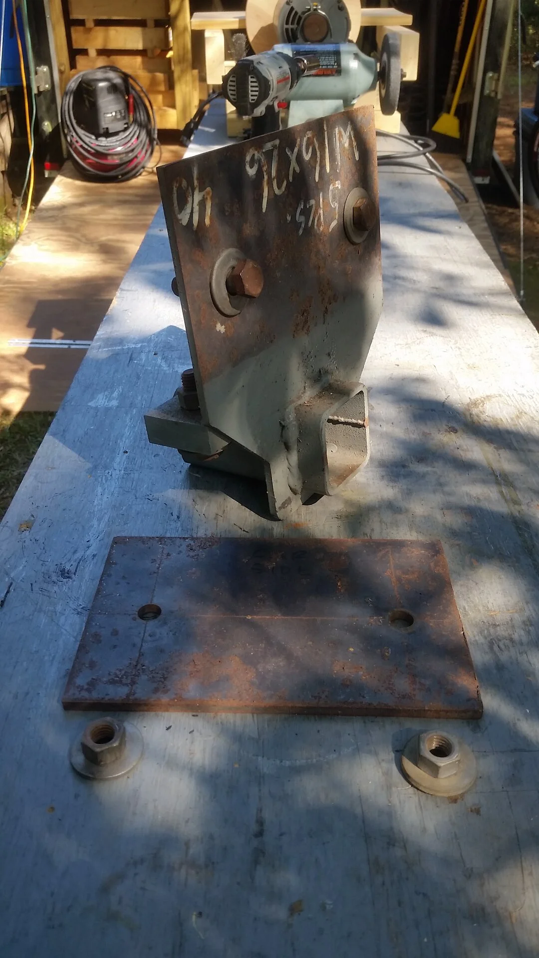

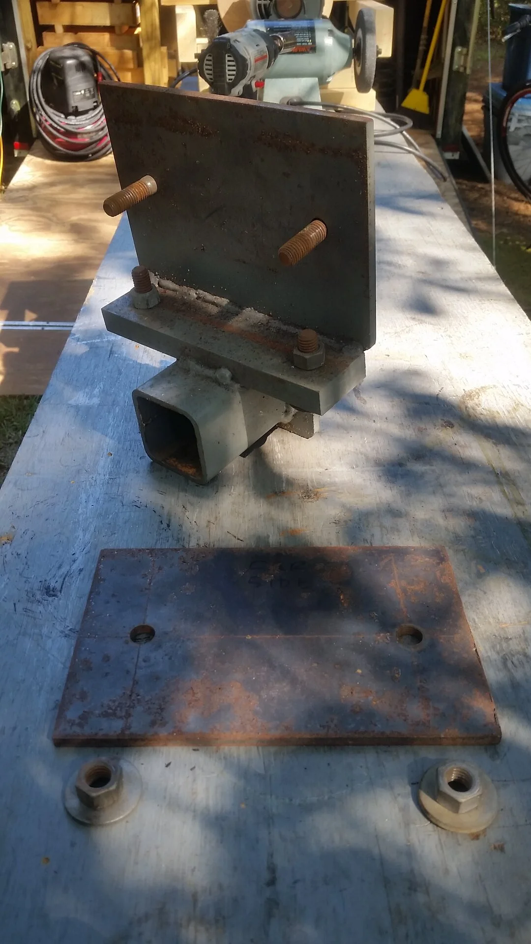

Sorry for the terrible pics. I think I'll hit it with a wheel and repaint it so it looks decent. The flat plate goes inside the C channel rear bumper. The main piece goes on the outside and it clamps together to sandwich the bumper. The two vertical bolts attach to the bottom of the C channel bumper. Once installed it looks like the picture above....my feature convertible. It's really not that noticeable. I pulled just over 1k pounds of motorcycle and trailer several hours on the interstate with no problem. The vert was stock brakes and suspension. T5 car. Factory radiator as well. That's all I can think of...lol.
If i can help just let me know. It's an easy piece to make. Even if you have to pay a welder there's very little welding anyway.

Well that bracket looks heavy duty

Thank you. Part of what I was wondering is where to best clear the LX exhaust and gas tank. It’s tight back there. If a stock convert can handle minor towing, the B springs, upgraded sway bars and shocks/struts should be good to go. Post bookmarked and pics saved.
Yeah this hitch is compact. No issues. I saw my CAD file the other day. Maybe I can do some screen shots to show the dimensions.

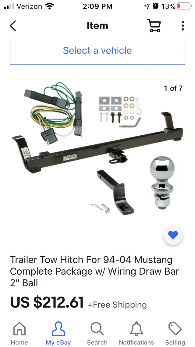

Your hitch looks super HD compared to the 94+ one I can find.
if you can share some important dimensions, that would save time with cardboard templates. But even the pictures and description help know if the universal assembly required kit would be a good place to start with or if I should go from scratch.

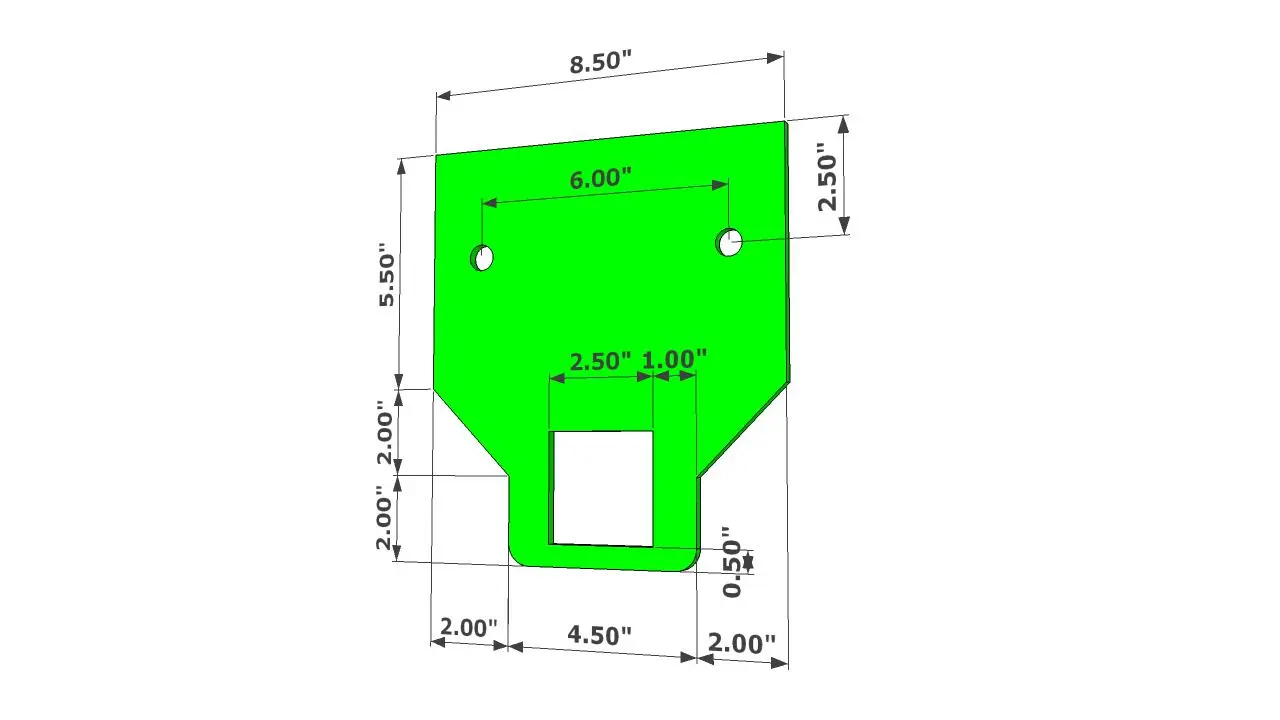

Don't buy any kits. I'll get the drawings for ya. It's cheap to build.

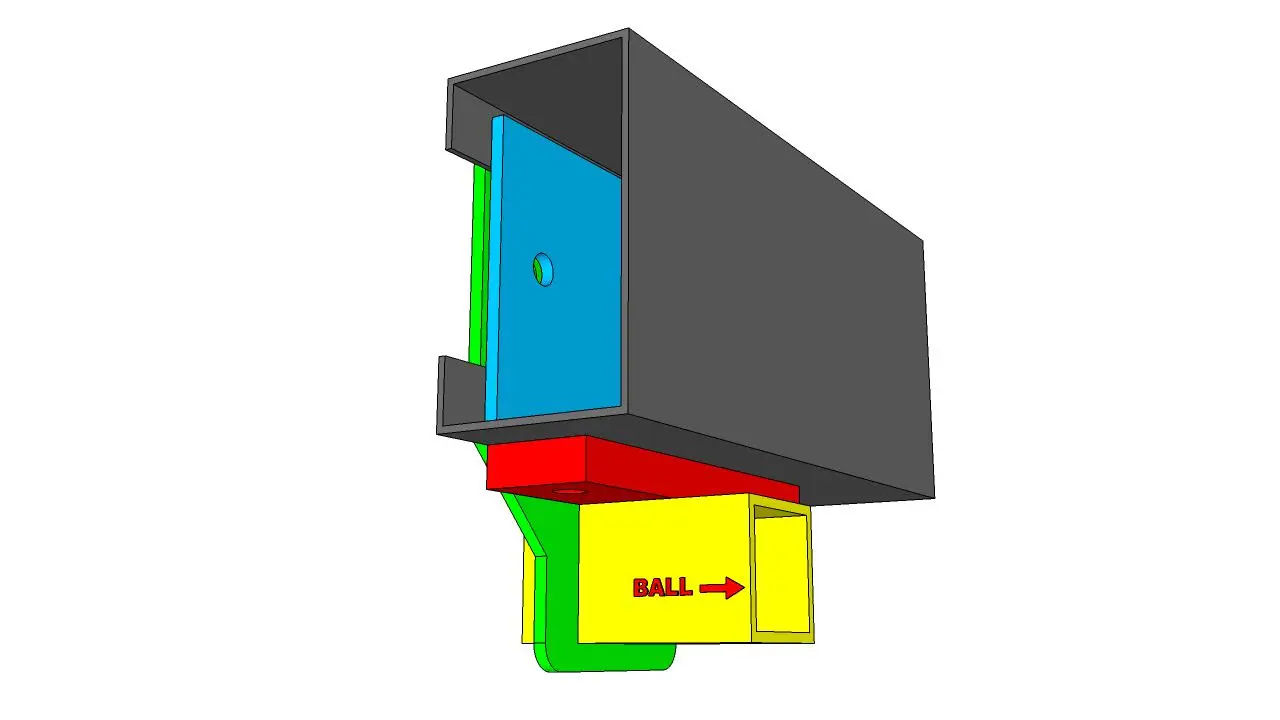

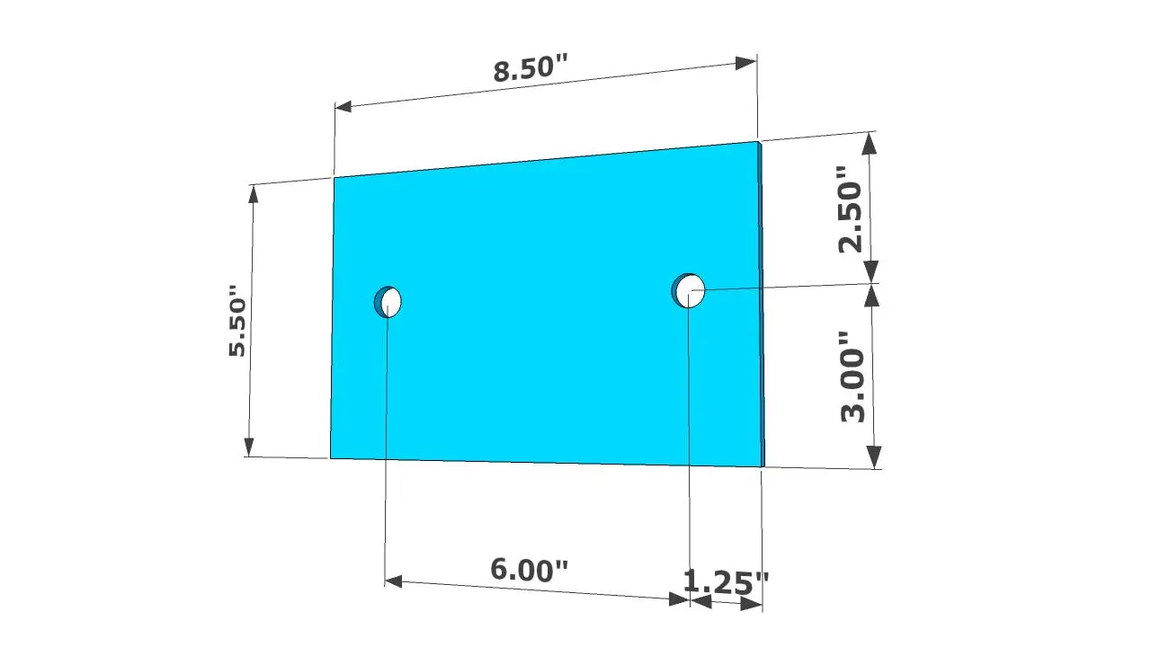

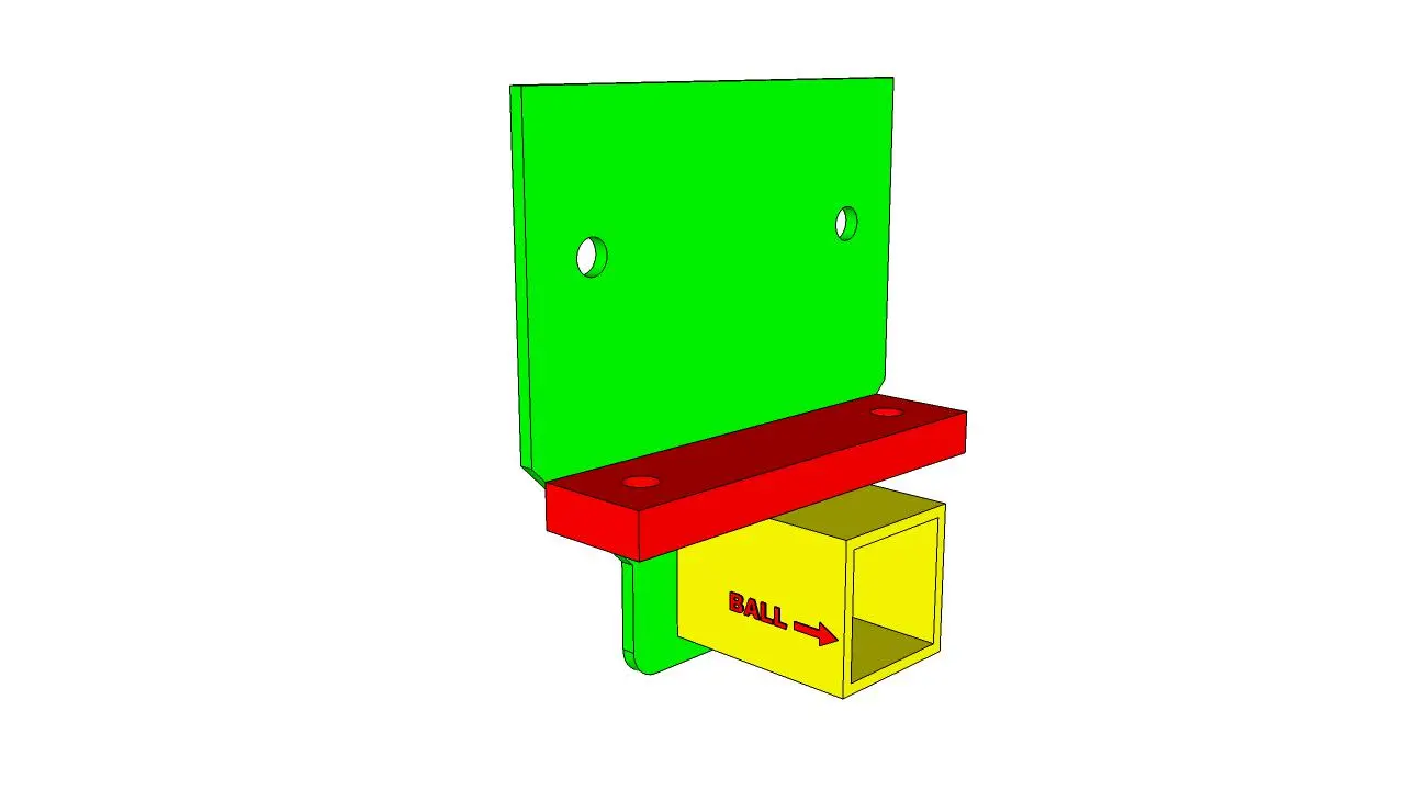

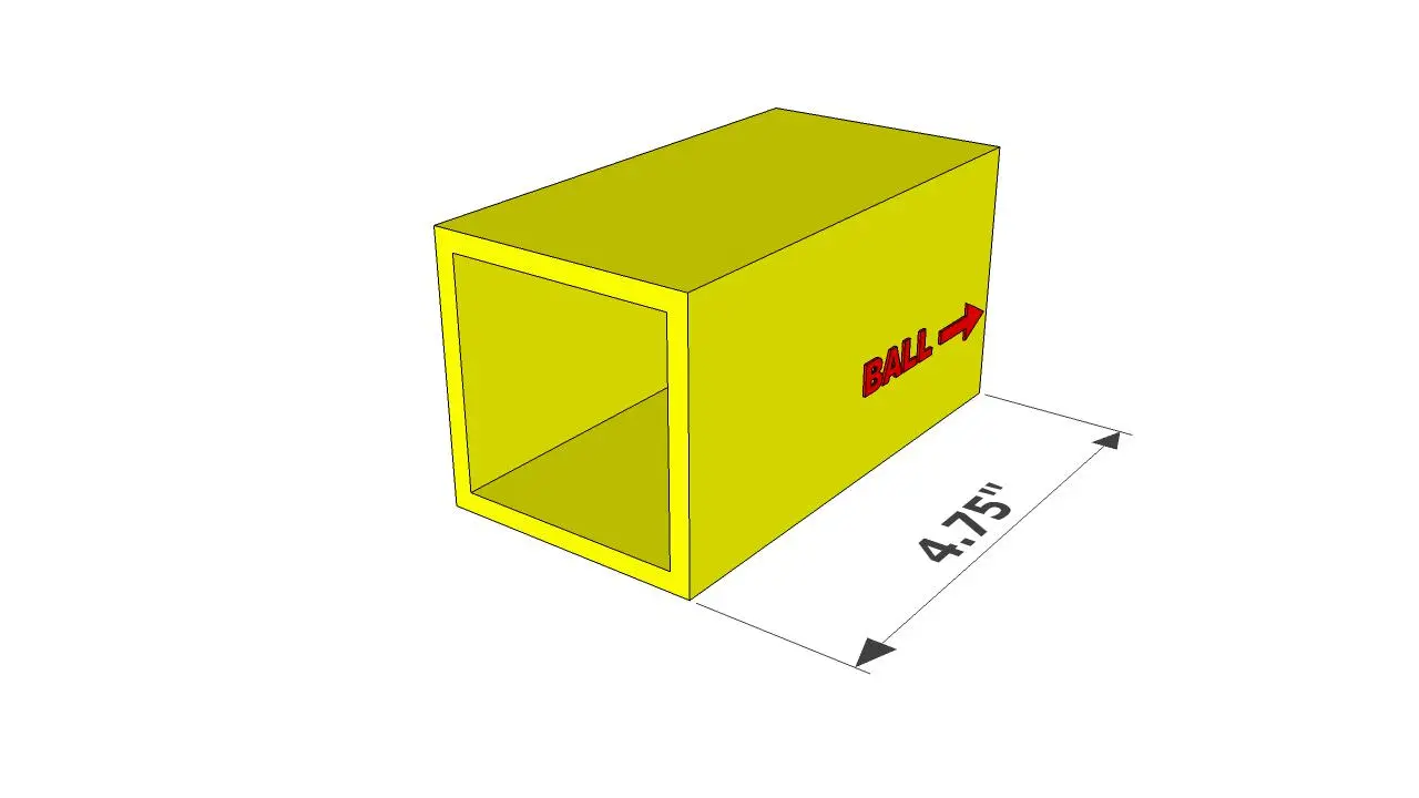

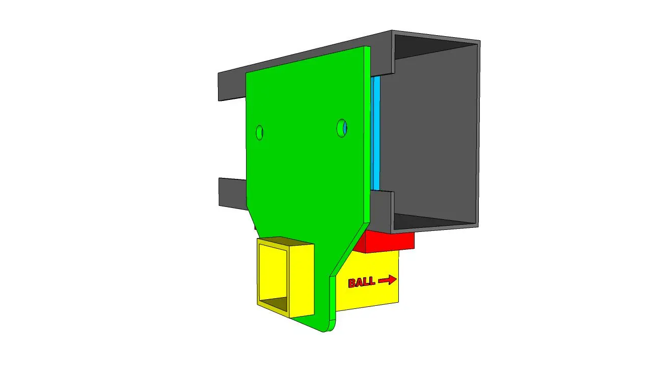

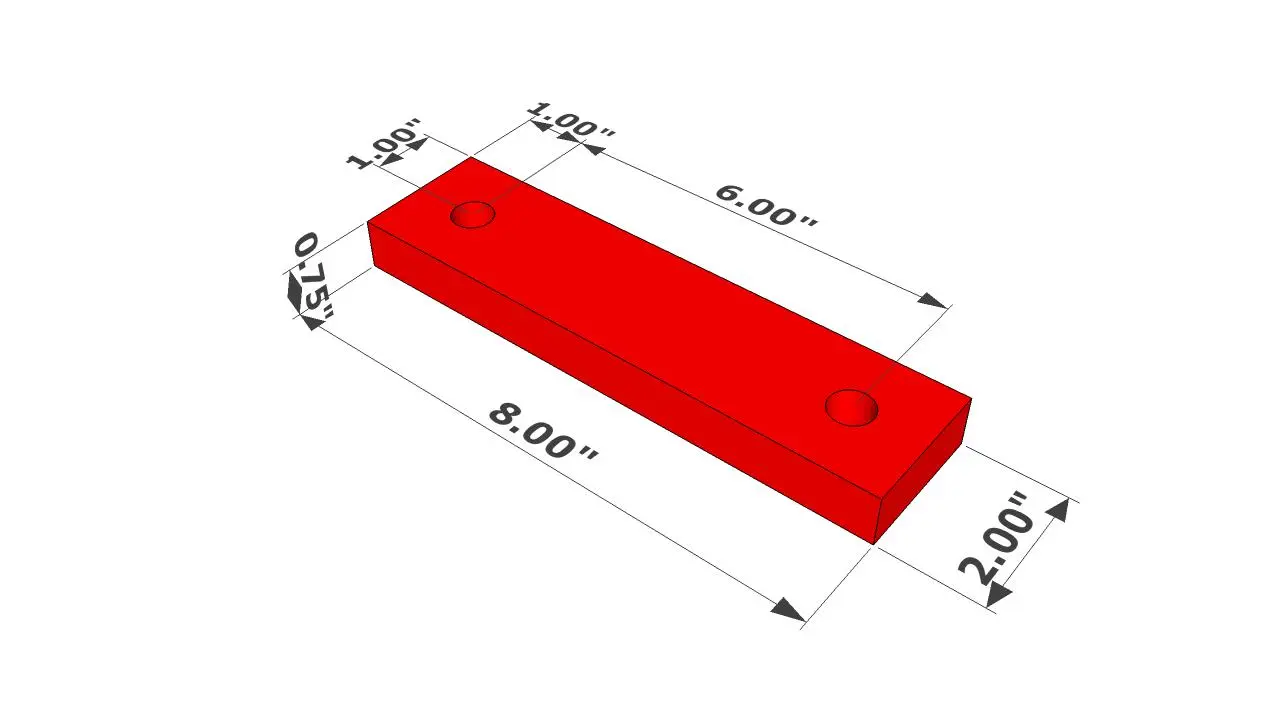

Here are the assembly drawings. My original file was in Autocad and would have been difficult to see on here so I drew it in Sketchup this morning and colored it up for clarity. I didn't draw the fasteners. I'll measure mine and see what they are and post that info. I am also going to check the actual part as finished against the drawing to make sure I didn't make any changes on the fly. I'll post those tomorrow probably. Next post is the individual parts....

You'll want to go to a local steel company (not Lowes!!) and get the parts. Just ask them for a piece of tubing that will accept a 2" ball mount. People get them all the time and the store here has all those parts in the front lobby on a shelf. Make sure to measure the tubing outside diameter and make the hole for it match. You will need to center the hitch and mark the bumper for drilling of the vertical holes on the red bracket. There are lots of ways to modify this design for slight variations. If you need help just let me know.
