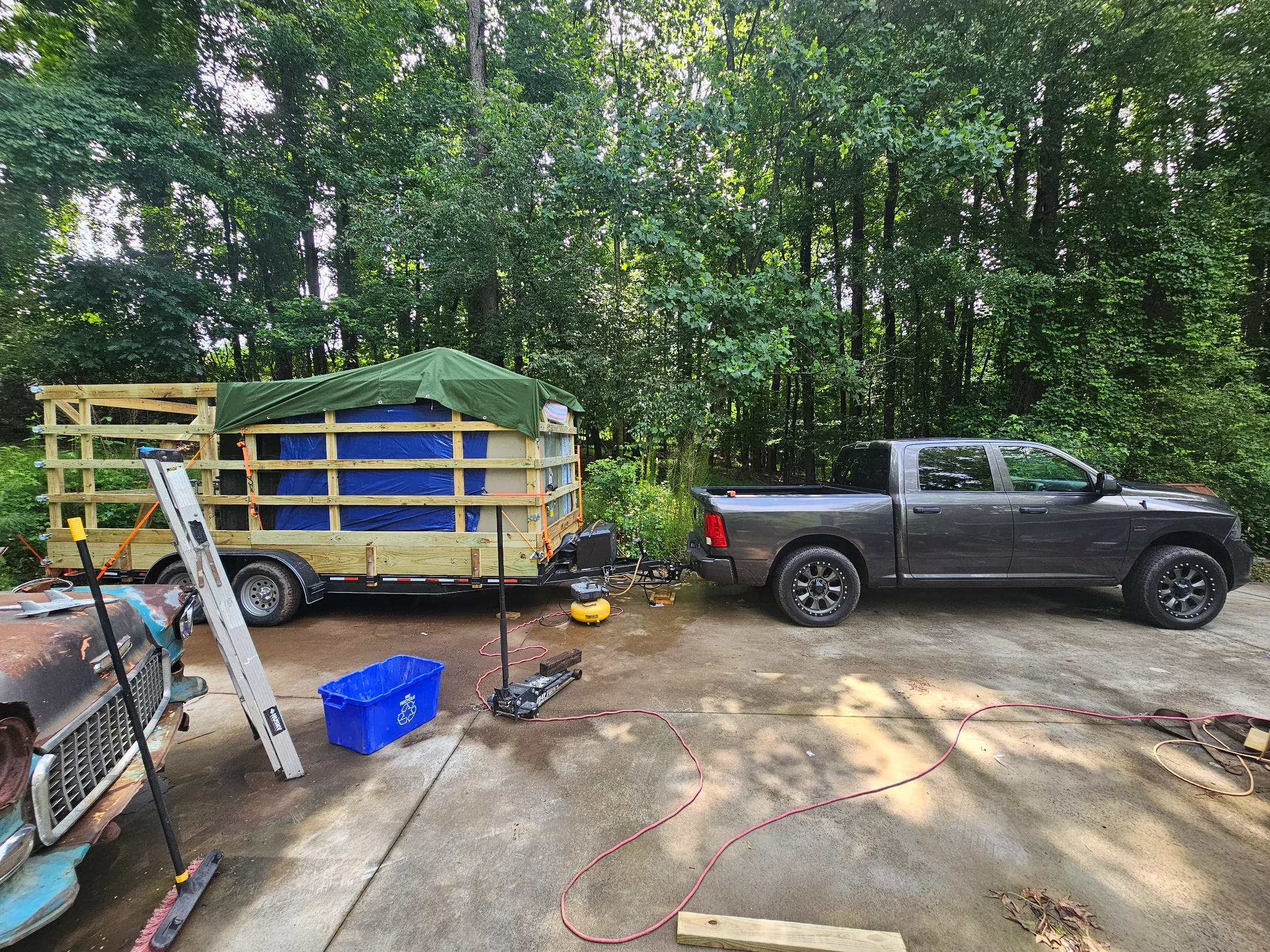

If your truck isn't equipped and you've not thought of it, a pair of bags wouldn't be a bad idea to help with your truck's load capacity. I added them to my truck as well as a cheap Harbor Freight weight distribution hitch for my open trailer and it's made a night and day difference pulling it while loaded. Just food for thought.
For example: this was last year on my move from Georgia to Iowa. I aired the bags to about 35 psi and used the hitch. The first pic was setting it up, the second was obviously after breaking the trailer back down to haul a car (and more).

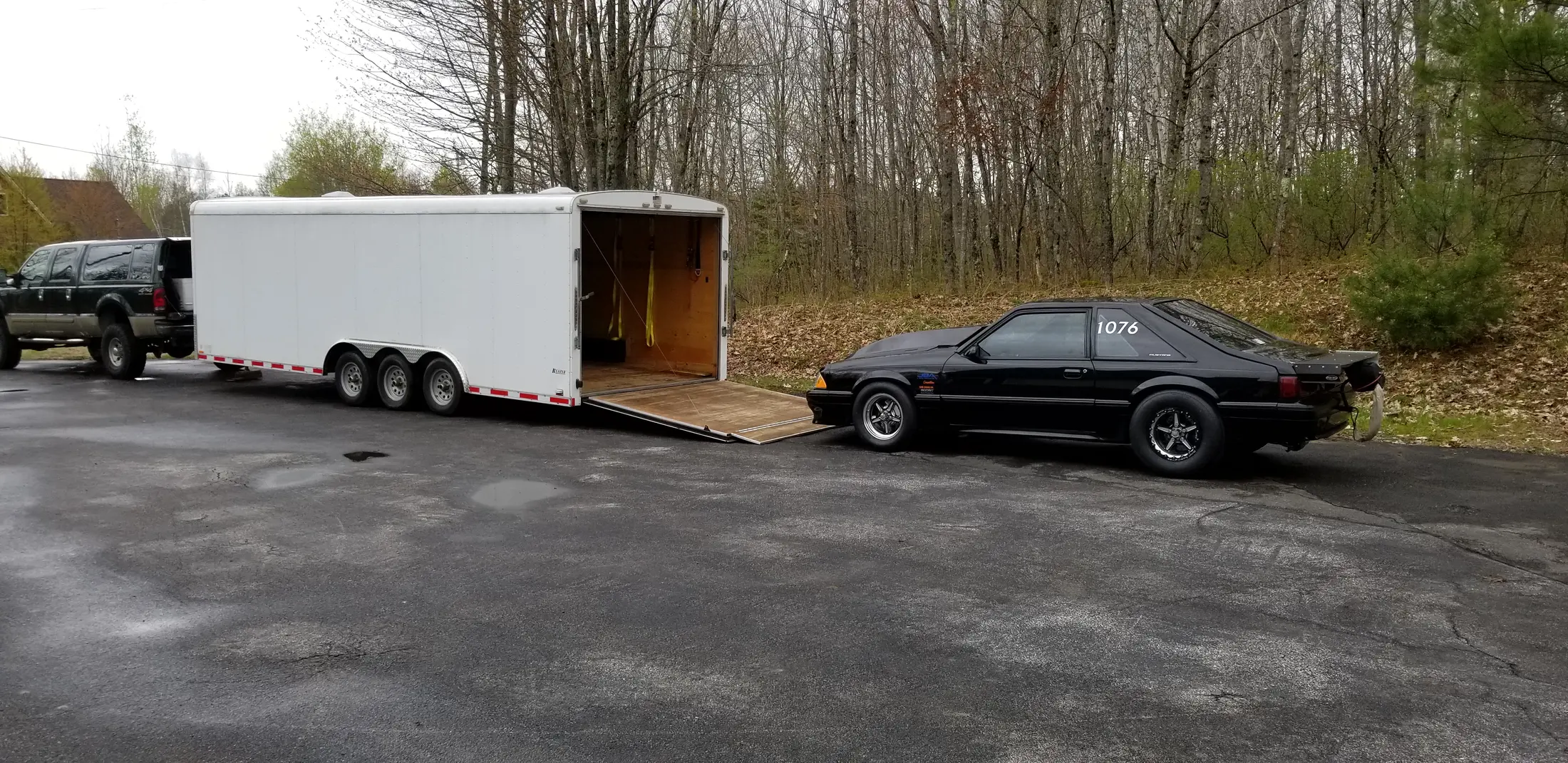

I have a 24' enclosed. After dealing with my friends 20' enclosed with a 93 Foxbody, I decided I wanted a 24' when I bought my own trailer.
It was the best decision I ever made. That extra 4' make all the difference in the world. I special ordered mine so it had 3 axles. I wanted that extra set of trailer brakes. The trailer weighs right at 3,000 lbs empty. (Cargo Mate)
I also have a weight distribution hitch with sway control and it tows like a dream. The car pretty much sits centered over the 3 axles.

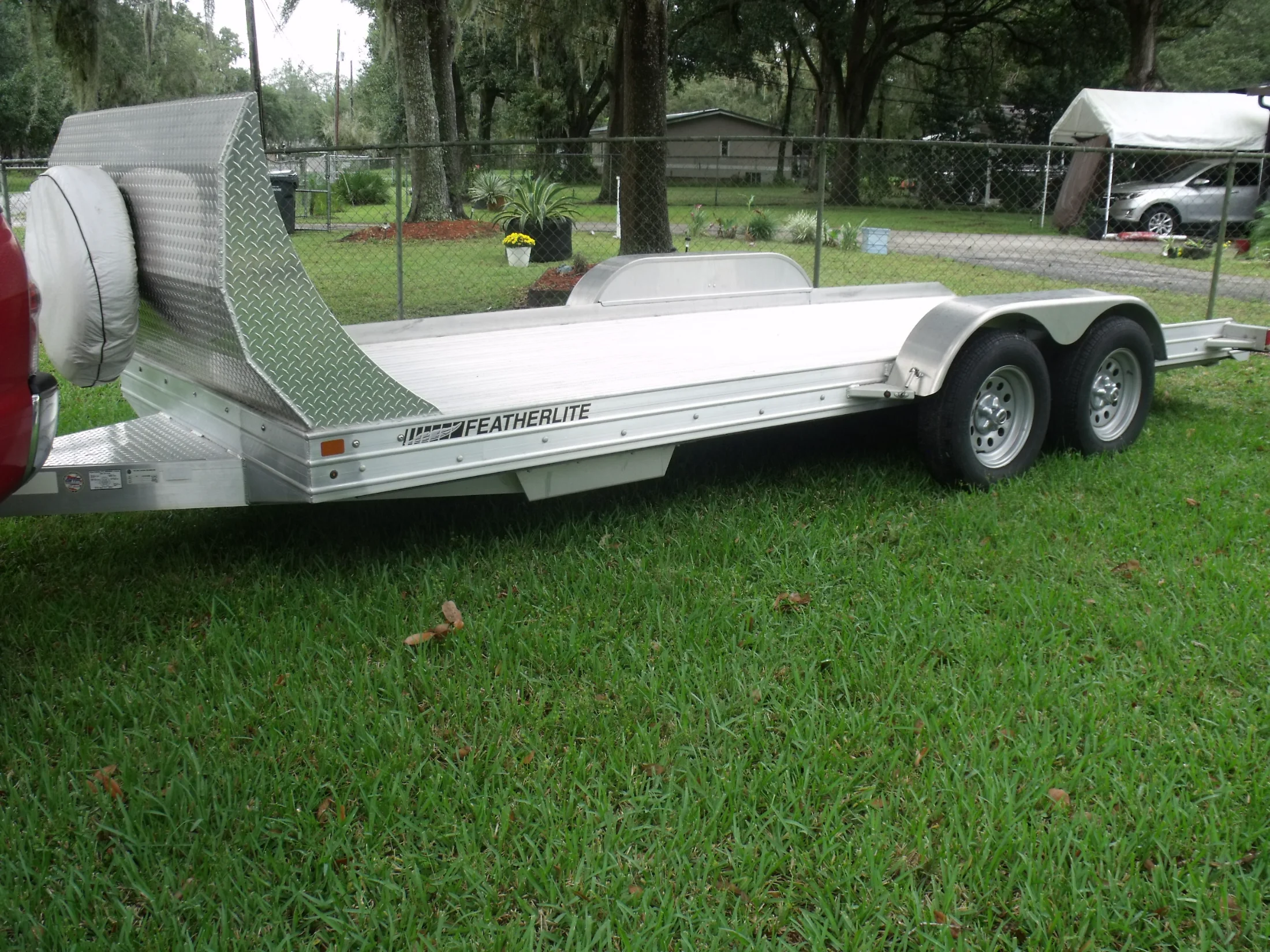

I pulled the mustang with a Toyota Tacoma crew cab 4.0 liter V6, automatic from Oregon to Florida.. I can't remember what the towing capacity was but I was below it using my featherlite trailer...... Don't let tow capacity ratings make you think certain vehicles are good towing vehicles
The reason I traded the Toyota in on a Chevy 1/2 ton diesel... Longest trip I ever made... It had a hard time making it over the overpasses on the freeway...

I pulled the mustang with a Toyota crew cab 4.0 liter V6, automatic from Oregon to Florida.. I can't remember what the towing capacity was but I was below it using my featherlite trailer......
That.... Is a sweet trailer!

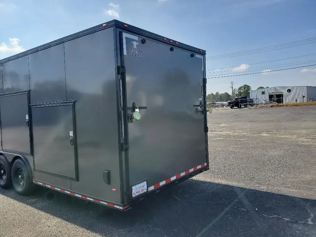

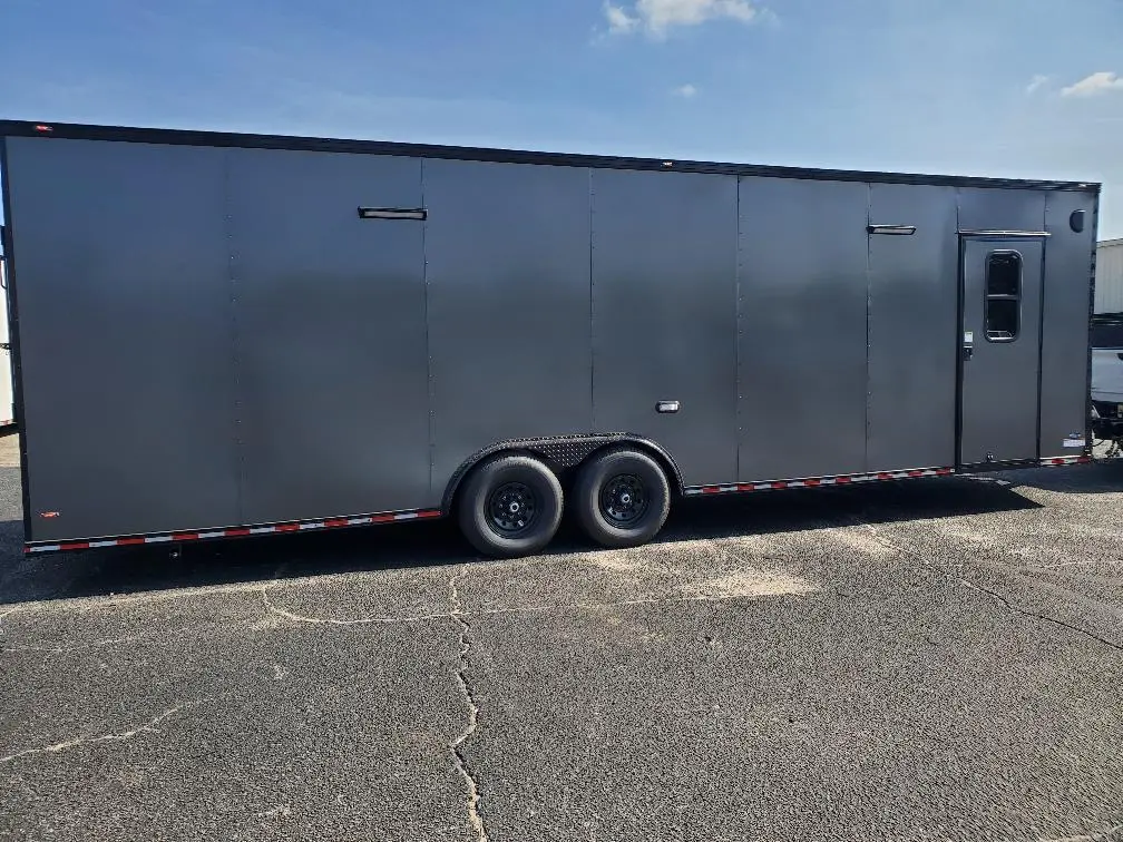

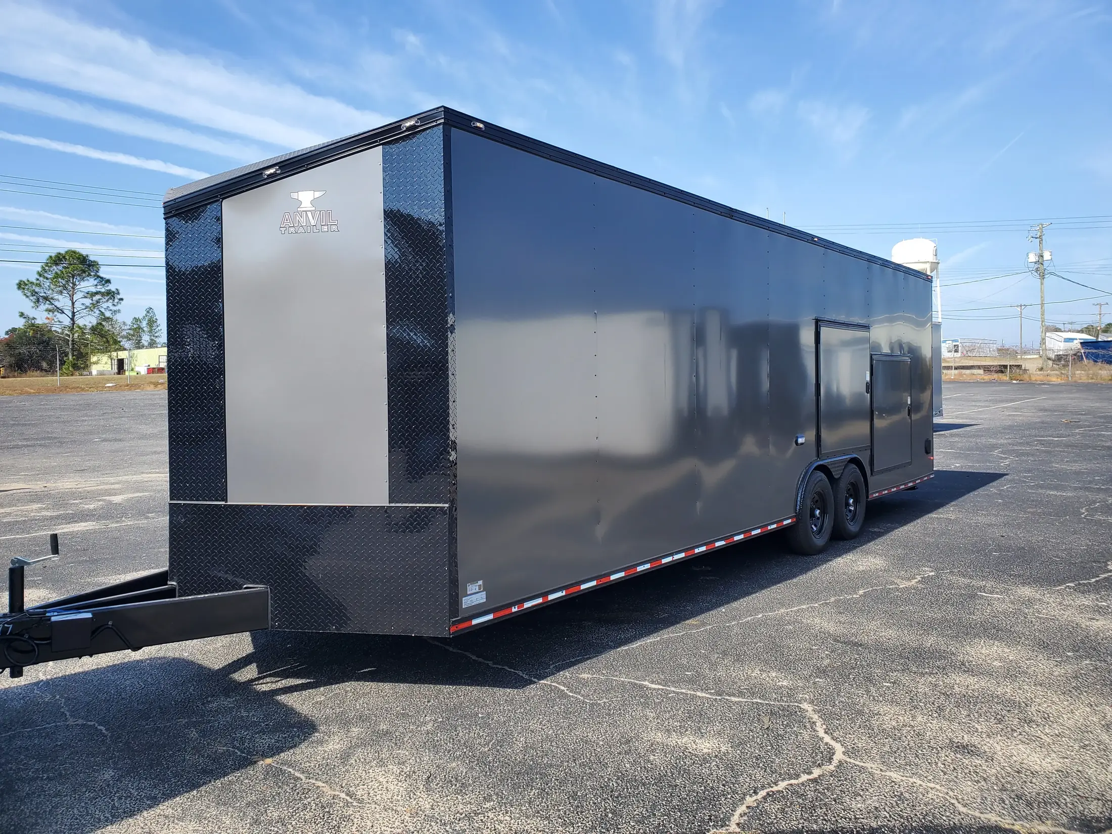

I just grabbed a 28 foot (30 foot with V-nose).
It was a cheaper brand, but built well enough for my needs.
Picked it up in Ga. for the best price. I plan on adding living 1/4's in the front (full bath/kitchen area/fold down bed).
I did buy an extra horizontal window to be installed after "kitchen" is built.
I also grabbed two 4' x 8' extra outside panels, in case I ever bang up the exterior.
Goal is to be able to do track or offroad weekends with no "camper" or hotel required.
I also plan on stuffing my 6K lb full size offroad Bronco in it, so I upgraded a lot (and it is really tall).
I do have a 23 F250 w/6.7 PS and plan to be about 12K total if/when Bronco is onboard.
I went with two large side doors, as I was not sure on placement of vehicles, and it could change with
different vehicles. This was my total build and prices for options, just to give you an idea.
One thing I was surprised at this price point, was axles and even wheels and tires were all
made by Dexter (one of the top supplier of trailer axles). BTW, everyone says they are
going to tow "slow", but I'm glad these stock tires are rated speed rated for 83 MPH
(obviously I am not doing that :)).
They have a price "configurer" you can use to get an idea of what options cost, and
try to compare to any local dealer on price (maybe save a trip to Ga, which was a PIA,
I admit)
