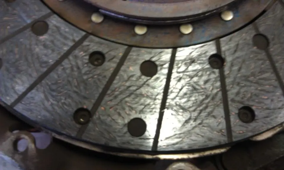

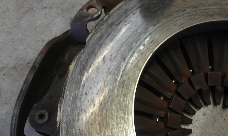

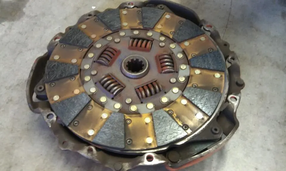

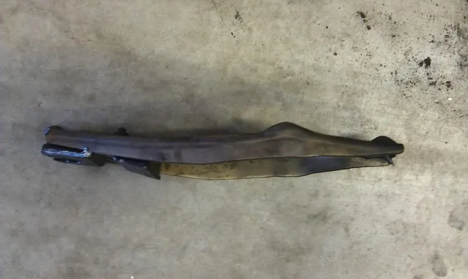

Pulled the clutch today
It looks like its not disengaging, but I can't see why, no broken parts, nothing like that. Im lost. Going to replace the clutch and see what happens.

Yeah, I can't say that I can see anything wrong with it either, but it's obviously not diesngaging. The springs look like they are in there solid. You don't have a bent clutch fork or anything do you? I don't suppose you have a clutch shop near by do you?
