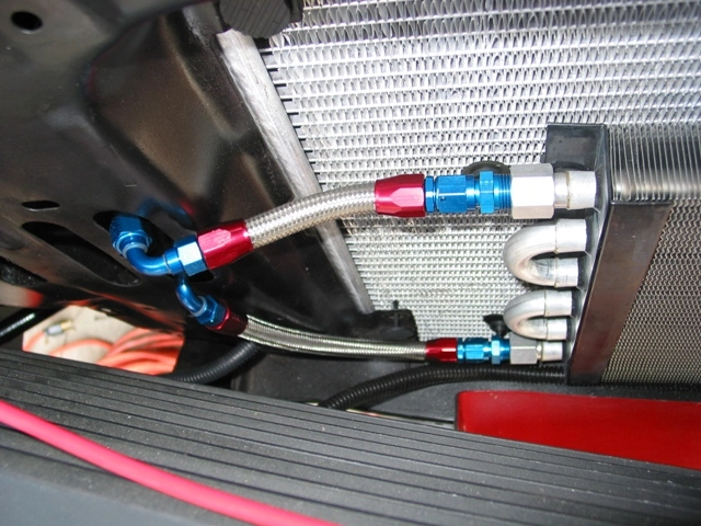

I have a fairly small but efficient trans cooler on mine, it is rated for 27,000 pound GVW. I am not running any ATF through the radiator at all.
