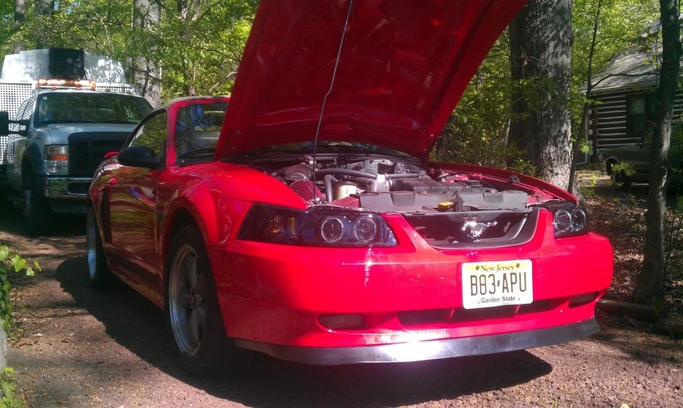

I put just under $5000 ($1000 in hood and paint) to get what I wanted.....I wanted a twin screw over a centrifugal......and I love every aspect of my car.....my future is junk yard 4.6 bottom end rebuild and more boost....but for now I love my car....its driven maybe once a week or so, and still retains full drivability.

P.S. Bob those are sweet halos you got on your 'stang ;)
