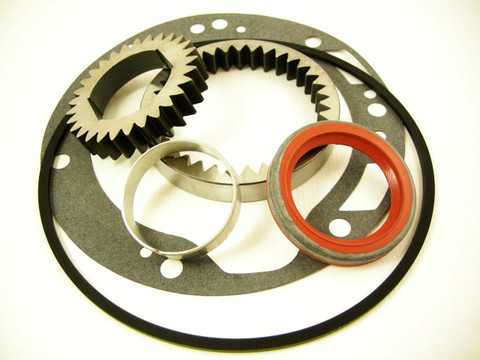

In some of your other threads (I'd consider starting one build thread to keep everything together and easier to find/follow...) you mention that you're in the middle of a complete mechanical rebuild. Has your transmission been completely disassembled and now reassembled? How is the front pump? If the pump housing is still good but there are signs of wear on the gears, you can get a rebuild kit for <$100, that may fix the issue since a lot of times whining is a symptom of problematic pumps.
