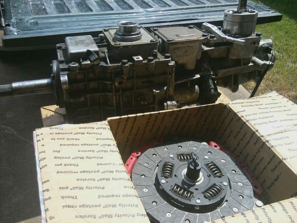

So Im going to buy the following for $1400 this weekend - its used, from a local forum:
Tremec 3550 w/ 26 spline input
Bell housing
Centerforce dual friction clutch, press. plate and flywheel
Tri-ax shifter
Aluminum driveshaft.
I drove the car it was in today before I bought it to make sure it was all in good order and seemed to be fine.
With the 26 spline input shaft, what will this trans hold? Stock rating is 425 lb ft, but I couldn't find anything else to gauge what it will hold.
Since Im expecting 475-500 lb ft from my 408, should I upgrade the tailshaft too so it would be like a TKO?
Thanks,
Collin
it should be a 26 spline input and 31 spline output already. you have an original "tko" there.
rated for 425 tq with those options. a tr3550 is a 10 spline input shaft and 28 output. rated 375 torque. when you get into the tko500/600, there is more internal modifications making it stronger.
it is not just the input/output shafts that are different. you can give tremec a call with the dog tag number. the number will start tr3550 space.. then a number.
that number there will tell tremec what you have. that number you have should be a lower digit. the "tko" i almost bought which was advertised and looked like a tko600, was not. ie; the input output shaft count. people try to pull that **** all the time and they are original tko's.
tremec rep told me a true tko500+ number starts at like 6 or 7 after the tr3550. goes up to 12 for all the models.
Uploaded with ImageShack.us
Yep, its a tko: PN 2600708. I got the tko, tri-ax and new ram clutch for $950. Not a bad day...
