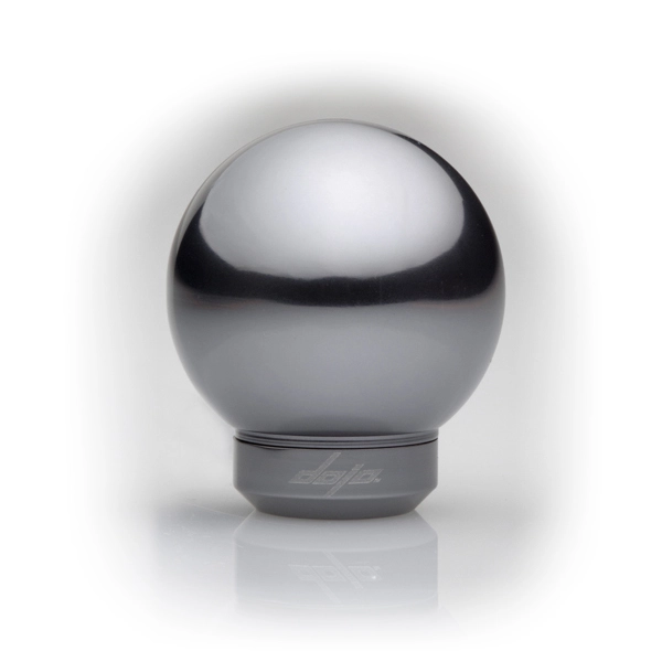

I really like the stock knob. I had a Dojo Performance knob on there when I bought the car, and I switched out to the stocker.
Keep forgetting to put the Dojo for sale...I'm sure someone with an import will buy it.
