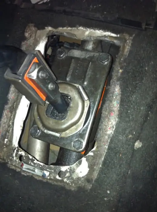

also, I guess when this car was converted to 5 spd the previous owner wasn't very careful in modifying the opening in the floor...was it necessary at all to mutilate it this way? Any ideas on how I can fix this? maybe weld in some metal and recut the hole? my car had no metal trim piece around the shifter base and no inner boot. would it go on ok with my floor opening like this?
Proper way to fix it is to get the small metal hump installed on manual transmission cars and tack weld ot to the trans hump.
If youmgo to a junkyard and yank the console off a manual trans car, you'll see a small plate welded on the tunnel over the shifter holes that only comes on manual trans cars.
95% of 5 spd swap guys don't install this plate...myself included.
To fix without the plate, tin snips to clean it up a bit :shrug:

Not sure what you mean by the small metal hump... so without this plate, I'm getting more heat into the engine bay right? Don't mind the noise, just the heat.
No, it just allows the gold inner shifter seal to sit a little higher and seal better.

Mike have fun I was trying to find a pic also. I had one but the link is dead it showed the diff. between the manual and auto hump.I loved using that one, damn broken link.
No.11 the manuals has a small raised hump the rear of the shifter hole stepped up more than the auto's which where more flat..this is the best I can describe w/o a pic. The PO went a little over board on the trimming, you could use some sheetmetal to close it up some, paint the sheetmetal and use some stainless rivets if you can't weld or don't want to. want brand shifter is the other guy selling? MGW is worth the wait IMHO.
