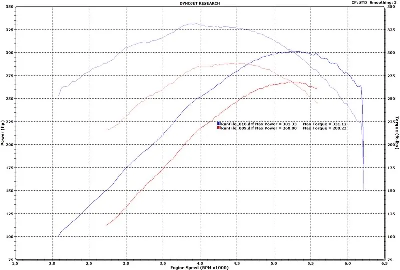

A tune is a good idea, but typically those engines will run stronger than that.
Now, if your elevation was not corrected, I think that can be much of the "missing" power you think you should have.
A tune is always going to help you out, in this case.

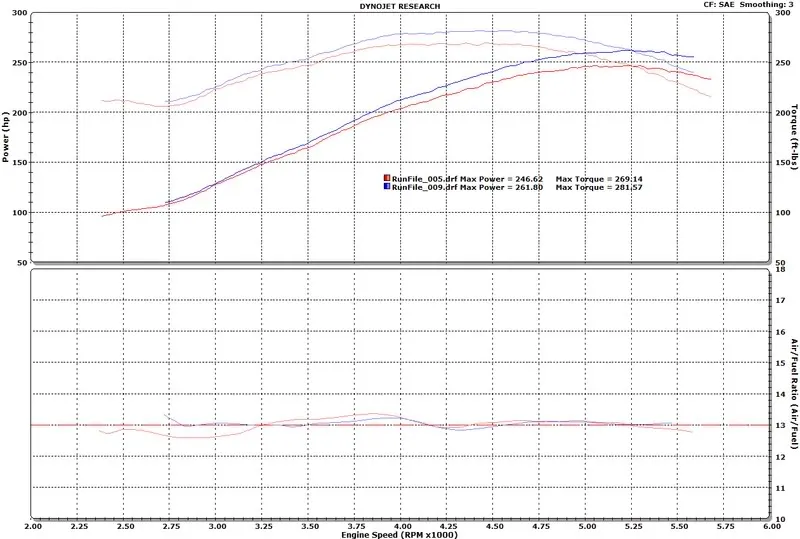

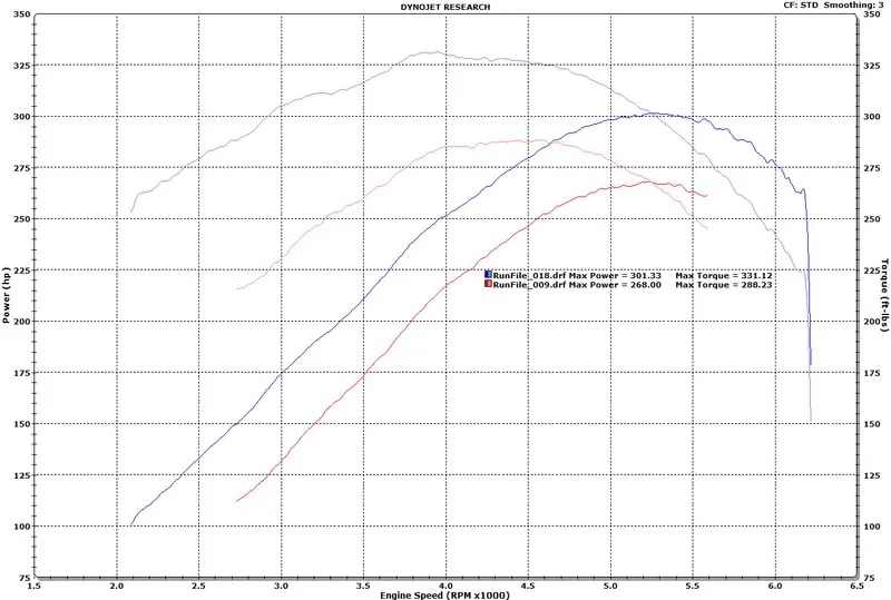

This was mine before a retune,longtubes and a bigger maf.
So you gained roughly 40 RWHP and 50 RWTQ from just those mods?
I'm guessing the bigger MAF and longtubes were only worth about 15 of that. Leaving the other 25 RWHP gain from the tune. Pretty impressive.
I'd love to get rid of the shorties and cat's, but mine is daily driven and has to go through emissions regularly. I didn't wan't to have to swap exhaust every year. And since my car is lowered, I didn't want to sacrifice anymore ground clearance for the longtubes.
Mine is lower with h&r ss vert springs.No issues on scaping as far as longtubes go.Emissions just get a catted pipe for the longtubes.
Actually the maf was worth 6rwhp in itself after tweaking the air/fuel to get it back 13:1
Comparison before and after:
I got a thought or two here :D
Sure a tune would help
but
Similar combos with no tune that made more power are available
If you got high flow cats ...
I don't see them holding you back much ... 3 to 5 rwhp for a ball park value
I believe I've seen it said cats will show around .75 of one point leaner if a
sniffer wb has been used ... but ... my memory is fuzzy about that amount.
however ... I do know leaner results will be seen
I gotta believe something simple is at fault here :)
and
My gut tells me you need more fuel ;)
I feel 24's for an aftermarket h/c/i combo are close to the limit :eek:
and
All the more so at OEM fuel pressure :Word:
The thing someone told you about O2's being in effect at WOT is not true
If you were to reset your pcm before a dyno pull or 1/4 mile blast .....
The pcm would not have had the amount of time it needed to make
changes to compensate for elevated fuel pressure due to an afpr
Grady

Well i agree and disagree..Shorty headers and cats are not the making of a good combo,regardless..Esp on a good h/c/i car.
24's are close to the 85% duty cycle on a 300rwhp combo, i know i datalogged mine with a SNeec.. So i agree bigger is better but are still ok if you are in the high 200's or low 300's.
A tune will always help,because reguardless of what 500 other peaple post,every car reacts different to mods.Even though the ecu is still the same number..Ever wonder why some cars were faster than others even stock..Glitches in the machine..
If i had listen to the 500 different answers i read though on why my combo did not make the power i wanted out of the box.I would have gave up,but instead researched and did my homework..Because 9 times out of 10 ,everyone says you need afr or tw heads to make power.
But unless we know the EXACT details,
fuel pressure:shrug:
fuel pump(fuel filter ever been replaced:shrug:)
timing (total and across the board):shrug:
deck height (5.0's are known NOT to be square)combined with gaskets used
how much the cats are actually flowing(high flow cats have a pretty short life span - 1~3 years tops -depending on the air/fuel mixture speeds this up)
a/f BEFORE the cats
if the cam was degreed in or just installed dot to dot
Hell it could be a dyno operator error,some do this to make others think they are getting a awesome tune by that company.
All this matters.This is just some of the variables in a combo:flag:

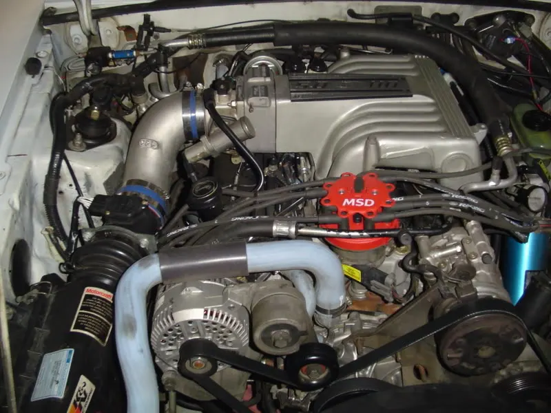

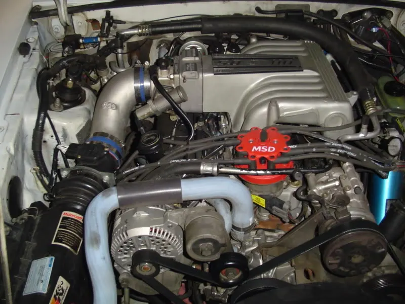

For exhaust, I have BBK 1 5/8" unequal ceramic coated shorties going into a 2 1/2" BBK high flow catted H going into a 2 1/2" Flowmaster Delta Flow aftercat. I can't see longtubes and no cats making much of a difference over that. Certainly not 20+ RWHP.
For intake, I have the stock airbox with a flat panel K&N going into a C&L 76mm MAF meter with a C&L 76mm inlet pipe.
No driveability issues. Car doesn't stall or stumble. It's a little lazy below 3K, but it pulls hard to 6K after that.
I have seen different TFS combinations get near the 300 rwhp without longtubes. But I did see that they all were "catless."
Longtubes will help boost that "laziness" below 3,000 that you speak of. Most of that is the camshaft's position as well.
Mine was fms shorty headers into a o/r hpipe feeding a flowmaster catback . Stock air box into a 80mm lmaf then upgraded to a 90mm lmaf feeding a 76mm inlet pipe.
Mine ran great besides a stall here or there.

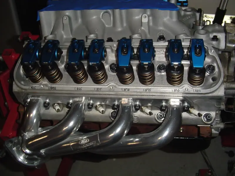

Not my car,just letting you know there is power on the table..On my own i seen a big increase -posted the dynos to show you ,on my 99 longtubes netted me 15rwhp over shorties on a stock 4.6(which has less cubes than the 5.0)..SO im two for two on longtube gains on two different stangs.
I agree, ive seen some cars make close to 300rwhp on shorties but like i said before there are freaks out there,where everything just is at the exact tolerance when it was built.
But if longtubes dont make a difference why then do all racers use them,even the factory stock guys?Esp since most say they only help down low..:shrug:.I dont see any of those guys below 4k at the track.
If the combo is right they will help the whole curve..
Also like stated earlier cam timing makes a difference also..You installed it dot to dot..SO if the tolerances of the cam maker ,timing chain,factory key way are off a little(one way or the other all stacked up ) this will also throw off the curve of the engine,because the cam timing is either retarded or advanced.
Degreed mine ,its less than 1/2 degree off..
Im not one of the internet racers and book readers.I have been building mustangs since 86 and Chevy's before that.If i didnt do my research and check with the real peaple making power(i know insiders at ford the company :D) .I wouldnt have the combos ive built to date..Hell at one point i was one of 10 2v's making 500+rwhp ,and the only one NOT built by a shop.
I have given advice ,so have others that is also good,its up to you what you think you should do..
