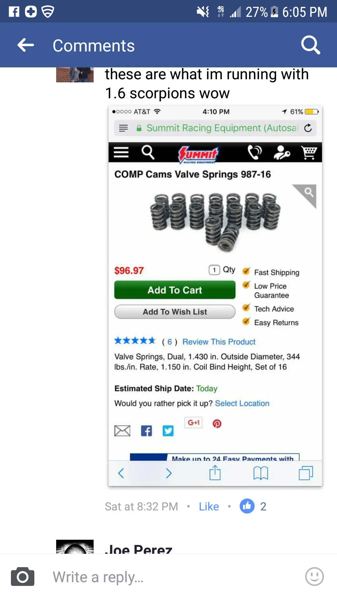

You want to change the springs- regardless of the cam. Explorer springs are weak and those are 20 years old. You want to match the springs to the cam you end up going with. I would also have the heads magnagluxed before you invest dollar one in them- no sense doing anything with cracked heads. If they check out, do the springs, also new valve seals and make sure no bent or burnt valves. Have them true up the head surface a bit and hot tank them. If it looks as if you are going to end up spending more than $400 to $500 on the heads, don't do it. Save up and get a set of TFS 170 or AFR 165 heads.

As far as the springs go, I had one guy tell me I should use cran cams spring and scorpion 1.6 pedestal rockers if im staying stock cam. Here is a pic of the ones he was suggesting.
