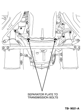

    NOTE: INSTALL NEW SEPARATOR PLATE TO TRANSMISSION BOLTS IF MISSING OR DAMAGED. (FIGURE 1)
    Figure 1 - Article 09-18-16
PART NUMBERPART NAME
8R3Z-7007-B Separator Plate
W500231-S439 Bolt
