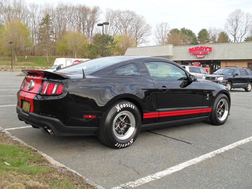

28 x 11.50 -15LT on a 15 x 10 wheel. Run 30psi on the street, 12 to 15psi @ the track.
