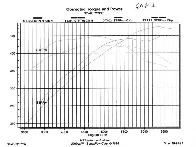

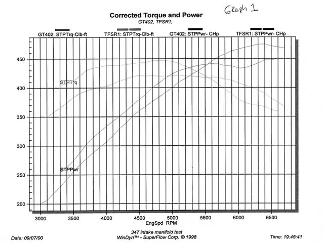

Muscle Mustangs/Fast Fords super intake shootout
GT-40 vs. TFS R
A number of things are obvious from this graph. The first thing is that the TFS R made a great deal more power than the same motor equipped with a GT-40. Though 25 extra horsepower is nothing to sneeze at, the extra power was only available after 5500 rpm. Up to 5550 rpm, the modified GT-40 showed some pretty impressive gains from 3300 rpm all the way to 5550 rpm. Time and time again, the GT-40 continues to impress, though the TFS R intake clearly made more top-end power on this high-revving 347.
This is a dyno of a gt40 vs a tfs r intake.

Portings not an option because imo it would be money wasted considering I already have a better intake. Also that graph wouldn't really apply here because I have a track heat which has longer smaller runners than the R.
the real question is how high do you spin your motor. If its less than 6000 rpms the GT-40 will make more torqe and close to the same power up to around 5500-5700 then the TFS will take over. lets face it, your engine sees far less time above 5500 than it does below. Now if you revi it past 6500 regularly then I wouldnt even think about it. I have a ported GT-40 and a Victor 5.0 EFI. I was going to use the GT-40 over on my 347 but it will run to at least 6500 soI got another intake.
the above test was with a 347 with AFR 185 heads and a 292 advertised cam.............here is a 347 with AFR 165 heads and a mild 258 cam........
Seems trhe GT40 even in stock condition was a great intake..........
