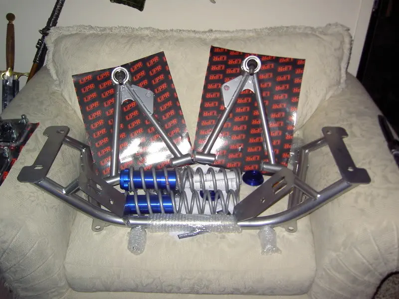

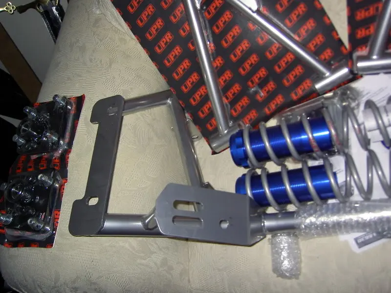

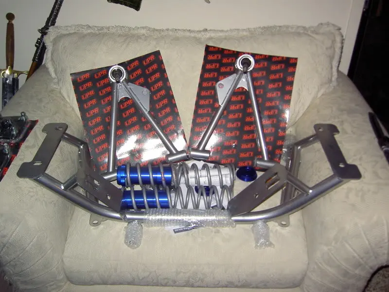

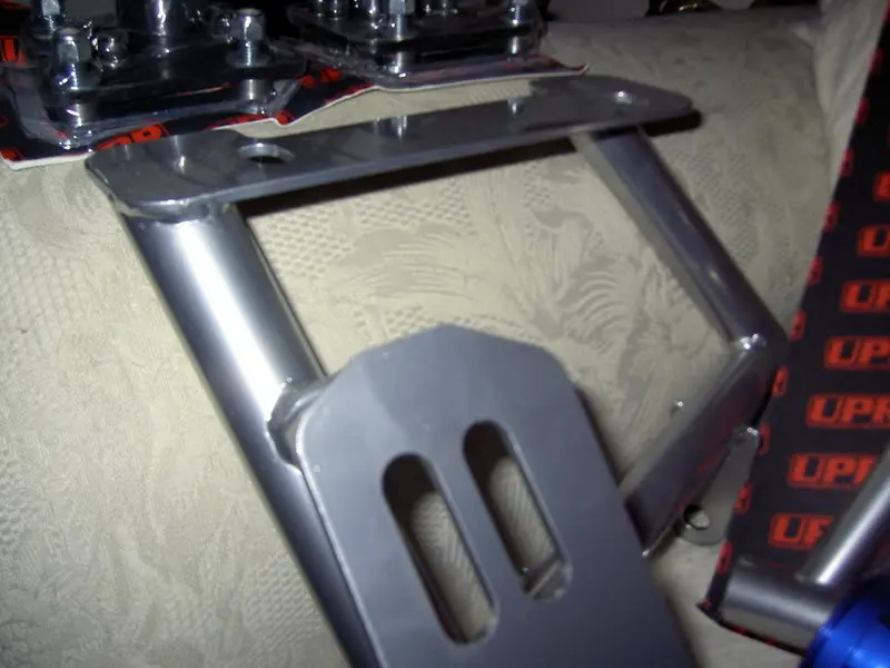

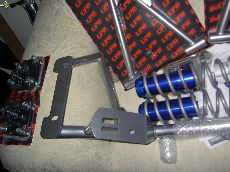

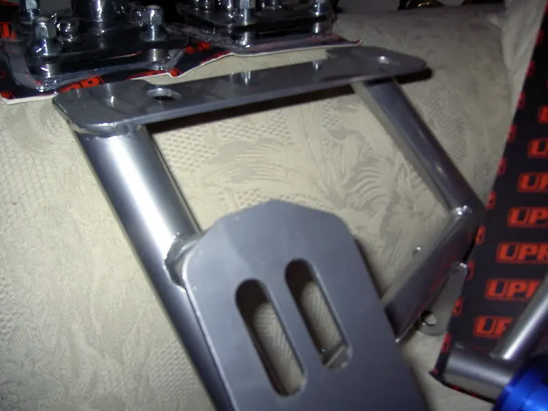

UPR one is sitting on my couch and looks like a high quality piece.... Actually I'll dig up pics...
*EDIT* NOTE UPR changed their K-Memeber since the above linked thread where people had issues.
