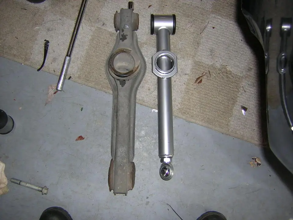

Fwiw i have UPR tubular lca's and they are great. Heres a pic
They look quite a bit shorter... Did you have to spin the adjuster out far to get them to bolt up? I would be leary of that bolt snapping if so...
