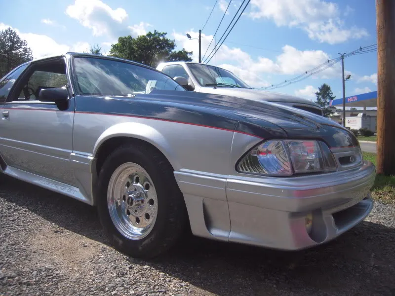

Teaser. Too bad I don't have two draglites for the back. This car looks way better with black wheels IMO.
