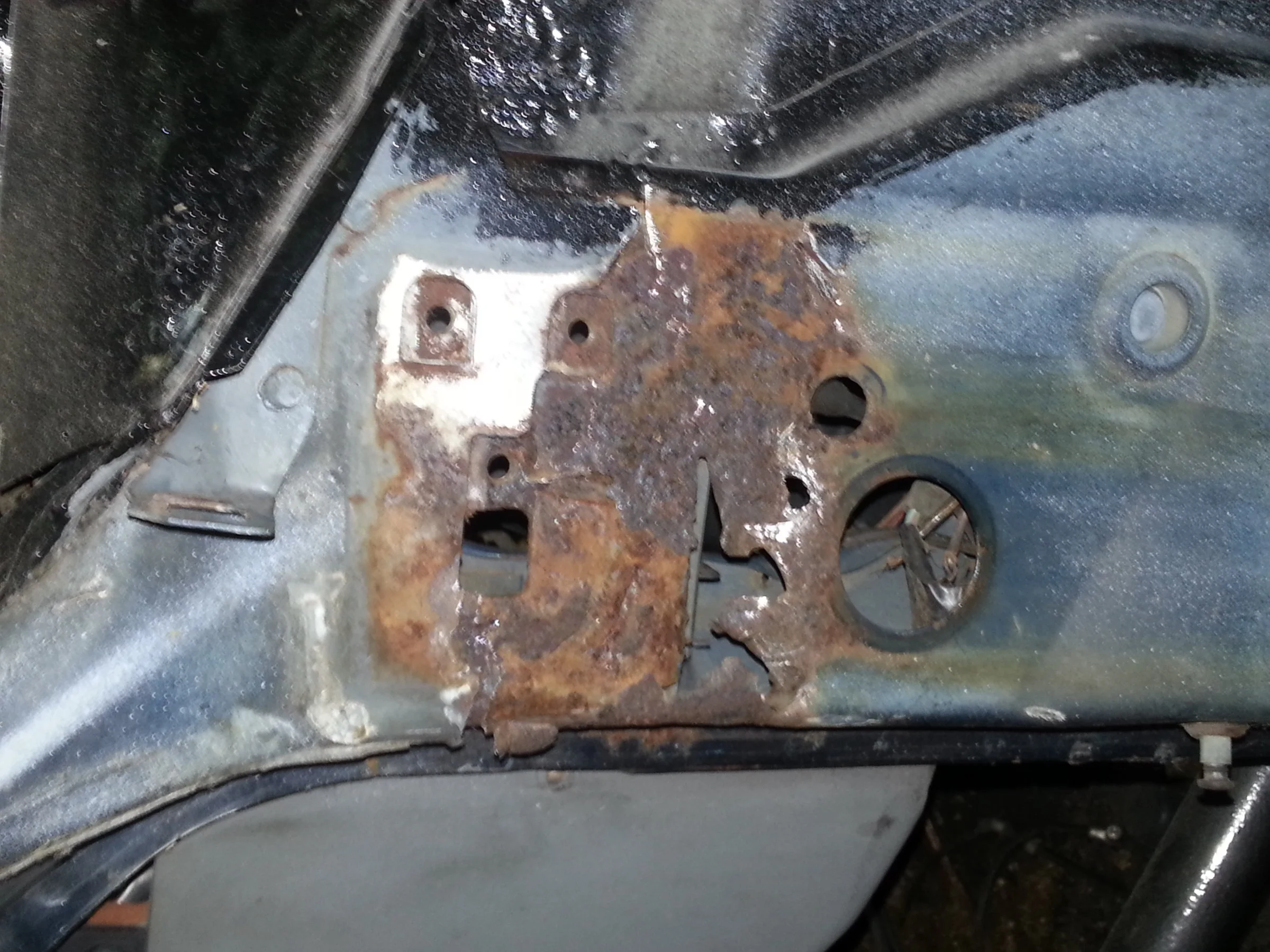

Unfortunately I lost a years worth of pictures of my progress on the car. It was a pretty rough stock car when i got it. It had pretty bad frame and shock tower rust, but I decided to save it. It was going to be a stock driver but once I had it apart to fix the rust it kinda grew into more of a race car. I'm 19 and this is my first mustang so any input or advice is appreciated.

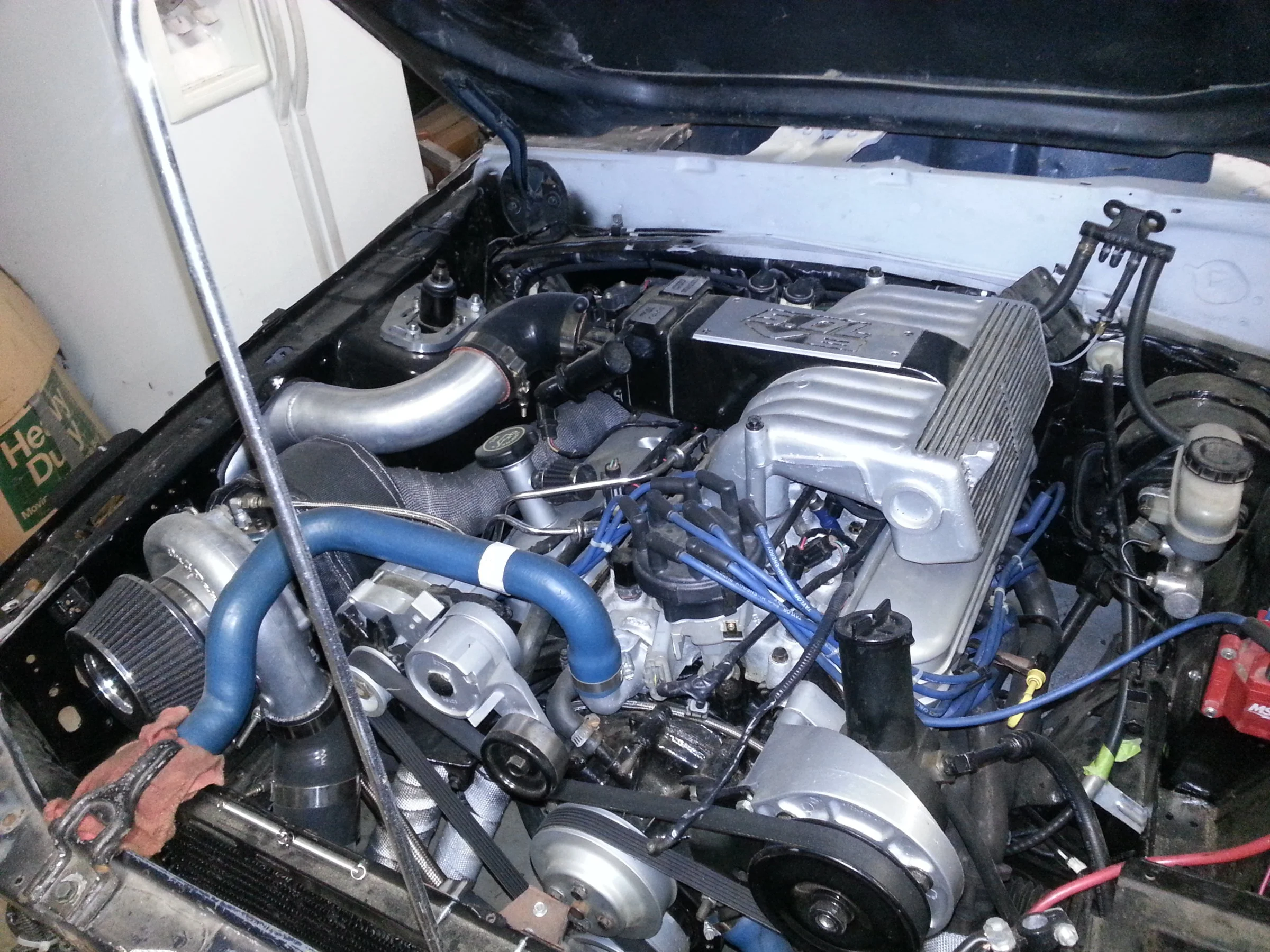

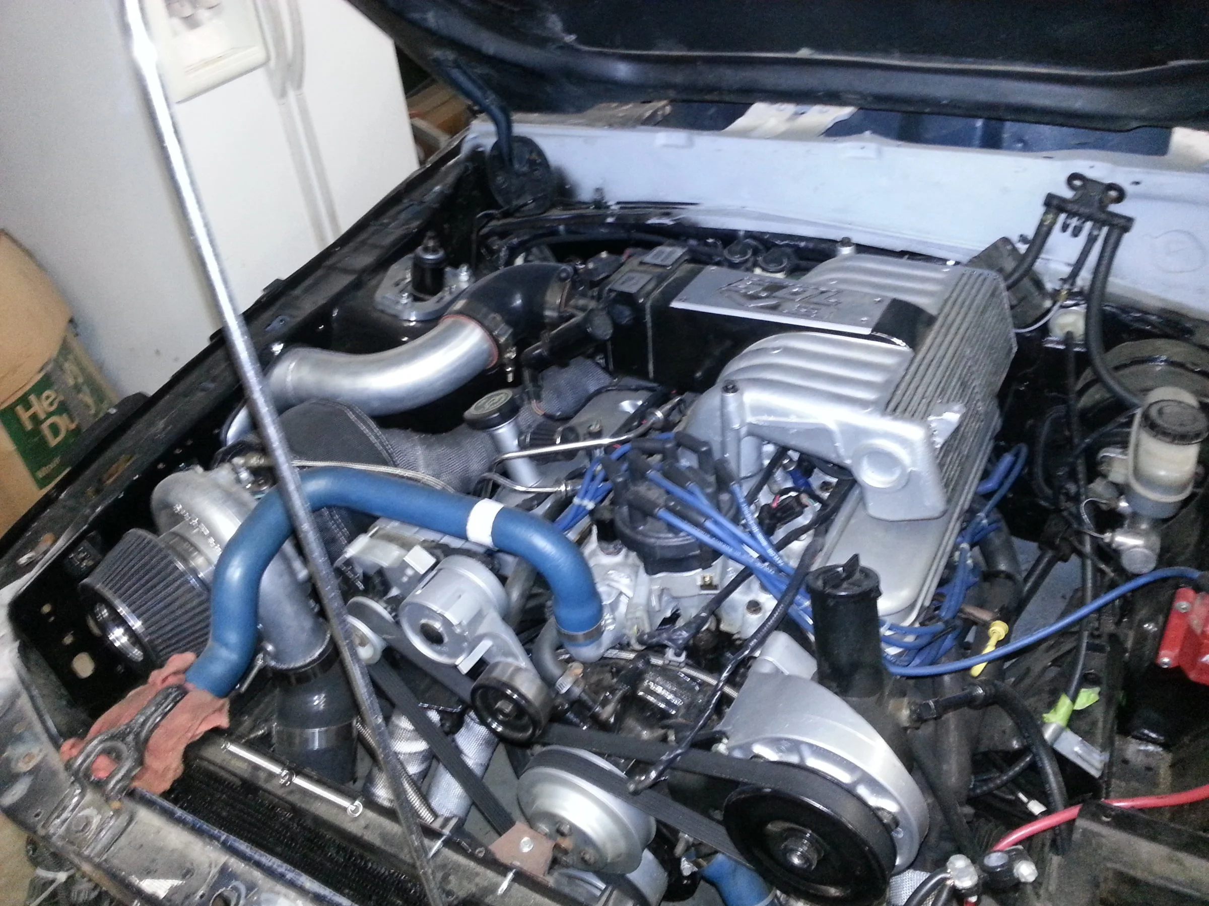

Here's how the engine bay looks now. I'll add more pictures later

Great progress so far. Congrats on it. And good luck on the T5 staying together lol. If you truly take it easy on the trans it will last for awhile. Looks like you did a good job on the engine bay. Post more pics as you go and keep us updated and welcome to Stangnet!
I used the 76mm because I had it already. I would have went with a smaller one otherwise. I made the hotside out of 2.25" to try to help it spool a little better. If I can find a tko transmission I would go for 450rwhp.
The fuel system now is a 255lph fuel pump, stock lines, stock fuel pressure regulator, and 39# cobra fuel injectors.
I used a 70mm maf from a 93 cobra. And it was tuned with a moates quarterhorse.

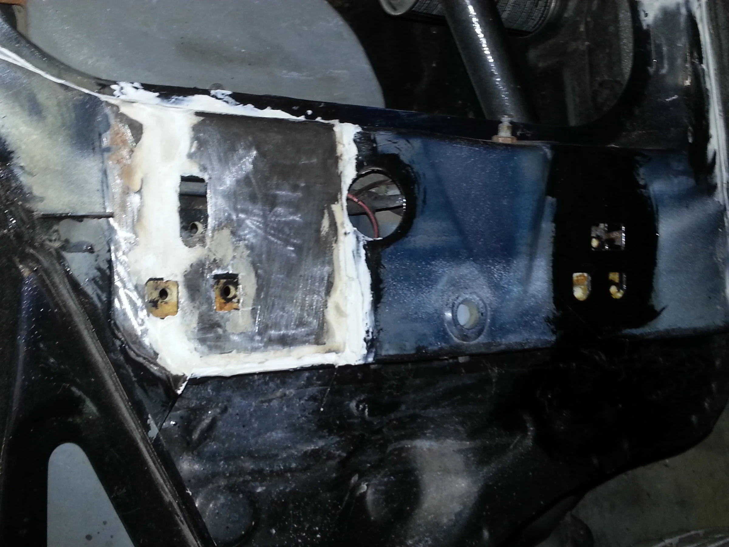

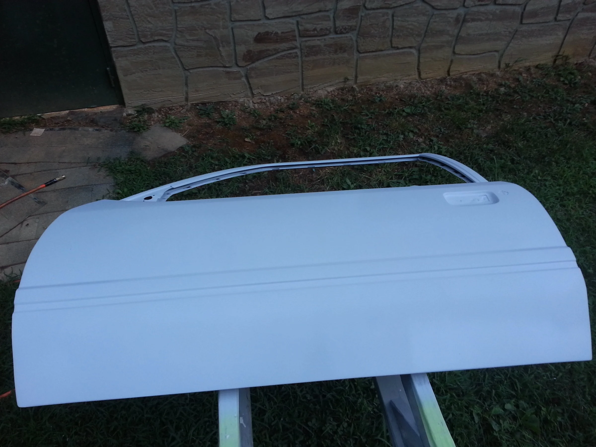

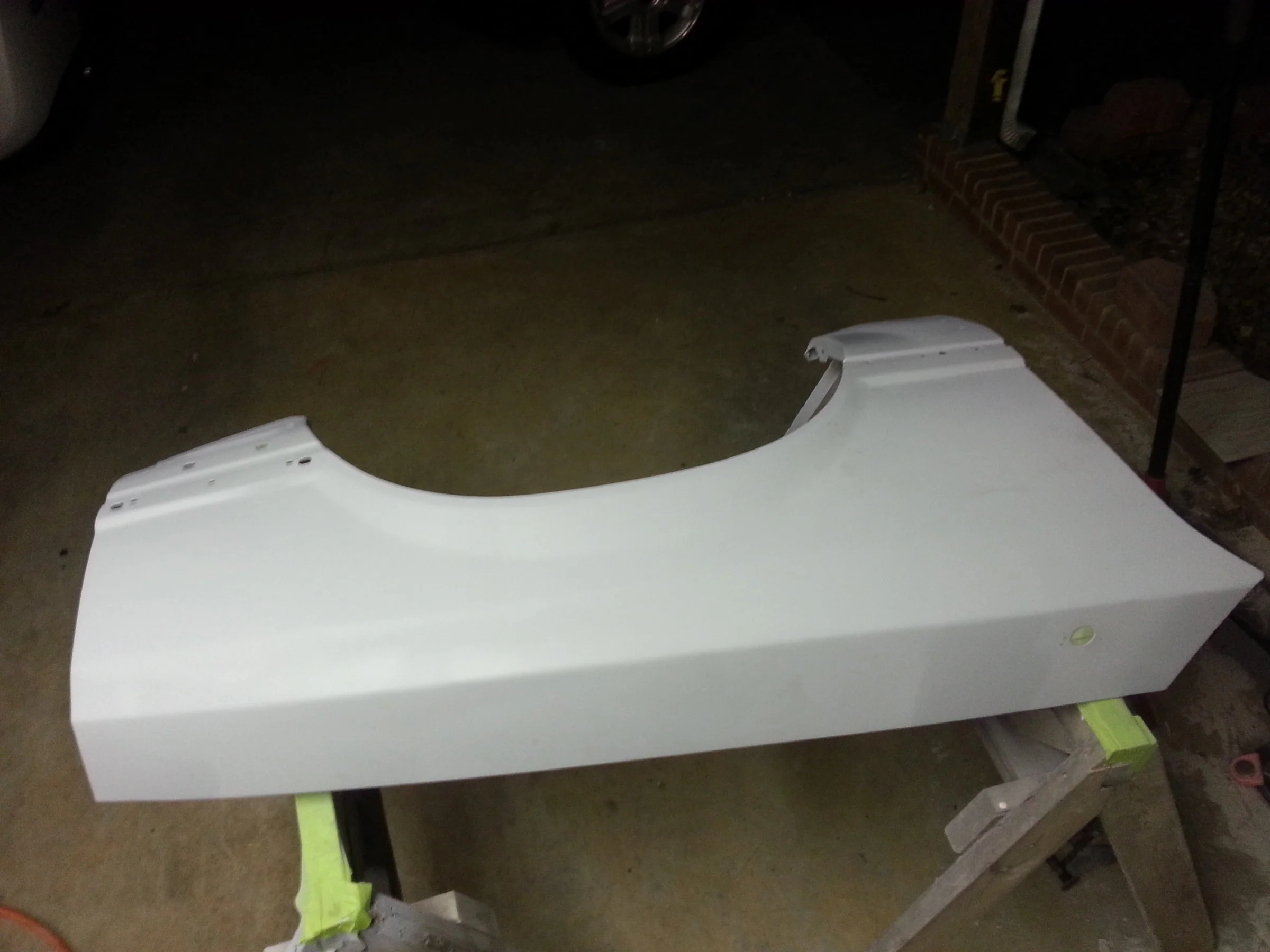

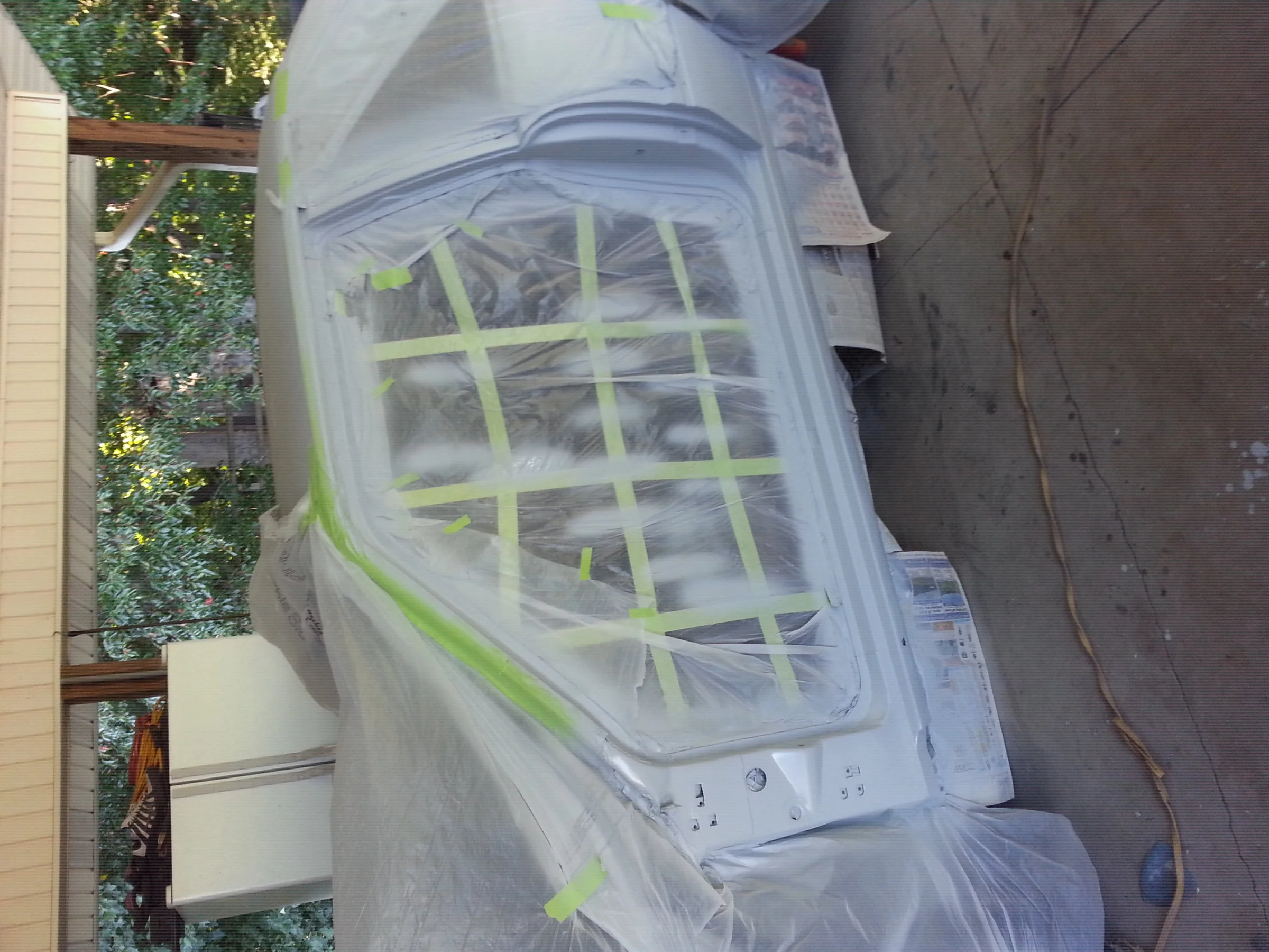

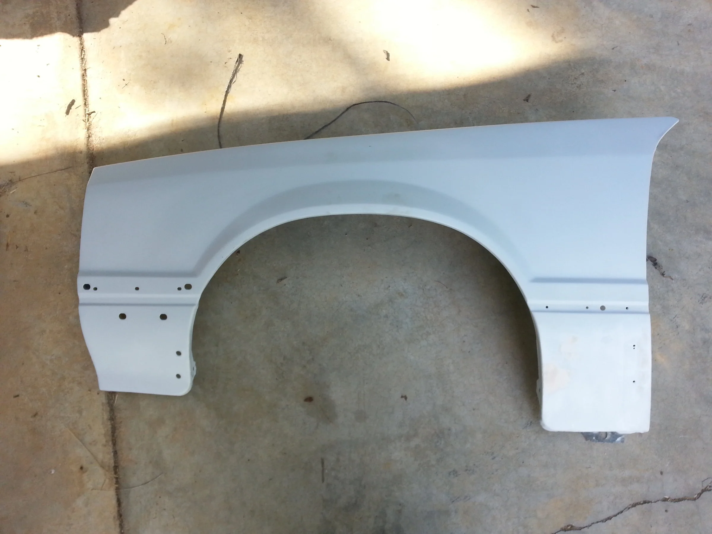

A little rust reapair at the door hinges. Driver's side is done. Still have to do the passenger side. Working on bodywork now trying to get it ready for paint. Thinking about painting it reef blue.
I'll get more pictures of the car tomorrow after I clean up my work area some lol

The turbo should spool fine. What size turbine and housing? Is it the on3 turbo?
Thanks guys!
It is on3 turbo. .96 ar
It seems to spool fine. Maybe a little slow but it doesn't have the final tune on it and timing is locked at 14 degrees

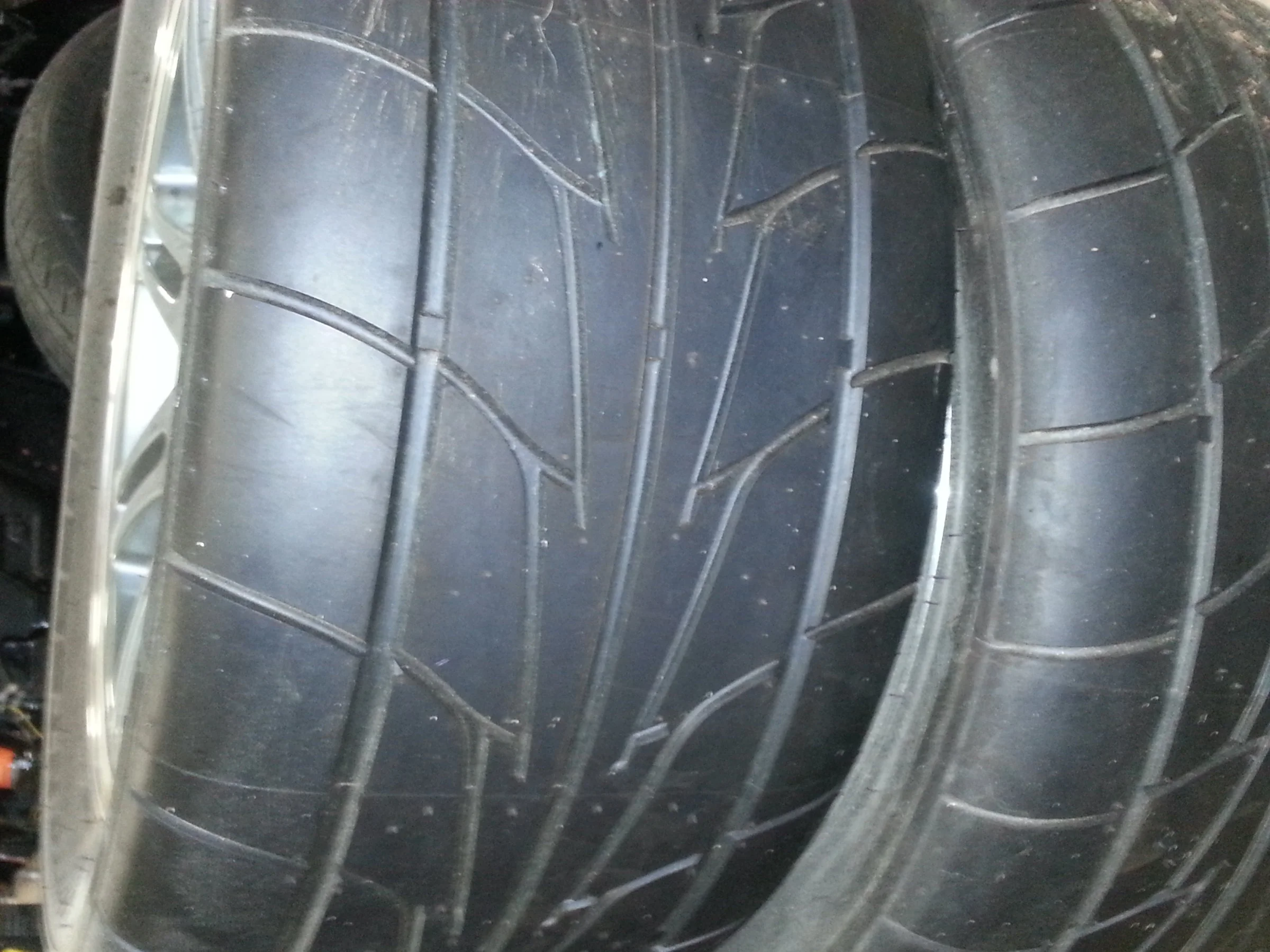

Traction is an issue when it gets into full boost on street tires. But I've got a set of 315 drag radials ready for it.

Killer man keep up the good work. Some pointers if you don't mind - Get rid of the stock radiator. Get yourself a mishimoto or something like that . Also it looks like it has an under drive water pump pulley on it. Id put a stock on back on the cooling system will thank you . If you don't have electric fans and are looking into some - Dorman Ford V6 contour replacement fans for 108 bucks. Make a mount which i can tell you're capable of. Decent controller with a heavy duty relay and you're set. I run them on my with no issue and it makes a decent amount of power. Welcome to the site !
Yeah the underdrives were on it when I got it. I hate underdrive pulleys the cause charging, cooling, powersteering, ect problems for 2hp. Not worth it.

315's, gonna mini-tub the rear end then?
