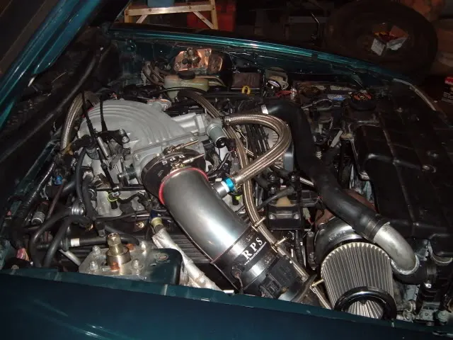

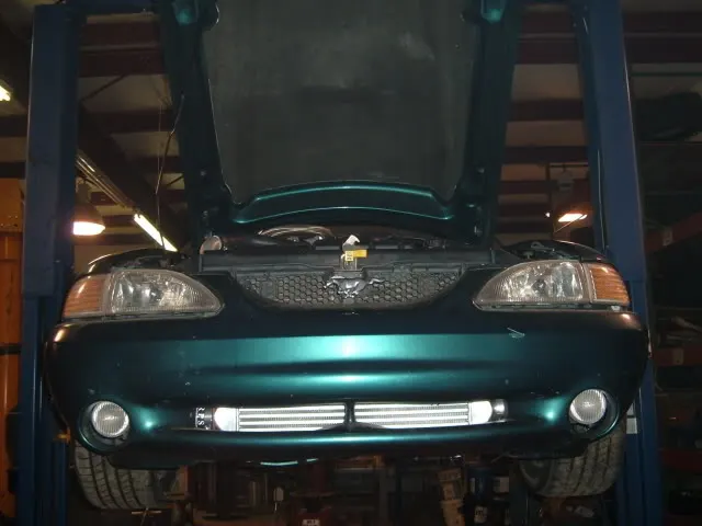

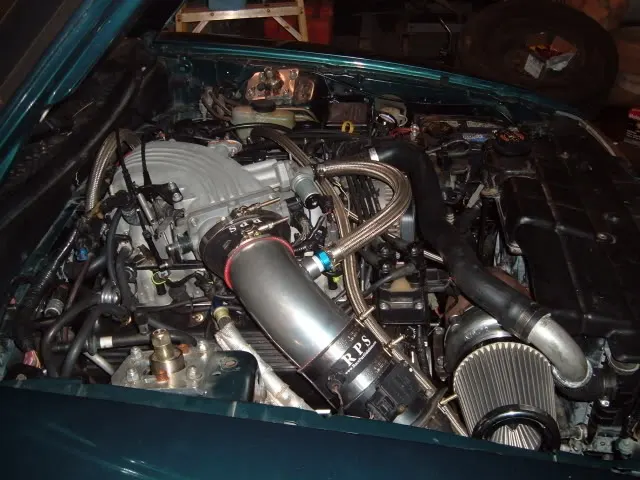

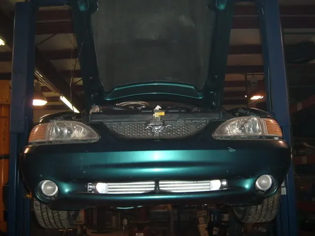

Here's some pics of my Single T-70 turbo 2 valve project i've been working on for 3 months now. We fired it up for the first time last night and it sounds GREAT. Everything is going well except for an extremely low oil pressure (40psi cold, 10psi hot). I believe my oil filter relocation kit is the problem (along w/ tim and 1 other guy) as i'm using -10 AN lines and a FL784 filter ( 5" round and about 7" tall). So thats going to get replaced w/ -6An lines and a FL1A filter, hopefully that'll fix my problems and i can get the car driveable... I still have to finish up the exhaust on it after the downpipe and i'm not sure what i'm going to do. I'm stuck between a single 3" side exhaust or dual 2 1/2" exhaust w/ 99+ cobra tail pipes (for the IRS swap)
and some pics:

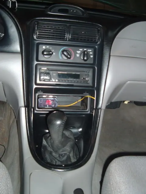

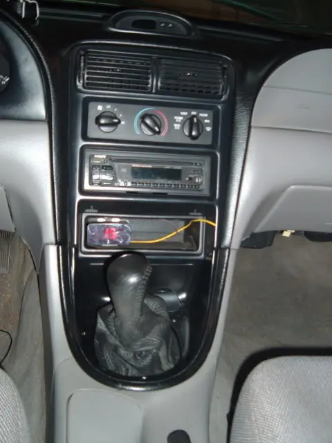

My NGK Powerdex Wideband O2 controller is mounted below the radio on the left side of the "pocket". The boost controller will go on the right side once it arrives.
