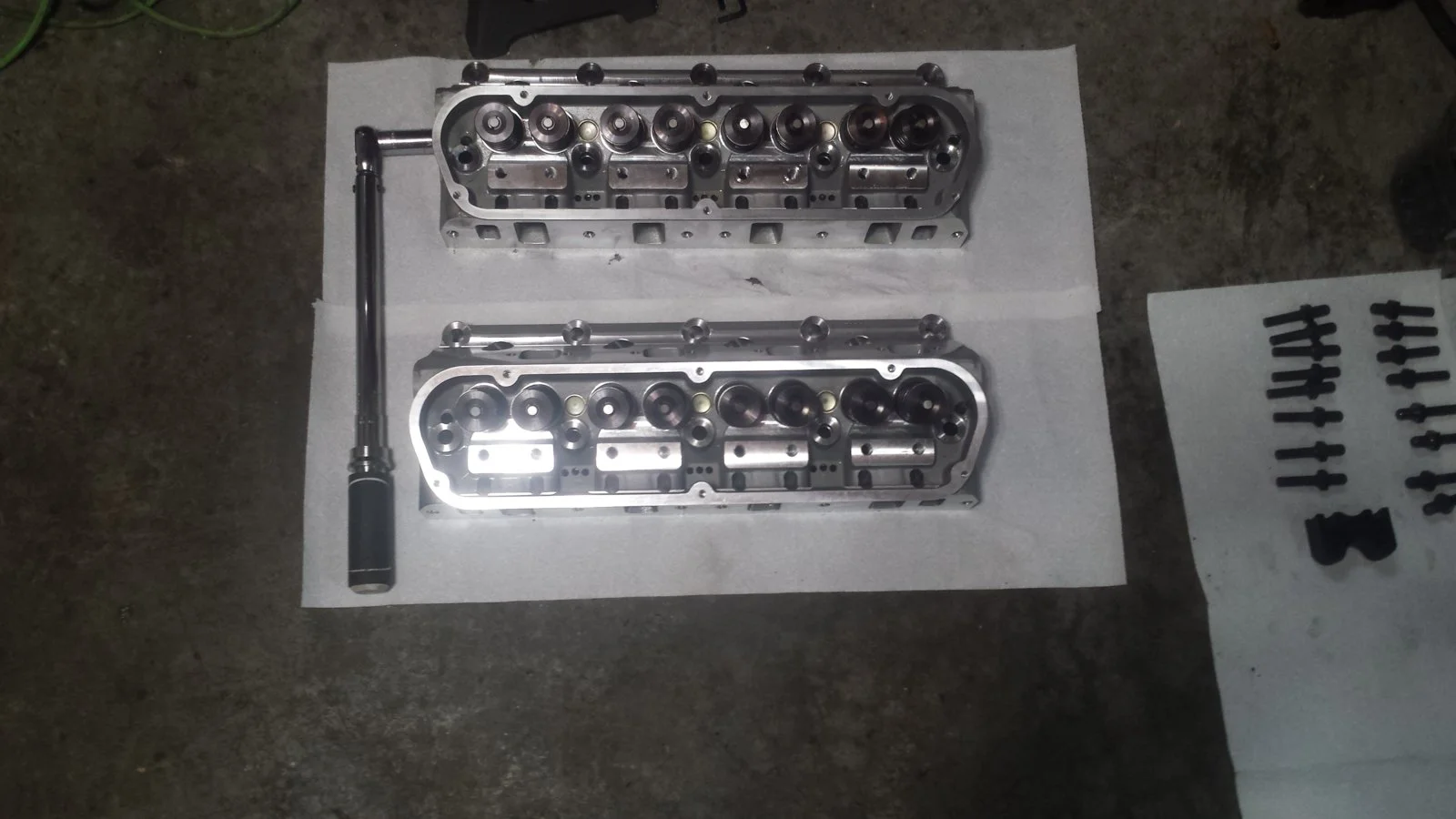

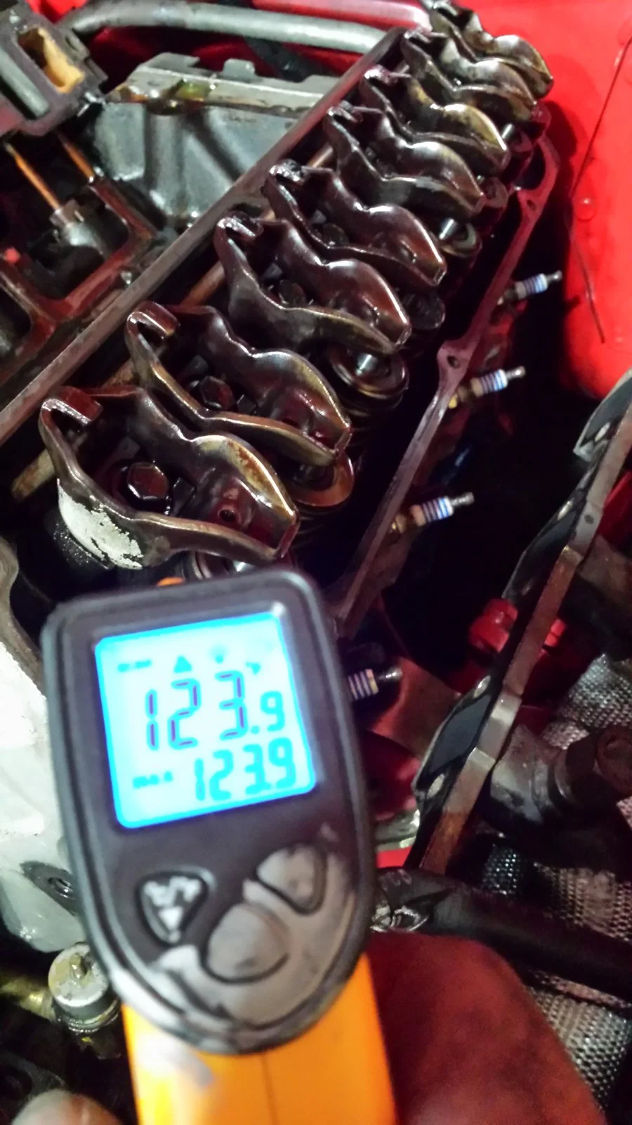

So I blew a head gasket again.. got it running good, over boosted and white smoke. Oh boy did the car feel good at 15psi. Lol
I actually took the car apart so fast the head was too hot to lift off the block.

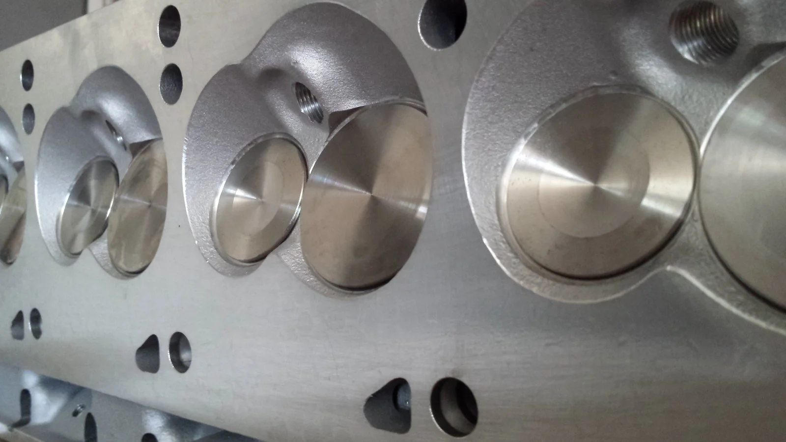

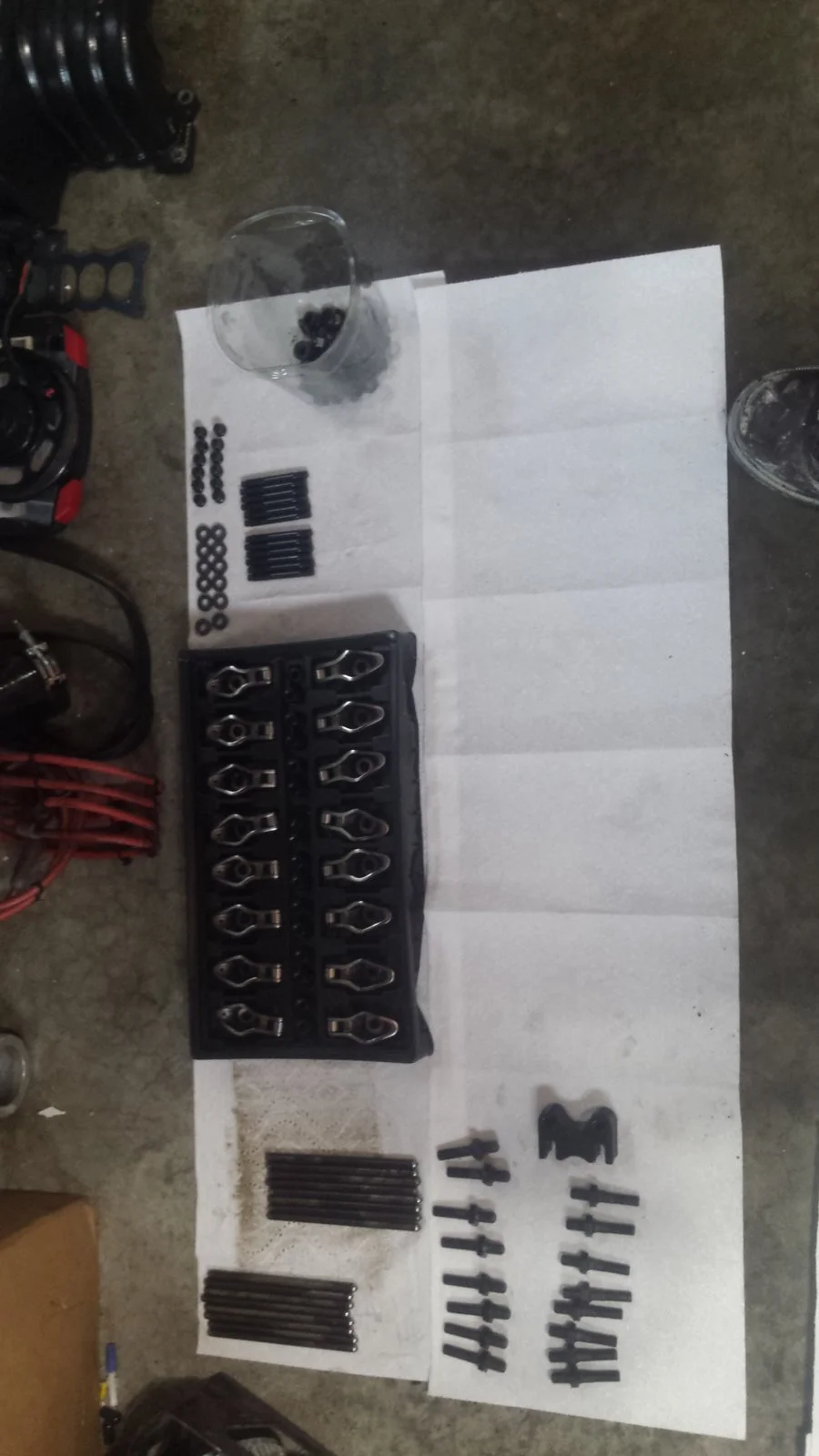

No way was I putting oe heads on again after all that work twice.. so I got some dirt cheep "speed master" aluminum heads hogged out with big valves assembled. Got some 1.7 rockers, and a .08" comic gasket.
Back at the track this Saturday! Any one with any insight on how much more I can tune with 8.3:1 compression/aluminum heads much appreciated!

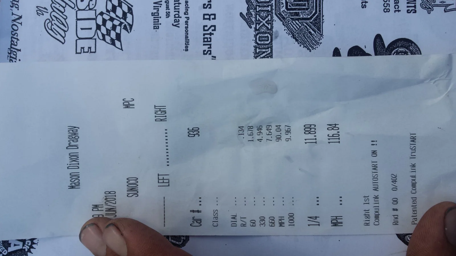

Got some good weather!
Copy and paste from Facebook because lazy:
"It's not an 11. But I'll take that
.002 light.
So went 12.5 topped out well short. traps show 113mph.
I gave it another 100rpm in the tune 1° timing and 10psi. Went 12.2 traps show 116 and again topped out well short of the trap.
Long story short it's not going much faster with out gears and I'm happy with the car.
Video coming soon. It's was a black supercharged boss 302 running me down, and was I'm sure a very spectator-friendly pass."
So I'm thinking the car may have 4.10:1?
I'm pretty sure I got in to valve float on the 6350 rpm pass so I don't want to do that again. Think it's just time for gears.

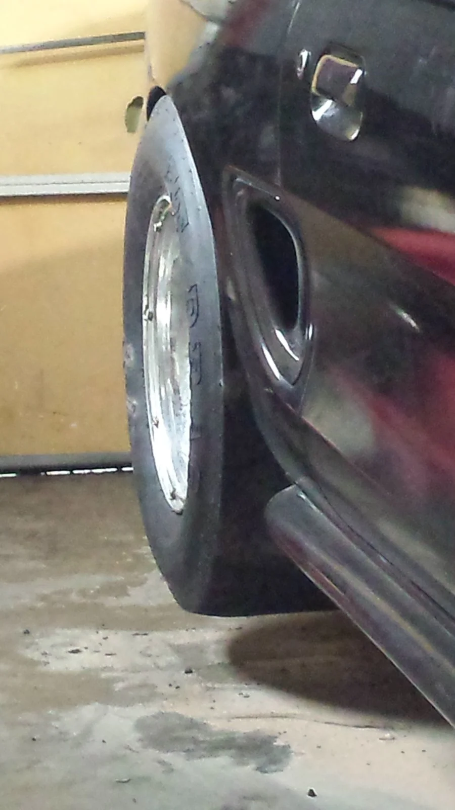

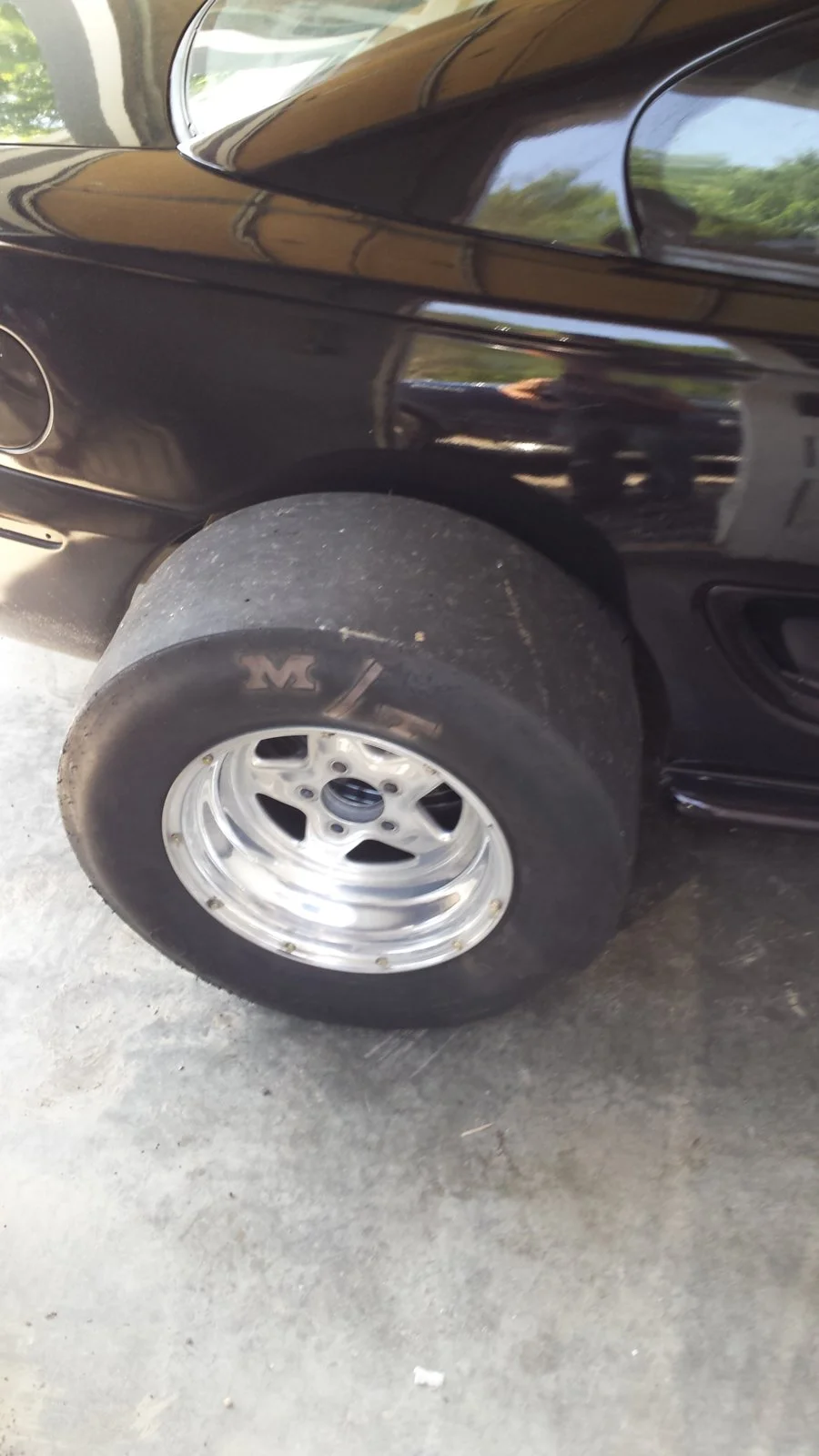

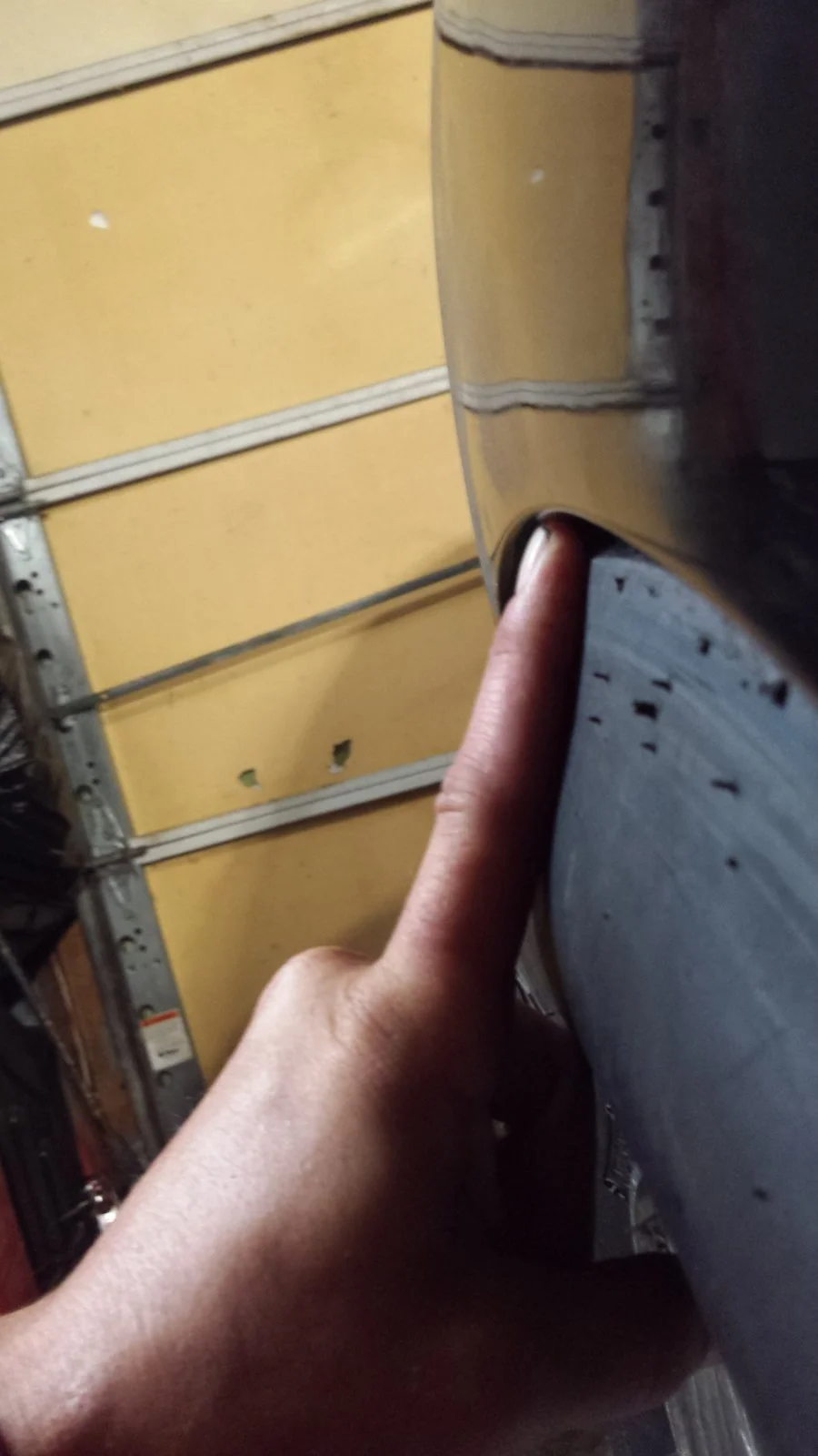

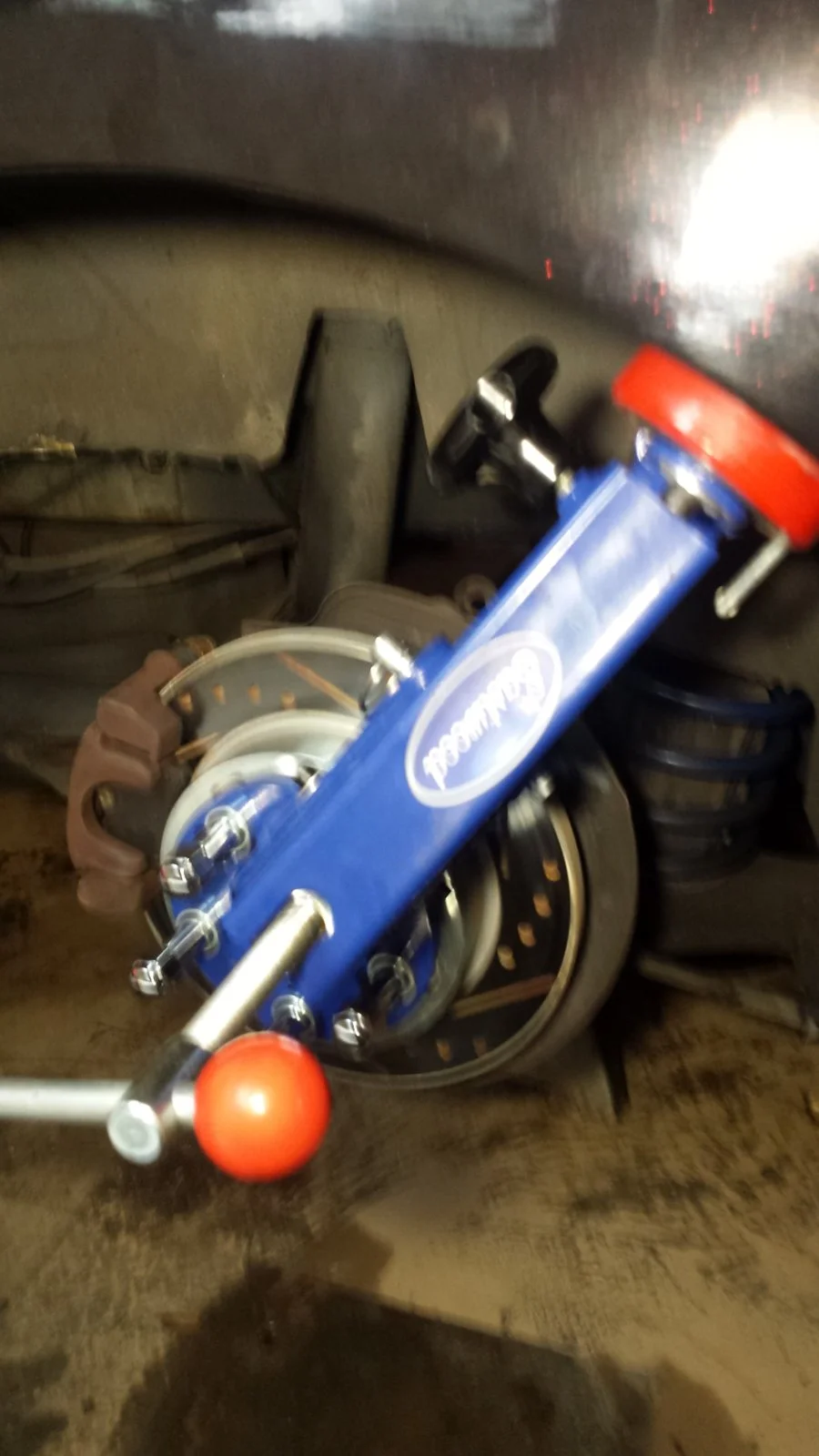

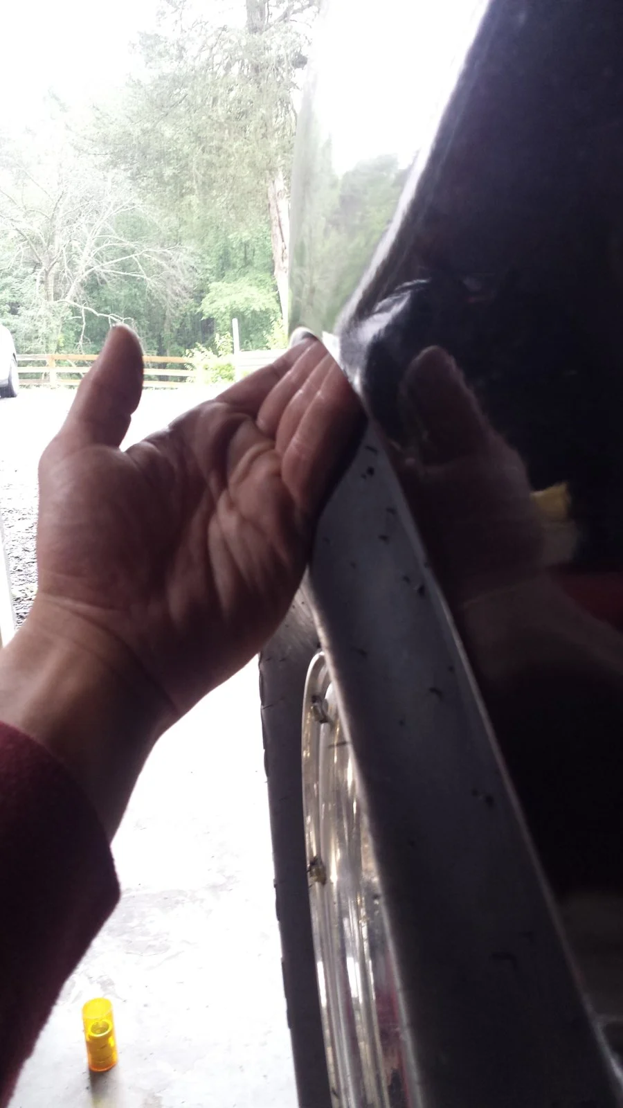

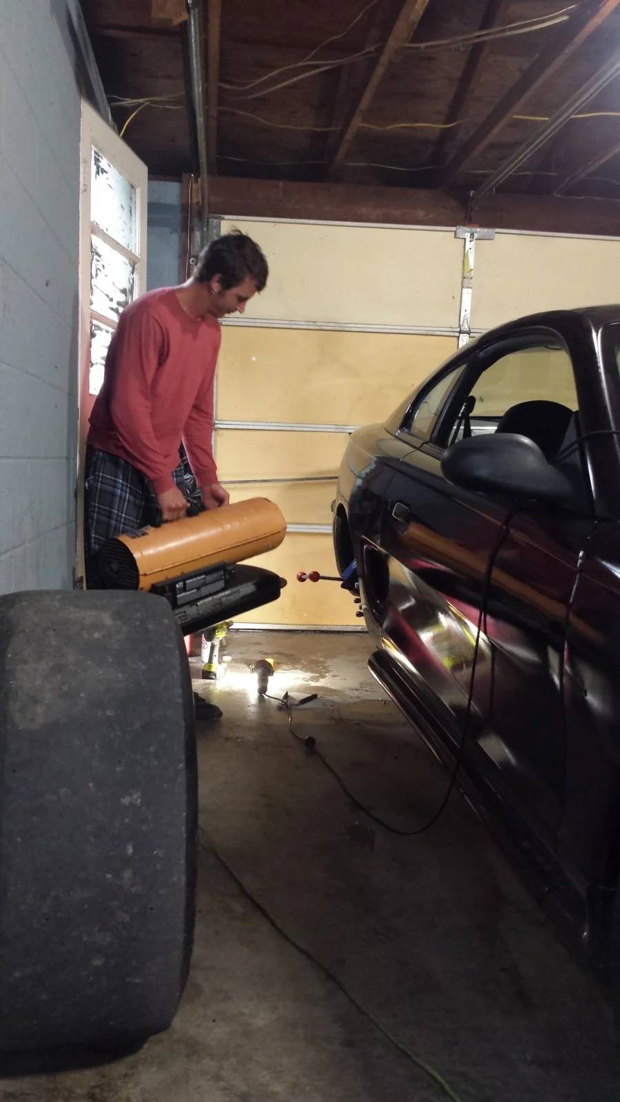

Got the drag set up on. They don't fit, so I'll be rolling the fenders some more tonight. managed to get the spring back in the diff. Used hose clamps.
Any way here is a pic. With the drag tires on. And I'll add some fender rolling pic's later.
Reactions: General karthief
And now they fit. Now if it could not rain next weekend that would be great
