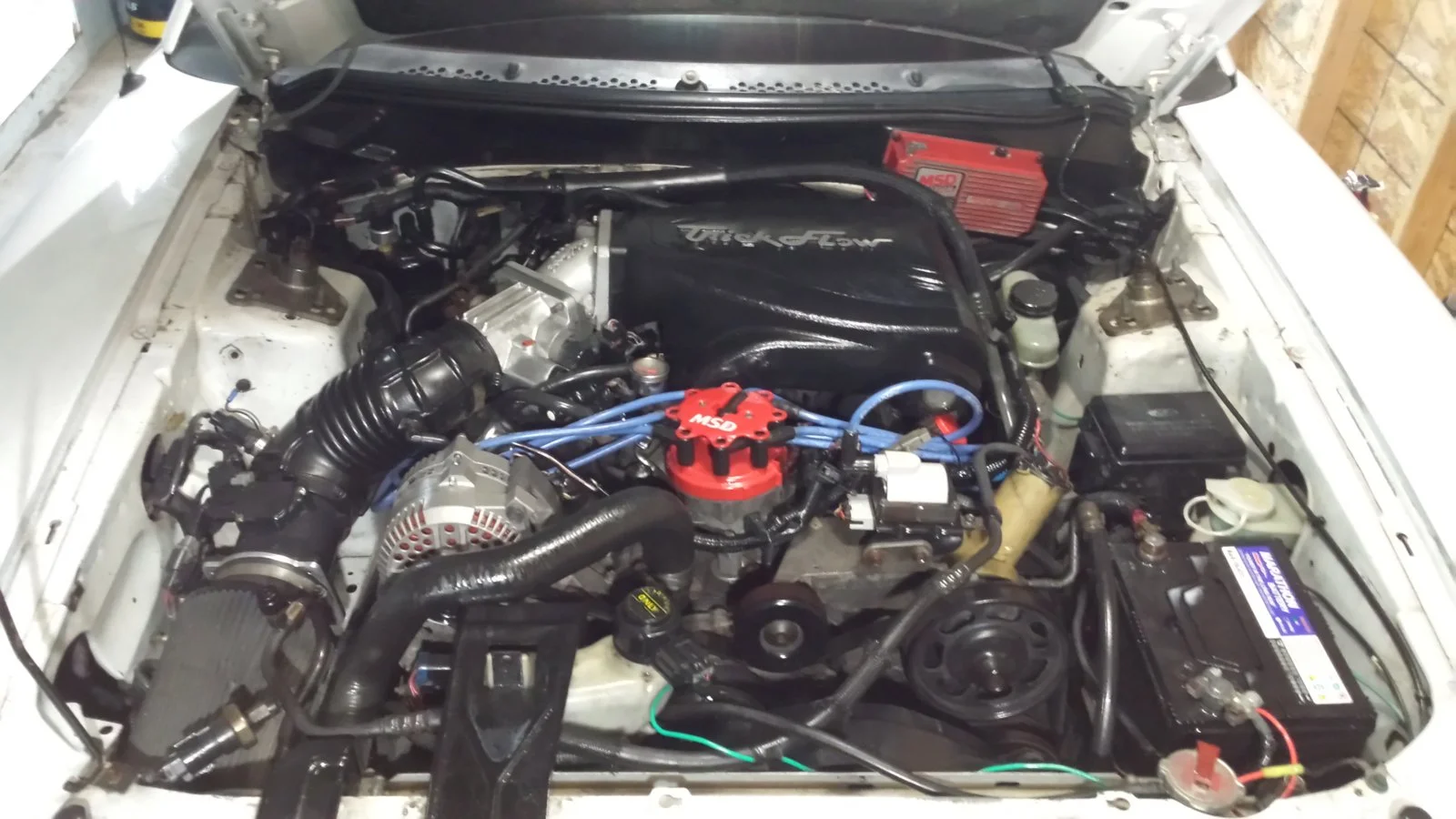

Yeah, and honestly with a stock intake (judging by the pics in the first page of the thread), and the stock cam, I'd be really surprised if you're making power beyond 5500 anyways. Your combination with those upgraded heads might have some decent lungs, but they're breathing through a straw. I'd recommend playing with the shift points on your next outing. Try shifting at 5500 and see if you lose anything. I'll bet that you won't. You might even pick something up. Then, try 5,000. If I'm right, then set your limiter to 5,700.

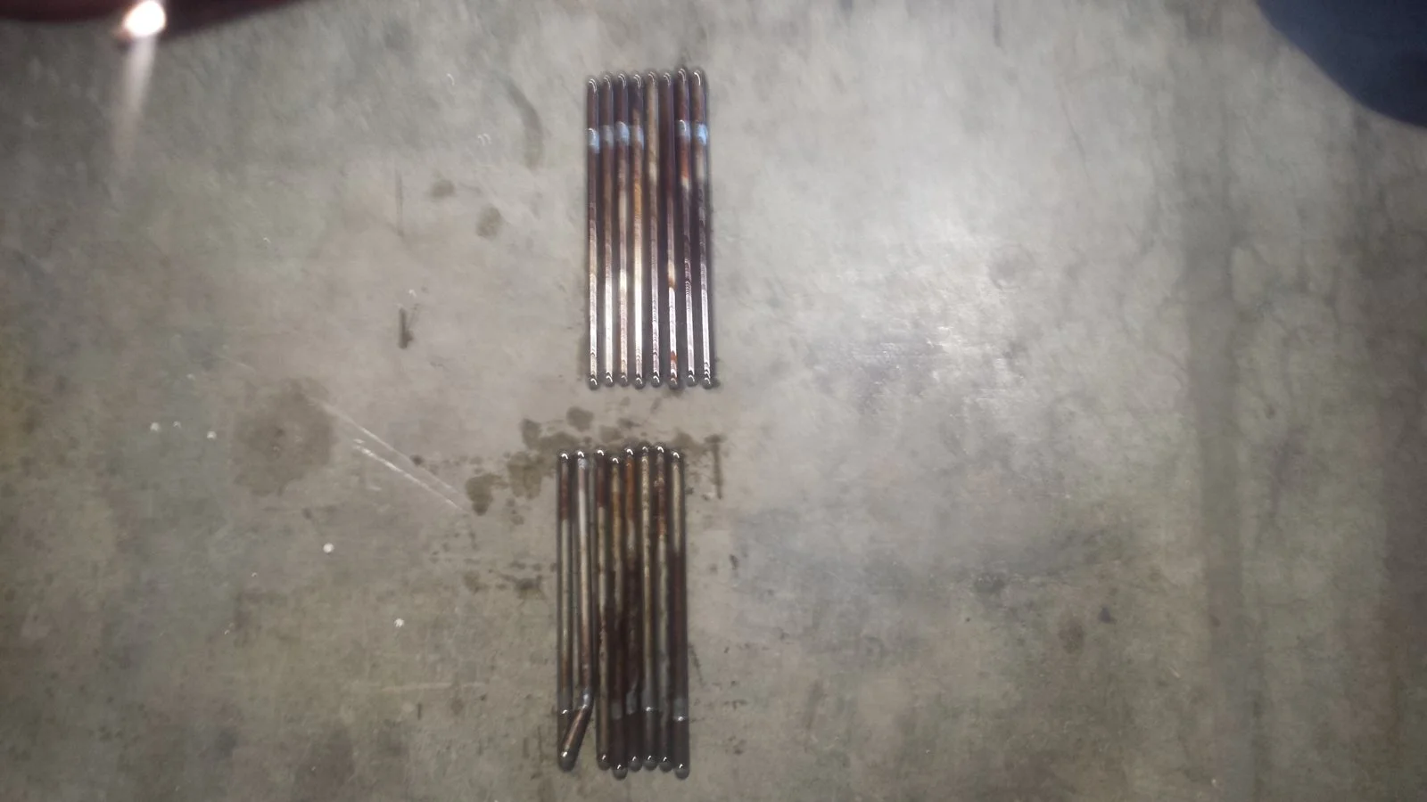

+1 @RangerJoe Heavier valves, and a bigger rocker ratio + boost + RPM + unknown springs. Not good.
I paid close attention to the spring and they areally definitely stronger dual springs. But,The chromoly pushrods are definitely heavier,and the 1.7 rockers are moving big heavy valves further. Although it's extremely apparent the problem was mere stupidity but I'll be taking some rpm out of the limiter jic.

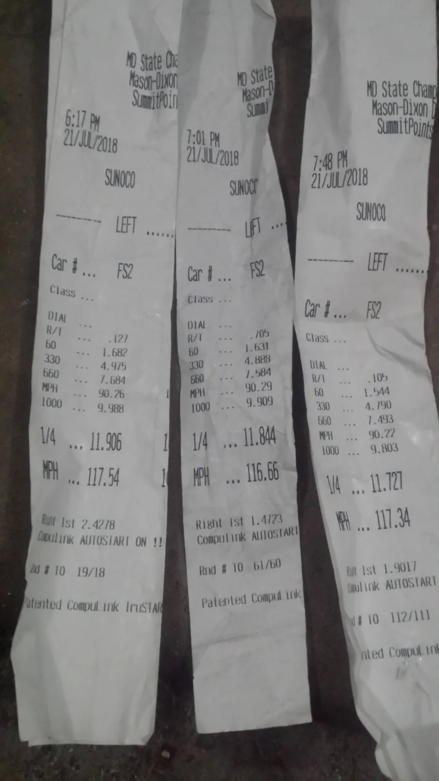

Well today was a good day!
First pass - 11.9 spun the tires for the first time, and it actually got a little interesting in seconds gear. Started with 15psi and that was definitely too much.
Second pass - 11.8 side note i was next to an 11 second car and being concerned with an interesting ride I sat at the tree for a second to make sure I had a full track and no one to wreck. 13psi hooked up, and I short shifted 5300~ although I think it pulls harder through the gear, I think waiting for the turbo to come back on line negates it.(lift shifting)
3rd pass - 11.7 most importantly my first 1.5 60! That felt good! Hoping I picked up a tire!
I called it a day because 3 back to back good passes and all the cool cars to watch I figured I'll break the car a different day. Also got an auto cross coming up soon.

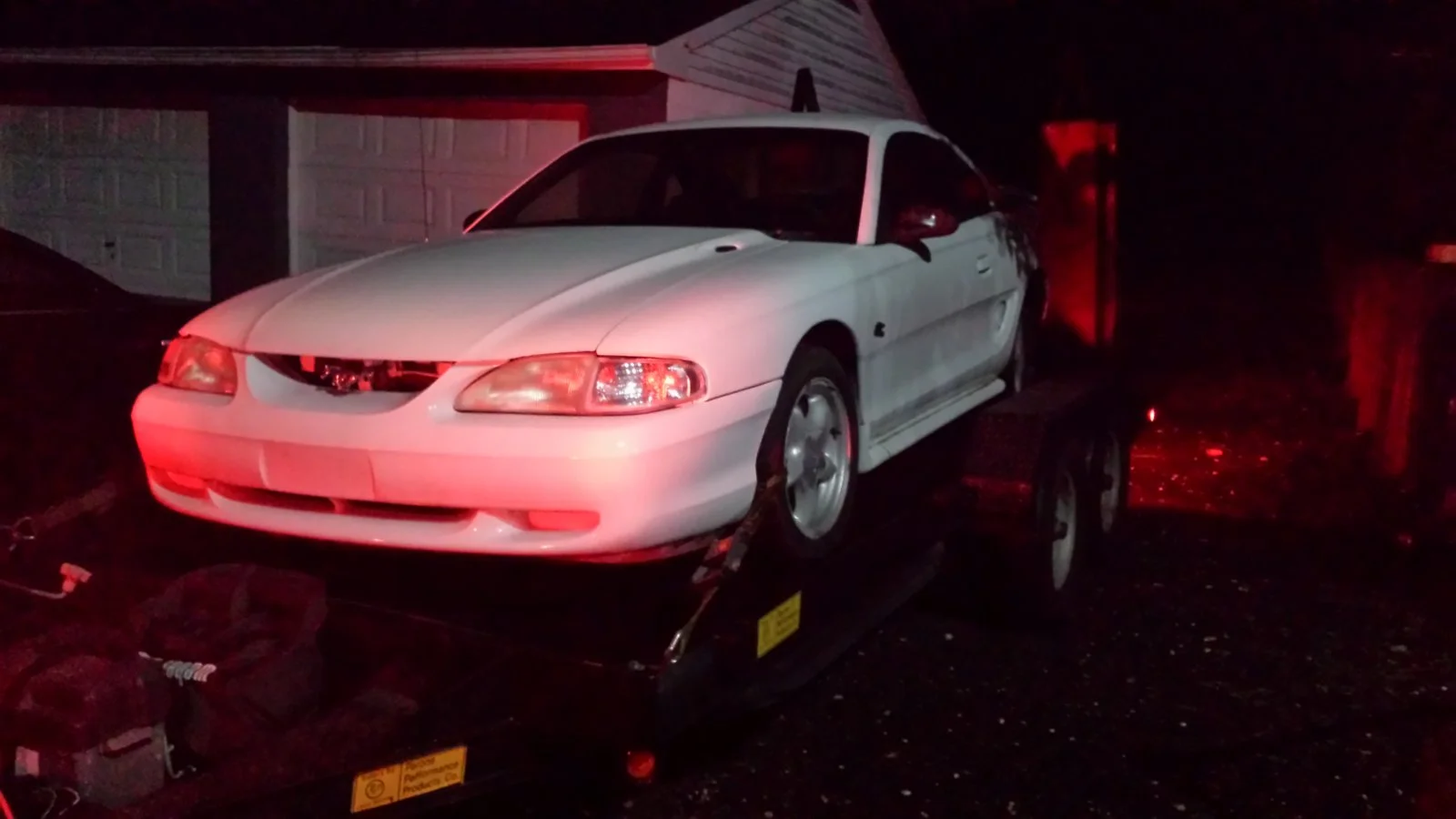

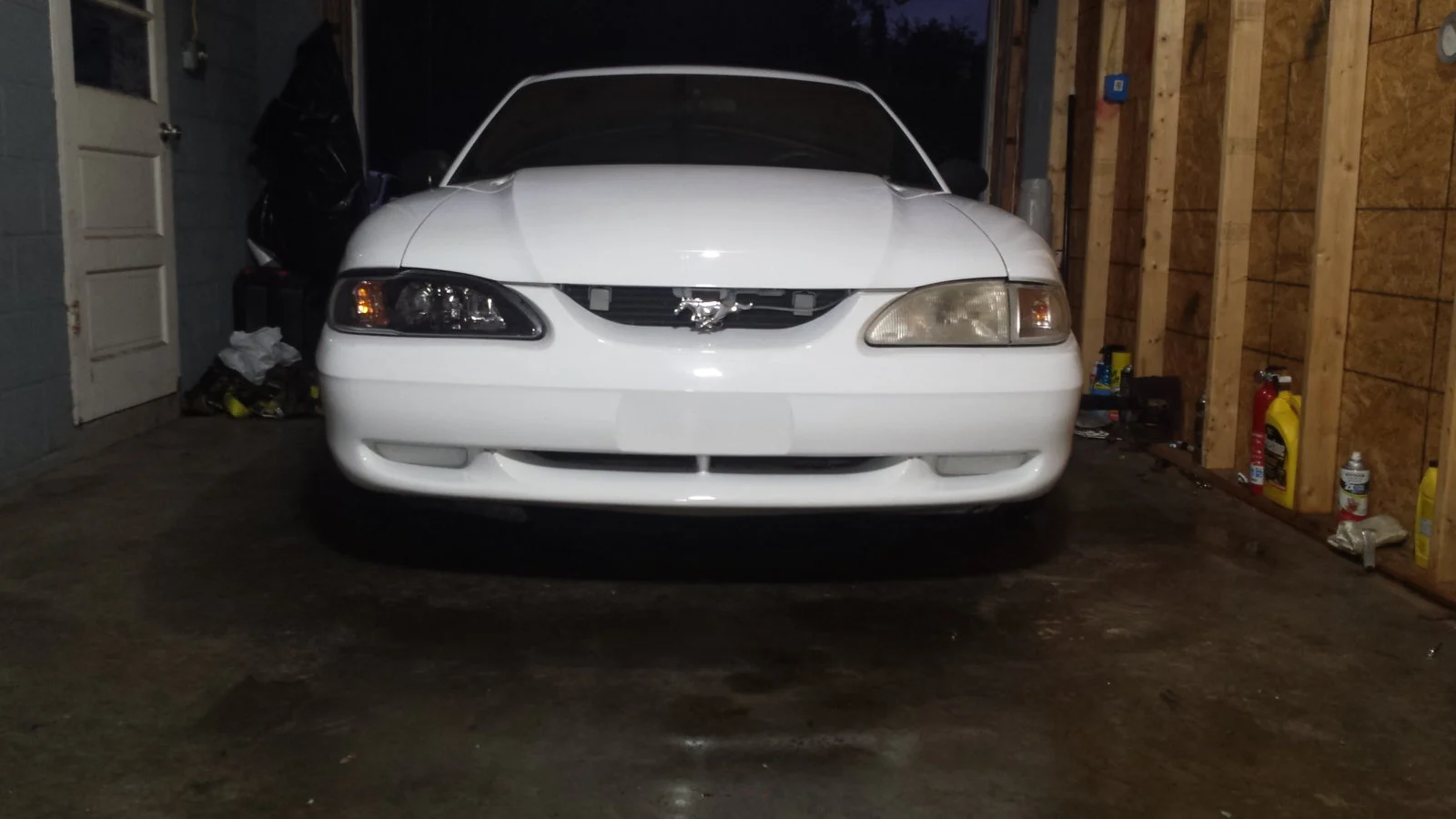

Well she is gone. I was about to put her away and embark on an engine build and roll cage over the winter. As I have always done in the past before spending money I know I'll never get back. I listed it for sale at a pipe dream of 7900$. Long story short made a deal at 7k $ delivered.
With the instant regret setting in 2 days later I found a white 95 gt with some bolt on's listed at 3500$. I asked if showing up with 2800 would be a waste of time, and he said no. (I don't normally bargain on the phone but the car was two hours away)
So I show up the car barely runs, the paint is covered in 2 years of moss and filth. Body looks great, chassis looks incredible, interior is showroom perfect (80k real miles)and a "few bolt on's" include studed trick flow heads, big cam, trick flow everything from heads to air cleaner, injectors fuel rails regulator, stage 2 clutch, built trans, gears, Ford racing springs, Caster camber plates, full exhaust with long tubes, you get the idea by now..
So I believe being fair and honest made this an even bigger deal! it's difficult to explain the situation in text but I'll try.
Me: "man it hardly runs and I got my work cut out for me but I got to be honest everything looks great so I got 2800 let's load her up". *hand shake*
Seller: " oh by the way I got these 4 perfect black cobra R knock off's wrapped in brand new 275 rubber that come with the car if you're interested"?
I think the seller knew what he was doing and would have sold the wheels separate if I beat him up on the price.

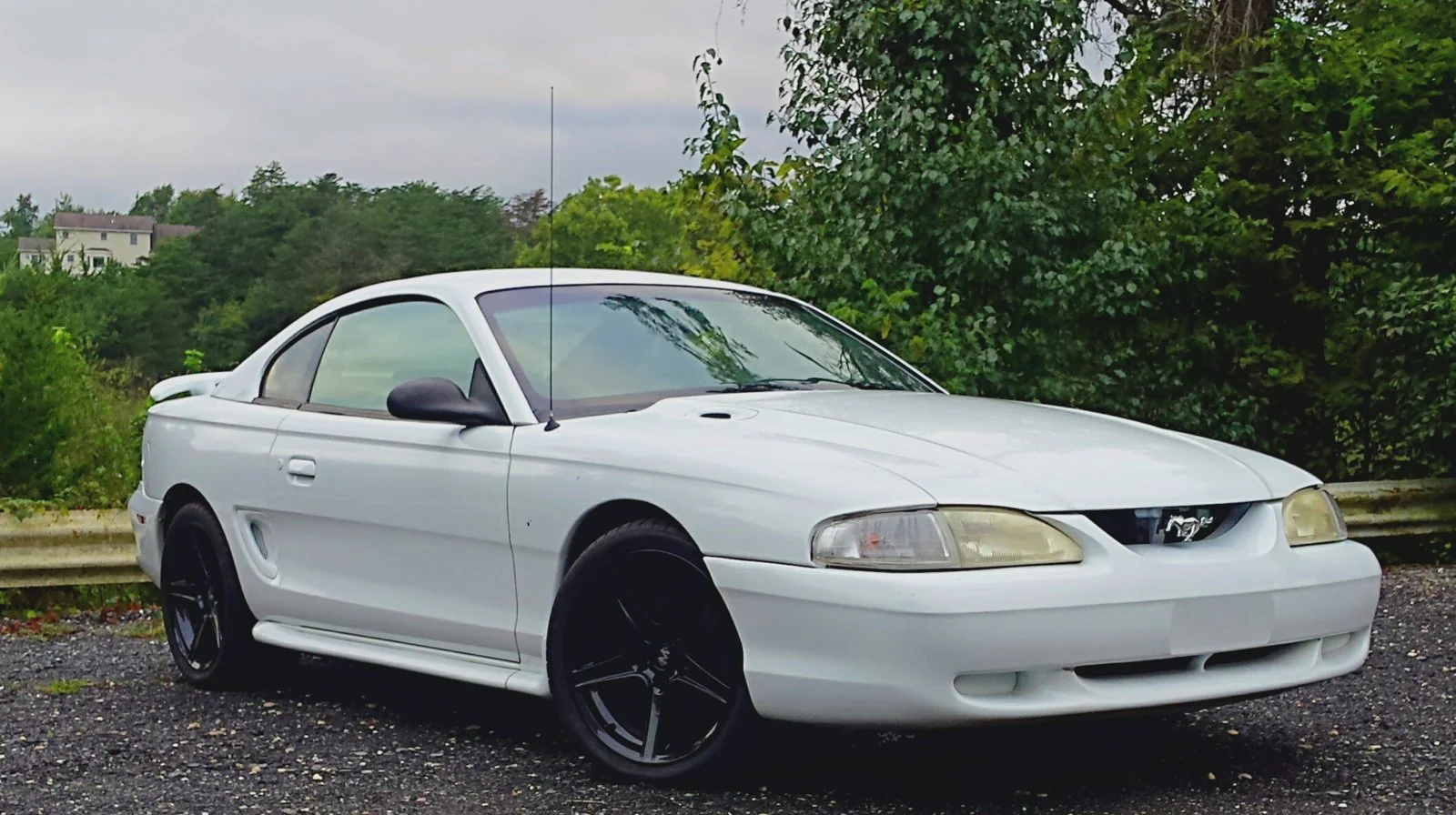

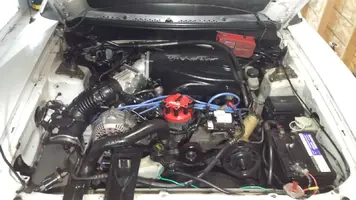

Anyway I'll start a new thread for the car but for now here are some pics of the progress
Ps: coil, power steering tank o ring, and repair a broken pin in the maf harness is all it took to get the car mechanically sound.
