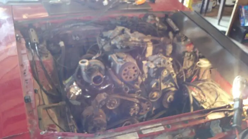

Getting closer!
Sent from my DROID RAZR using Tapatalk 2

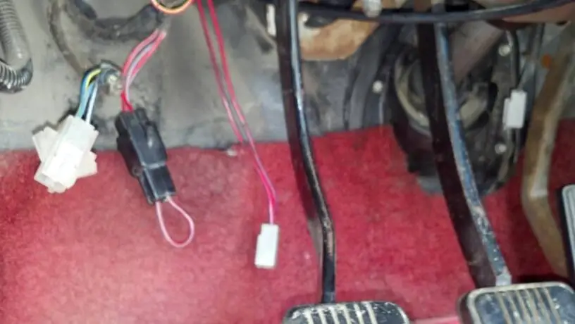

I have run into a snag putting in the clutch petals. I'm running the '88 tc hydraulic clutch set up. Can't tell where all the wires go. The two plugs on the left are from the car, the two on the right are from the tc pedals.

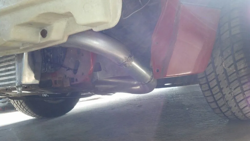

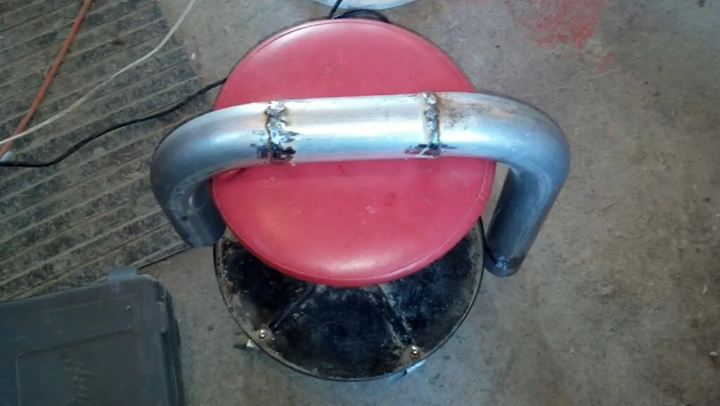

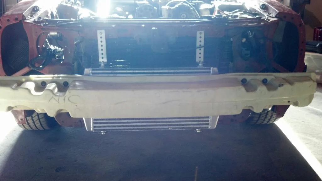

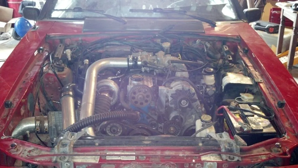

Got my Stinger FMIC installed. Had to lengthen one of the pipes a bit. Fits like a glove now.
