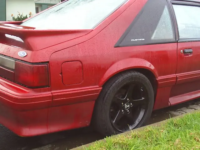

i used sn95 axles with the whole sn95 rear disc setup..... it works for me because im using 8in. wheels w/255's
