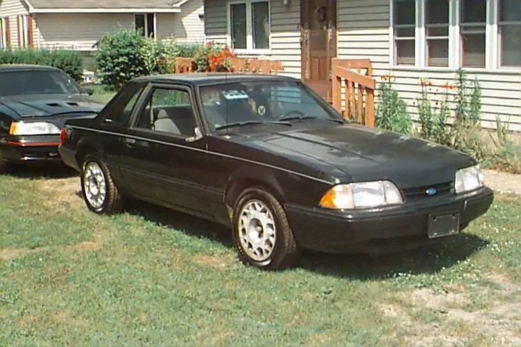

Right now I only have the stock 7.5" rear in the car but I will be putting in a 8.8" TC rear that is in the garage right now. If you want more pics than this one go to http://community.webshots.com/user/urbanredneck and check out most of the pics I took of my swap. I don't have a good pic of the wheels with the centercaps on on the car though.

thanks for all the responses guys. i'm excited to get these wheels on. the 14x5 wheels just arent doing it anymore. i think it will make a big difference in handling. especially when i get my GT front sway and addco rear sway, with the appropriate energy suspension bushings and endlinks installed. i'm supposedly getting a free set of hand-me-down cooper cobras in 245/55, from a fellow supercouper.
thanks again, i think they'll look terrific on the notch.
-matt
