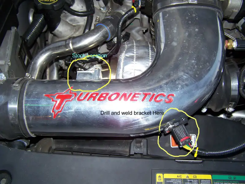

heya guys, here is a pic of what i had to do to get the MAF working correctly. i blockedoff the stock location, and moved the maf to the shown spot, added a MAFia, dyno tuned it, now it runs perfect!! and a bonus is its closer to the throttle body
That's odd that this location corrected your problems, in almost every boost applicable car that has problems, having the maf near or in a bend requires it be on the small radius, opposite of what is working for you. Optimal is always a straight section and if close to a bend, also on the inside radius side, which again was not working for you.. very strange
