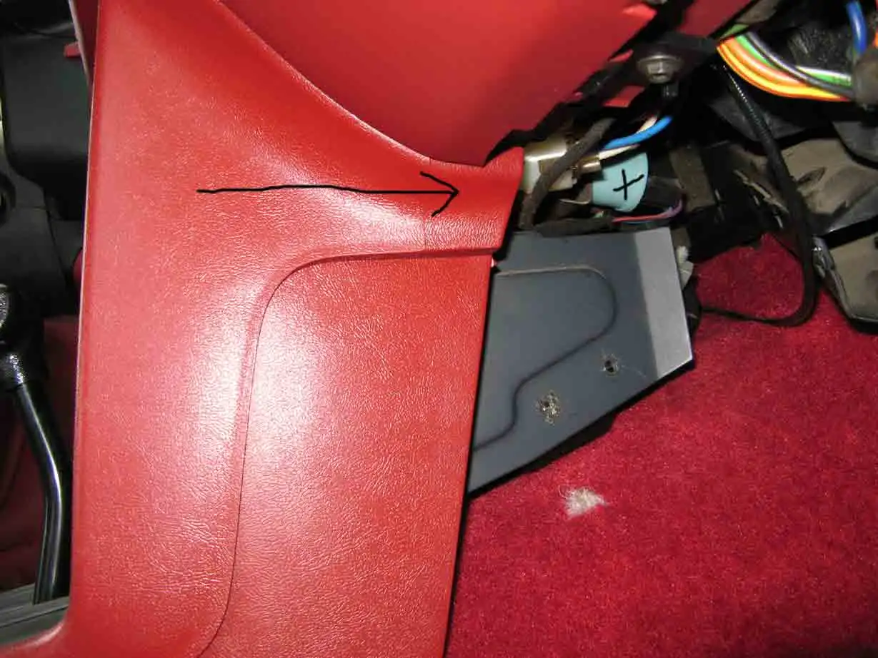

It is behind and above the radio, on the right.
It is unplugged, because I unplugged it to change it. After I unplugged it, I took a picture to share. I replaced with an electronic flasher. It cost more, but is more consistent than the cheap oem flasher.

Go to the parts store and get the electronic flasher, usually part number EL-12 IIRC, and your blinkers will flash like they should. You can use the same flasher for the turn signal (the part in the dash) and the flashers(the one on the back of the fuse panel).
I believe the relay was moved behind the radio/glovebox starting in '90 with the intro of the airbag.
I've seen the TS relay in a handful of locations in the aero fox cars - I'm not sure if there was that much thought about where to put it.
