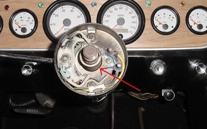

Remove the steering wheel and the signal switch lever, the spring and then the three screws around this plate.
The wires must be cut or removed from the plug coming out of the column under the dash and then the switch will pull out with the wires.
