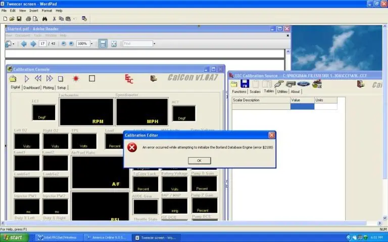

I just tried out my new Tweecer r/t and when I went to click on any of the tabs or functions this error came up. "An error occurred while attempting to initialize the Borland Database Engine (Error $2108)" here's a pic of it. Any help would be awesome. I'm assuming I need to do something with the BDE? Thanks for any help

Are you loading the current version of the software?
The screen shot shows CalCon v1.0A7,
I thought the current version was 'B' something...

That must be why then, I had downloaded everything off the Tweecer site, but that B version is new to me, they must have just put it up since I didn't see it up there yesterday? I'll update it to the new version and go from there, thanks for the Help :nice:
