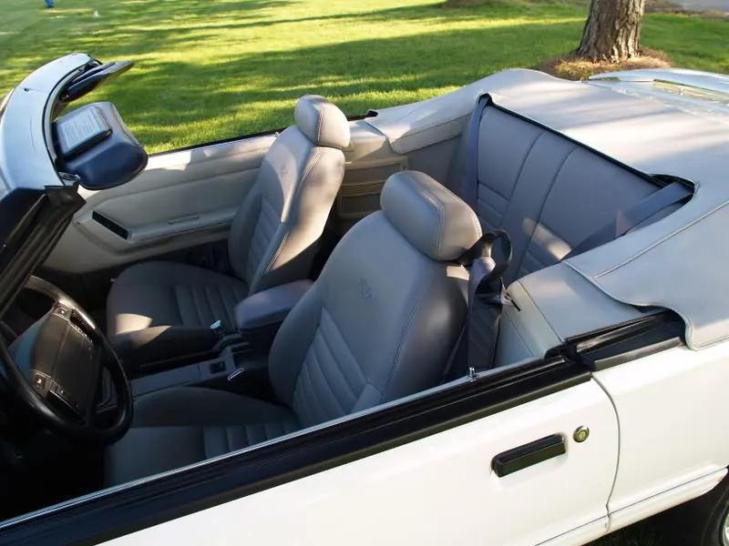

I have a triple white 93 convertible that I've had for years. When the white leather got too shabby to keep looking good, I shopped around for a while for new ones, looked at the eBay crap, thought about getting them recovered and then came across a set of gray 500-mile 03 GT seats for $350. Since most of the rest of the interior is gray, I decided to go for it. I had the rear recovered to match.
