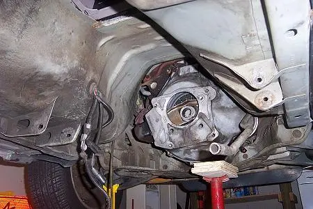

I don't know if this helps, but here is a picture of a T5 bellhousing installed with the transmission in.

I would think that the one with the slightly wider holes are for the SROD/3550, but the part # doesn't make sense. I will go out and measure mine if you want. I have two in the garage.
